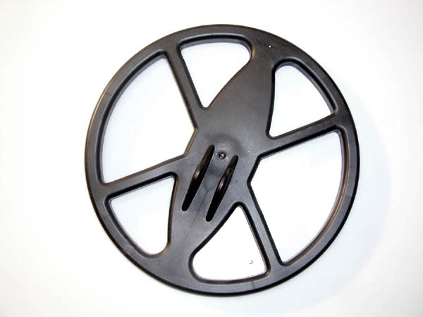

      • DD27.5 sm
        Hi all
        Anyone searching for a casing(corpus) diam. 27.5sm for MD?
        Sorry for bad English !
        • DD27,5sm
          DD27.5sm........ABS.

                  What is the distance between the lugs on the coil shell where the stem is attached?
                  • DD27.5sm
                    Hi, distance is 20mm(standart).weight 160gr. Please, PM for more questions.
