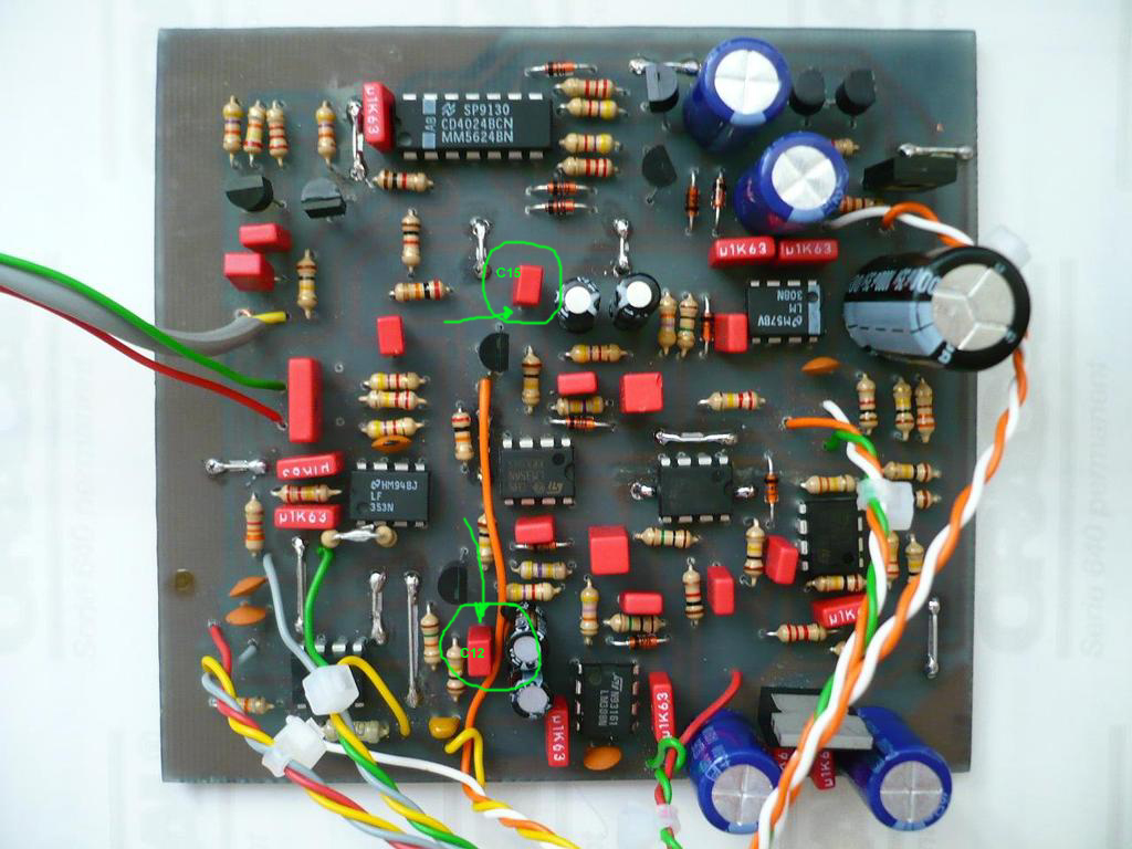

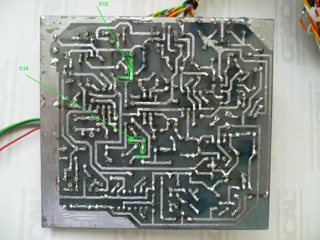

                    Can you measure the voltages on both .22uF capacitors C12 and C15 that are connected to JFet source pins? I think I have identified the voltage points in your attached photos.
                    These voltages should be positive. If they are negative, it probably means your coil is nulled improperly, and maybe someone can help with some suggestions.

                    • Of course simonbaker .
                      The voltage is positive – 75 mV for C12 and 40 mV for C15.
                      The frequency, if my multymeter measures properly is 13.6 kHz. Unfortunately I can not measure the inductance with my multymeter.
                      Resistance on RX is 19.3 ohms and for TX is 17.7 ohms.
