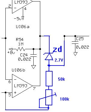

      Of course , who being you , Patient? ... you worry own care and stop spit at other people.
        Orientation of magma's zener is OK. Regulary diode act as zener in oposite direction.
        strangely hear similar things from specialist... could you to draw how this circuit part works via signals' levels on time axis? please.

            Hi, I am not discuss about schematics in total or partial module funktioning. If you are interested in signals and its time stamps you can use one of electronic circuit simulator. I am not in mood to do such things this time.
            But if first green diode orientation is correct, then green zener is corect and pinki zener is unproper oriented. In case of use zener of 2,7V I can only suggest this solution (blue draving) for 100k resistor (of course R 50k can be 47k or something near this value) :
            • WM6...i think KT315 is right. Usuall drop at 1N4148 is 0.6-0.7V. So...to replace zener 2V7 there it is quite logicall to use 4x1N4148 in reverse direction (KT315 suggested 2 diodes??). But! This only, if there is any need to limit voltage, of course. Personally..i dont see a reason to limit voltage there. It is faint signal anyway. 1M instead 470K and 1M3 instead 1M in those stages really do rise level of amplification, but not maintaining proper linearity. Therefore suggested mod is a bit tricky and in most of cases it will result with instabillity on real soil. Further... treshold feature added there can help a bit to "clean" and limit audio behavior, but from my previous experiences i seriouslly have doubts that it will be enough to solve known TGSL problems with audio.

              • Sure that 2x4148 is not equal 2V7 zener. As I understand KT315 is not suggesting of 2x4148 use, but zener 2V7 in reverse ("pinki") orientation and this is not proper. Probably 2x4148 use is from original TGS schematic or some mod I dont know. So far I never dealt with this schematic.

                    I say - your schematic is WORKING TOO. but why you use Zener if Zener is WORKING as the equivalent of the diode in your schematic? GET BACK TO LEGENDARY CLASSIC-TESORO SCHEMATICS and do not draw wheeze.

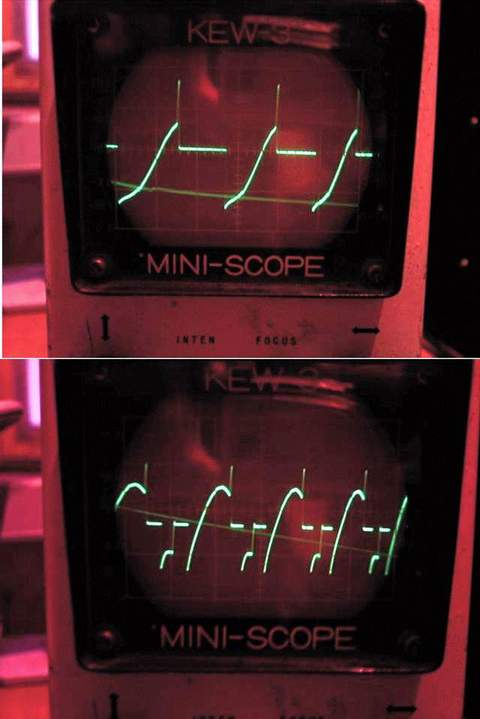

                      I want check BF245c gate but i dont have idea about singal on gate.
                      can it be the signal ?
                      Signal at gates...
                        simonbaker, could you to simulate up-dated one?

                            • All metal signal
                              Can anyone explain the shape of the All Metal disc signal for the TGS? It is not square wave, more like triangle wave (square wave integrated by capacitor).
                              I notice that JFet capacitance is more important than 15 pF (C11). If disconnect C11, it is still like triangle wave.
                              Why did Tesoro want this? Would square wave work as well?
                              -SB
                              PS - I checked to make sure JFet not forward biased - voltage is positive at source pin (if nulled signal is chosen appropriately).
