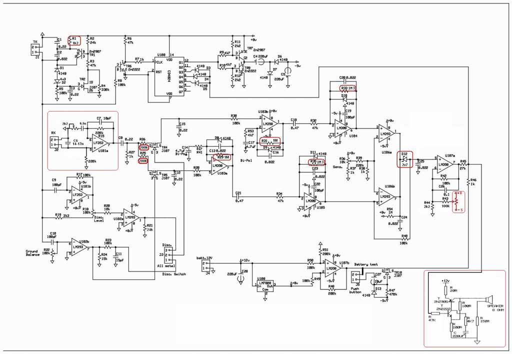

          • Modification
            This is mine finally version. Work very well , one silver denar detect at 30 cm.
            Best regards

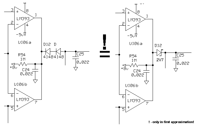

            • Magma, Zener D12 would be inverted in your schematic. are you agree?

                  I have done so on its detector. The Range of the regulation to sensitivity more.
                  But earlier were a spurious signals, which I could not take away.
                  If enlarge R44, maximum sensitivity will less.
                    D12 is so set in mine diagram and mine detector.

                      • Originally posted by Magma View Post
                        brrrrr....
                        then you could be return to 1N4148. here is not deep sense to put Zener vice diode. your Zener is working as ORDINARY DIODE you get big level drop for following op-amp, friend... the sound will crazy...
                        • Zener there!? It is copied from White's Classsic. Also on Caesar too (serbian "most wanted"). Also those 1M3 (1M2) resistors. Complete nonsence! To omit Sensitivity there is also huge nonsence! That detector will run unstabille producing lot of falses on soil. Maybe is "deep" in air, but 30cm on denar is not so "deep" at all. This "mod" is just made to confuse more and presents complete nonsence.
                            Orientation of magma's zener is OK. Regulary diode act as zener in oposite direction.
