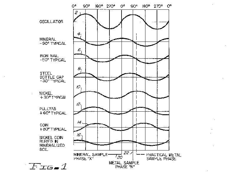

                      I noticed some stranges on my original Tesoro-coil (8x9'' spider) but cannot understand when you say that all targets give left shifts, cause also Gifford's patents report devices rely strictly on phase shift detected at RX coil signal.
                      In picture I captured a part of patent reporting phase shifts for various metals and mineral soil.
                      How could be possible that targets produce just left shifting of RX waveform and detectors works just considering amplitude of RX signal there ??? Seems impossible to me the things go that way.
                      Let me explain... I know the amplitude shift happens and are present on RX signal at preamp out BUT on disc channel ,after demodulator, this is due to positive or negative phase shift the RX signal is subject to cause of a target.
                      The demodulator idea rely on this stuff: if you can disc just considering the rise or fall of amplitude signal at preamp out, why the need of a sync demodulator there ?
                      Consider the dashed line in the picture: there is the sample for disc channel... as you can see sampling there "good" targets (non-ferrous) will give a rise in amplitude and "bad" (ferrous) like iron nail will give zero and mineral soil negative amplitude shift. But this just cause of RX signal phase shift.
                      Am I wrong on this ? Maybe I miss something or made some mistake...

                      • Hi,
                        I've tested again my Tesoro coil... and got results like you wrote about (now I remember I saw this stuff during bandidoII cloning but then forgot about).
                        The RX signal shift always to the left, no matter of target composition.
                        The question is now... what's the purpose of the diagram of above when in their coils the phase shift is always one way no matter of target?
                        I understand even less now!
                        Maybe the reference point is somewhere else than at zero crossing of TX ???

                          Hi Max,
                          I am pleased that you have independently confirmed that all the phase-shifts are to the left. Otherwise this was going to get complicated to explain.
                          As far as the GEB channel is concerned, only metal targets cause a phase-shift. As these shifts are always to the left, a positive signal is generated that causes an audible beep in the headphones. That's why sampling at the zero-crossing is necessary. The ground (if not mineralized) only causes a change in amplitude, but no phase-shift. Hence there is no audible beep when the coil is lowered to the ground.
                          For the DISC channel, the discrimination relies soley on amplitude changes - increase for non-ferrous and decrease for ferrous.
                          The confusing thing about the diagram in the Gifford patent is that the phase readings are taken relative to the TX signal, and this is why you end up with positive and negative phase values.

                            HI Max
                            "The RX signal shift always to the left, no matter of target composition."
                            No, my test is all metal the RX signal shift always to the right,but the ferrite is shift to the left.
                            • Originally posted by zzy View Post
                              HI Max
                              I'm totally sure of that. I checked yesterday with my original tesoro coil (9x8'' )and shift happens to the left with metals.
                              I tested many stuff, iron, copper, silver, gold, brass, bronze... etc always RX signal shift to the left side.
                              I think you have to reverse RX coil leads to gain good disc and have same kind of shift there.
