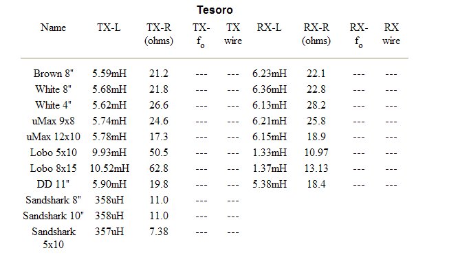

    SimonBaker , I will look for the dimenension's soon . And of course there are "Standard's" or Specifications to follow , PCB dimensions in relation to Integrated circuit size , so the holes line up correctly and the "through-hole" holes are drilled to proper size. "Through-Hole-Holes" ??.....Seriously , It is in the software , that is why we take it for granted , and do not really worry about it. I am just so very happy that 95% of all the projects on the Geotech Forum are "Through Hole Projects" and not "SMT"-Surface Mount. But you know that is going to change someday .... maybe soon , when Multiple "Pic Chips" and "DSP" microprocessors are required for Pulse Induction with Discrimination , and when "Ground Imaging Devices " are DESIGNED and BUILT right here on this Geotech Forum !!!!! Look how we have advanced here in just a few years .......Thanks...........Eugene
    • Originally posted by amtech2005 View Post
      Hi Max , I read your response , Thank-You . Maybe at the Tesoro factory they just "Tightly wind 100 turns for the TX , measure the dc resistance and then "Tightly wind 110 turns for the RX , measure the dc resistance , Glue it , throw it on the truck , and someone "SCREAMS".... "SHIP-IT"......I know they have Factory Specifications , that are very strict +, - 1% maybe ???? Maybe not a Self-Resonance like you said , but definitely a milli-henry value that must be very strict. I am researching everything again on coils to learn all I can , and also to re-fresh my memory , because I plan to post the "Final Tesoro Golden Sabre Lite-1265". Search-Coil information Later !!!!........Eugene
      some are very strict... some instead are weak about inductance matching... I think depends on construction... if you always use about 100turns of same wire, same way it's very probable you'll get about same inductance.
      This doesn't mean you look for a particular inductance but that you end up with that value always cause you made all coils the same way.
      I think their major concern is nulling and phase shift, cause inductance value depends on how many turns they put in former, always same number.

      • Hi Max
        I presume that data about lobo's tx and rx are reversed, not sure of course.
        Bye Max
        • Originally posted by maxbiri View Post
          Hi Max
          Bye Max
          I think they are eaxct , instead.
          The table is from this page, I think all measures made by Carl years ago:
          http://geotech.thunting.com/cgi-bin/...oils/index.dat
          PS: Lobo's coils are different from TGS and BandidoII
          Kind regards,
          Max
          • Hi Max
            If data are correct i'm doing big mistake in my lobo project.
            At this point i need understanding better the coil for lobo before going on with project.
            Bye Max
