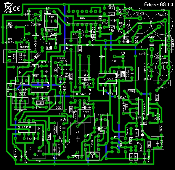

                              Hello Simonbaker, guys!
                              I was very busy lately but I finally few days ago I got the diploma (yup I'm in collage), so I do have some spare time to get back into the MDs.
                              Here is the 1.3 version of the GS board, redisigned board from ivconic which I called eclipse gs (EGS). I was going after smaller pcb size, component footprints which are more likely to be in shops, traces: bold and as short as it is possible , minimum jumpers, etc. Feel free to modify in the same spirit and post the updates here on the forum, this is beta board, not confirmed to be working. I plan to recheck it again these days for errors.
                              Size is 100 by 97 mm so it's is really small board. All ICs are compatible with the standard ones for GS, so use whichever you have.
                              Please if you find errors, please post them, I want to clean all erorrs.
                              • Hi
                                Pfffffffffffffffffffffffffffff.
                                Eclipse,
                                Dont get me wrong my friend but did you think that changing some elements according Ivconics advice and some places this makes GSL?
                                I dont think.
                                Only some peoles have helped here!
                                Max,Ivconic,.....some other friends also.
                                This is their work!
                                You cant rename it and clime that this is EGS!
                                See.
