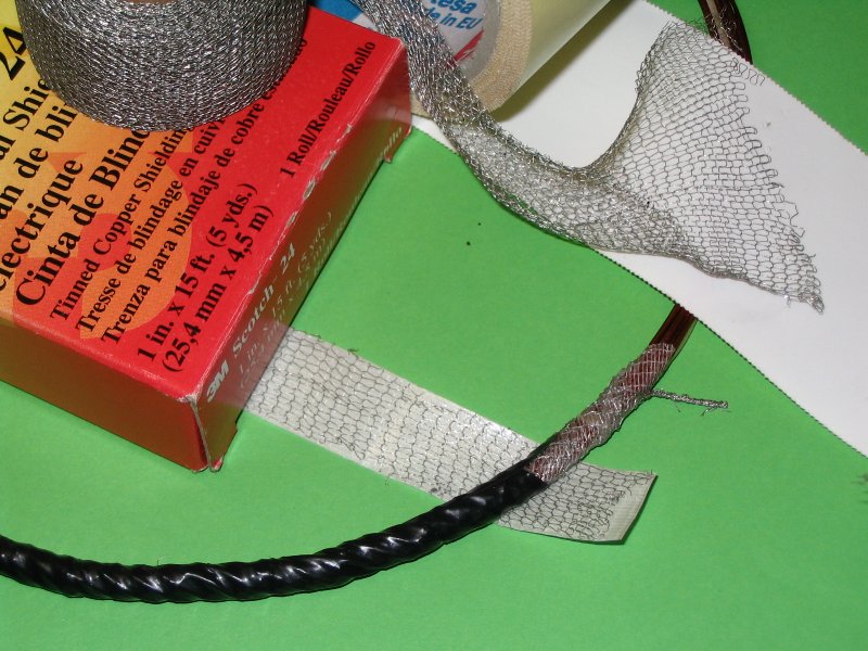

TESORO GOLDEN SABRE
  • A photo from the the screening tape.
    Regards.
    Ap
    • Originally posted by ApBerg View Post
      Regards.
      Ap
      Looks like good stuff, I was looking for something like that, thanks. Thanks also for relating your coil experience.
      Cheers,
      -SB

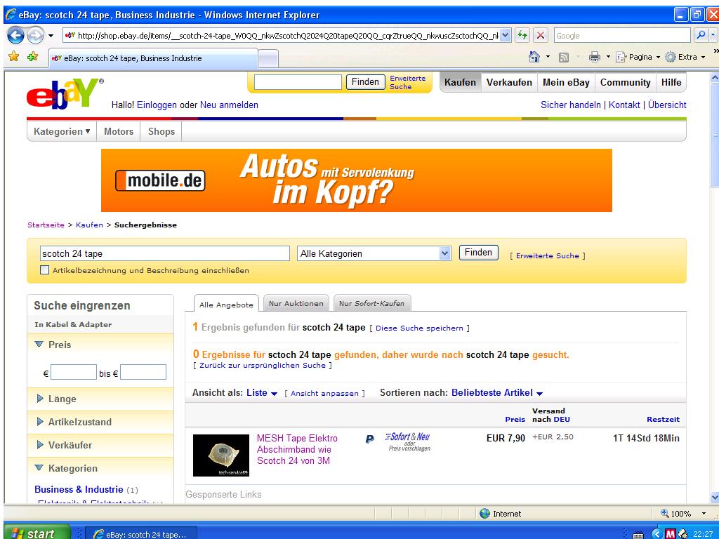

      • Screening tape
        Hello Simon.
        Do not know what country your from, but Ebay Germany has it now for sale.
        From Scotch it is expensive. The Ebay price is cheap..
        Regards.
        Ap
          Hello Simon.
          Regards.
          Ap
          Thanks for ref!
          -SB
