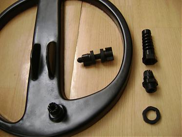

                      Below its not a GP, its GS and coil + some hw for the coil

                          good parts... I like them. Will be nice when all assembled.
                          Yup I like unbreakable and reiable stuff:
                          lower fiber rod + aluminimum shaft by Whites
                          Light weight aluminium box by Hammond
                          fiberglass coil 27sm also light and hard to break, alot more better than ABS plastics
                          I can tell soon if the "FnF comparator" is the LT1018
                          It's quite expensive stuff 5$ a piece so it should outperform the LM393,
                          about real advantages we can judge the permance results which I'll publish
                          as soon as I get everything OK.
