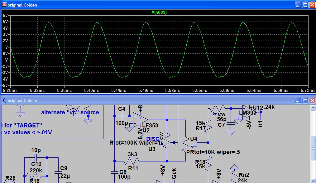

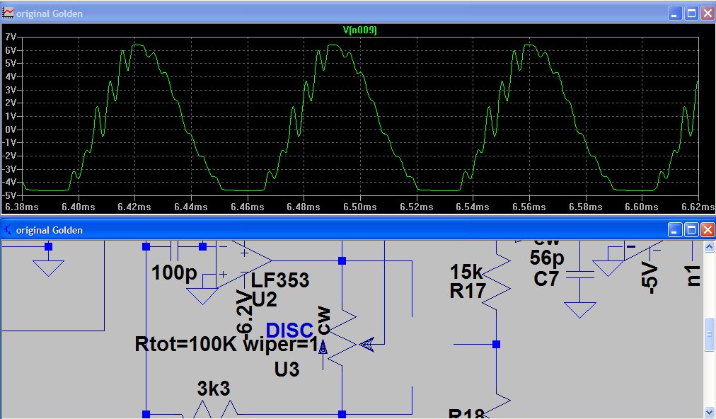

          have you used the 10K resistor parallel to 100K pot of disc... cause I've made same simulations of porkluvr and results are the same... look.
          I think you need it.
          1. is the output at pin1 of 353 with the 10K (notch pot)
          2. is the output at pin1 of 353 without the above pot...
          Seems clear...
          my problem is that I have the superimposed sinus WITH the notch pot there... that really puzzle me much.
          Kind regards,
          Max

              • Max i havent noticed any changes in behavior; with or without 10 K parallel to disc pot??? When it echoing beeps...it is doing that with and without 10k.
                Also al other functions remained the same with and without 10K...It is not big deal, i'll put it again...But havent seen any changes....better or worse???
                    I think that you probably have some other and bigger problem that mask the positive effects of having it.
                    That's why you cannot see advantages... or maybe is just simulator that make us crazy now...
                    I told you I have dumped oscillations even with notch pot there ! that's strange thing for real: also for me having it or not is the same !
                    Maybe the LF353 is inaccurate ? Who knows... ?
                    What I know is that simulator tell me that I need the damn pot but then I see dumped oscillations on the "real" scope.
                    I guess the LF353 model that LTspice uses for simulation is too good to be real !
