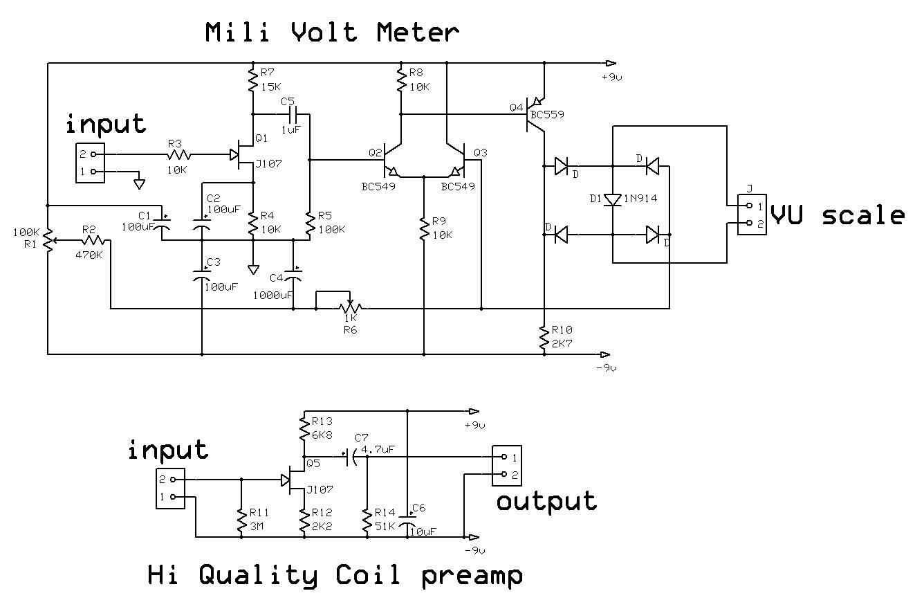

          Now, these are simple schematics; milivoltmeter i made and it is working very good. Although scale i do have is low resolution so error can occur. Need high resolution scale to run it just fine. Another, smaller schematic i took from some musician site. It is absolute miracle how this small,tiny preamp working FANTASTIC on guitar pickups!!!!? So those are coils too, arent they? I was thinking to experiment with this preamp a bit more....Seems nice to put it as RX front end...
          • I've just fixed the dodgey wiring in the plug of my 10" Tesoro concentric coil. The residual voltage is 4mVpp.
            So far I have measured:
            9x8 web coil = 13mVpp
            Laser 8" concentric = 100mVpp
            10" concentric = 4mVpp
            All of them work fine on my detector, but the one I prefer is the 9x9 web coil. It gives a crisper sound. Probably because of the 60mm receive coil.
