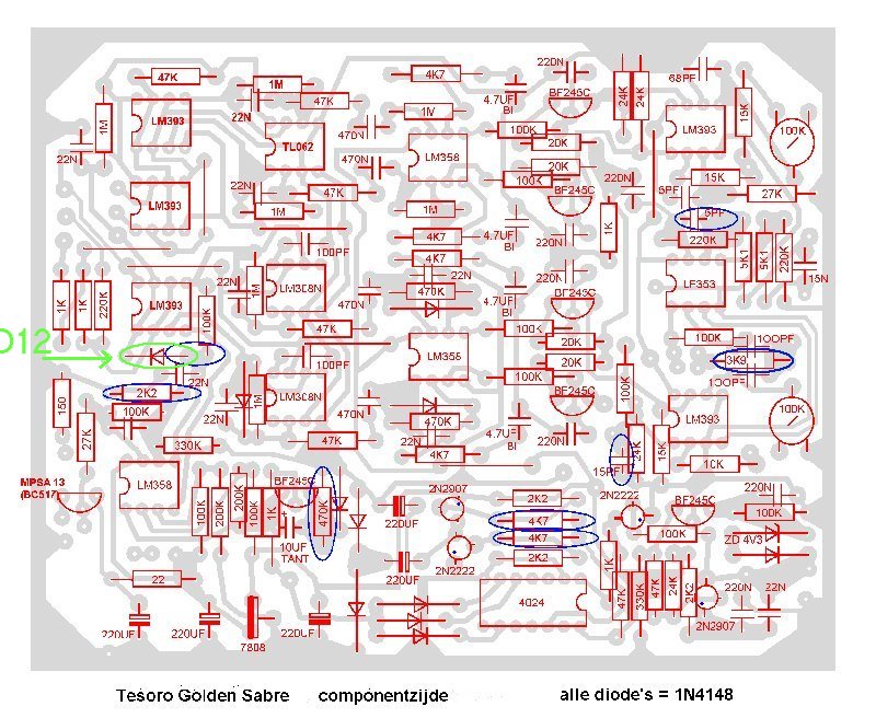

  • Hi Max, can you post where is R55 on PCB scketch, cause i m not shure what to do. I only know that i must conenect 1M resistor parallel to D12.
    Sorry for asking a to basic question.

      Here it is ... D12, you have to put resistor in parallel to it.
      There isn't any pad for it... you have to solder e.g. on downside of PCB, or on diode's leads on the upperside.
      Kind regards,
      Max

        • Thanks Max i ll do it and after that i ll post my expirence.
          Best regards
          Nelson

              • Hi,
                Max.
                Did you mean that I should solder 1M resistor to both ends of this diode?
                Or I should replace this that is next to it?
                  Max.
                  Just solder the resistor leads upon the existing diode's leads.

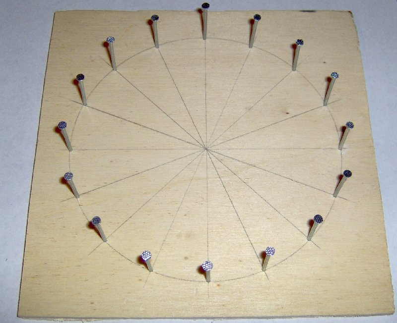

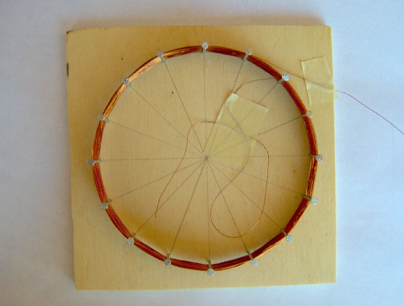

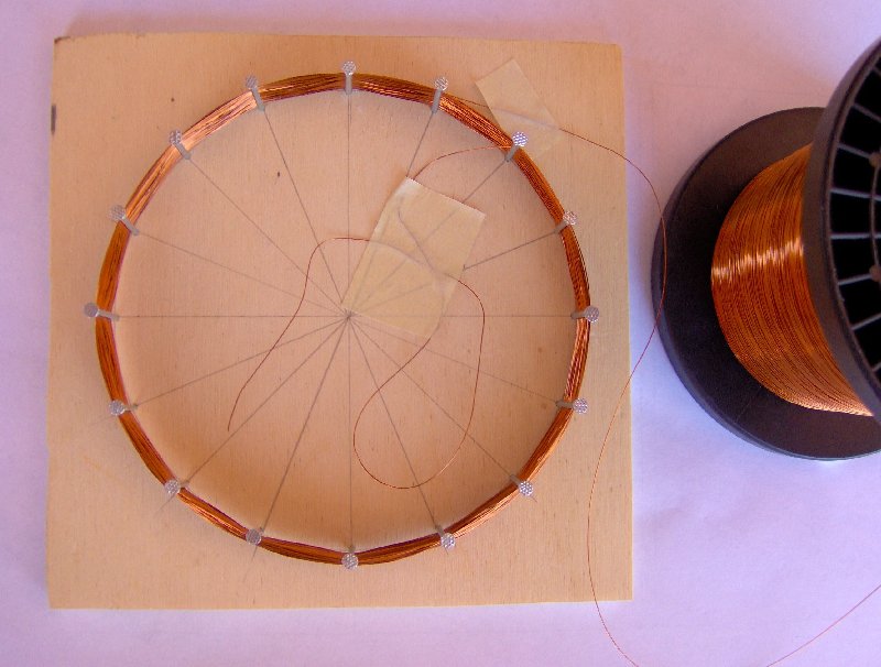

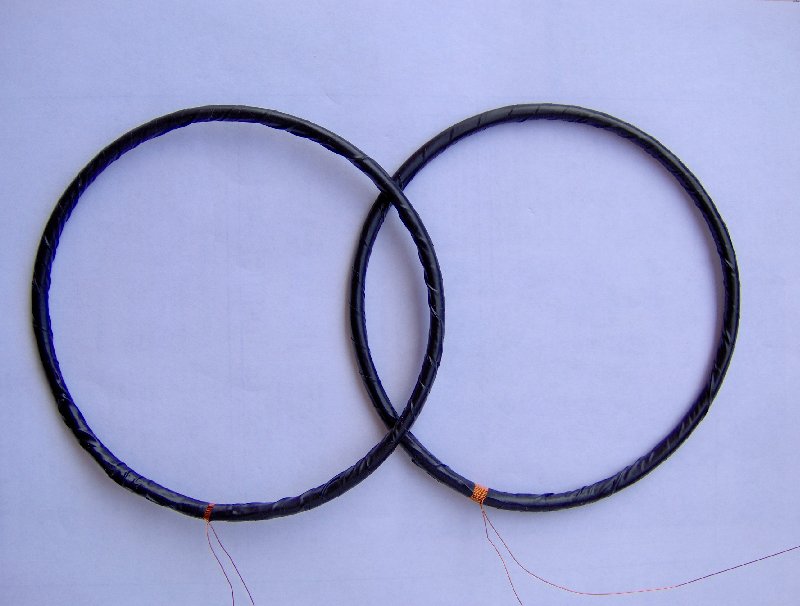

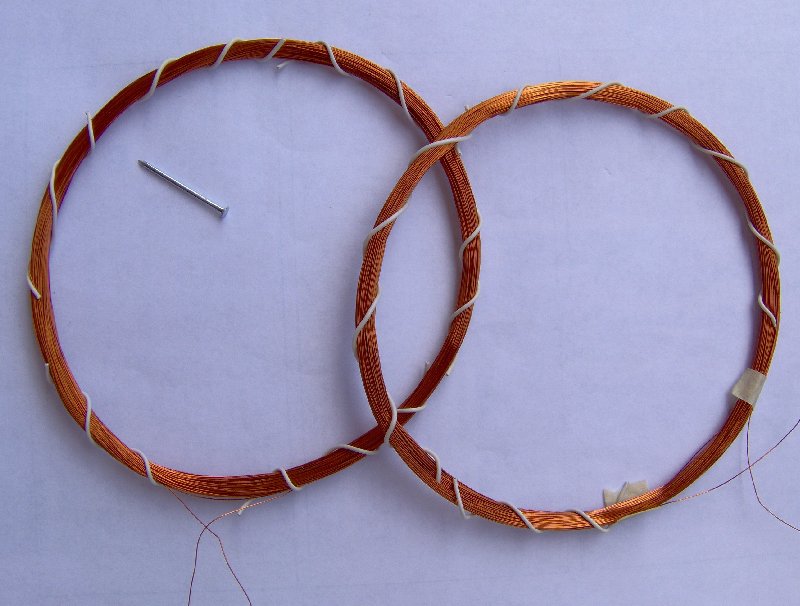

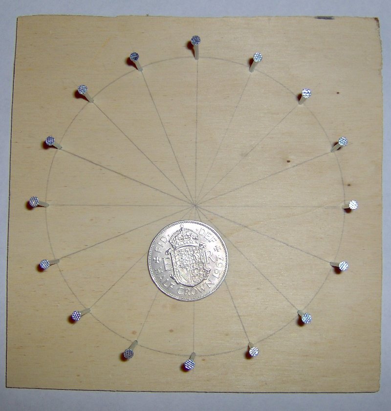

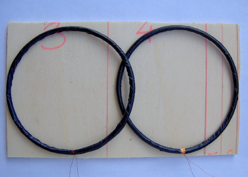

                        • my way to OO-coils ??? or just another bricolage work...
                          (please no questions... just look the dirty work )
                          • the garden work...
                            • and to speed up things you always need rubber-insulating-adesive-tape
                              • Then... lesson #1: time is not your friend.
                                Till that phase took just 33minutes and 17seconds total ! Say my digital/mixed watch.
                                Am I faster than someone else whose name start with G ???
                                At least an order of magnitude I think... or maybe 10 orders... and results aren't bad for an half hour work! That's the madness of all the story.
                                Not as my top of the range... that took 2 hours... about plus other time for container and sealing...of course, but time is money !
                                Isn't it ?
