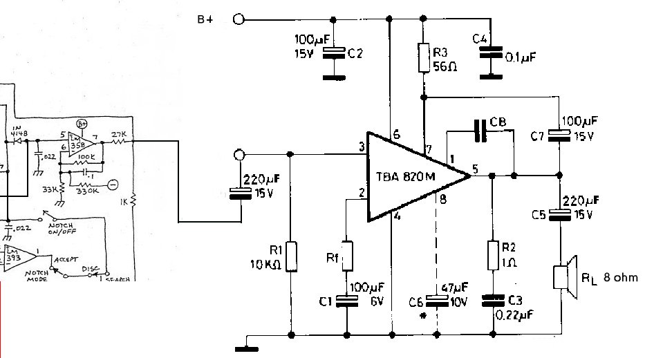

                    • Hi all,
                      this is my idea for a simple audio mod...
                      Rf sets the gain, with Rf=120ohm output power would be about 2 W
                      One could use an e.g. 1K pot to mod the output volume.
                      c8 = 1.5nF.
                      Quiescent current +4mA (no sound).
                      may work good ? who knows ?
                      Have to test.
                      Kind regards,
                      Max

                            Hi all,
                            c8 = 1.5nF.
                            Have to test.
                            Kind regards,
                            Max
                            Tested it... and seems not good. Best using it after the c517.
                            Audio is strong but I'm not satisfied of whole working.
