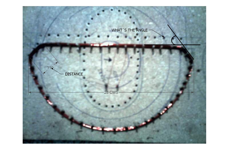

    • IVCONIC, HERE IS ONE OF YOUR PICTURES, WITH MY QUESTIONS ON IT.
      CAN YOU PLEASE SEND THE DIMENSIONS FOR ANGLE AND DISTANCES.
      THANKS AND REGARDS.
      NELSON

        Nelson, angle is 130 degrees, distance is 25mm...

          Nelson, pay attention; 130 degrees but down angle.....
          On photos you may see method of making DD coil, step by step. I used Al foil self adhesive tape, it is to wide so i had to cut narrow piece to suit easy wounding...
          Over one samll part of Al i wounded 15cm "naked" wire, tightly to make sure contact with Al..Later used scotch tape to constrain it pretty stiff. Over all there is plastic adhesive tape also wounded stiff....Also there is photo of small 1cm gap in F.Cage...

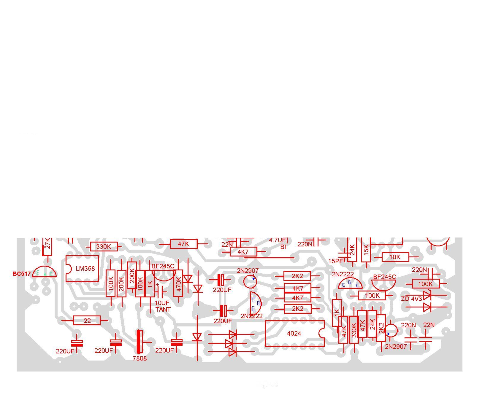

              • Hello,
                Nelson I have almost finish this too.Is there diferance in preformance with 353?
                Can you please tell me /or IVCONIC may be/ which transistor did you use MPSA13 or BC517?Are thy with same pin configurations?I have BC517 and on the picture I think is MPSA13?!And wondering how to fit?
                Also have pn2222 TO92 and also confused which pin to which hole?
                Please help!?!!?!??!

                  Tiktak, i am using MPSA13 or MPSA14 almost always. Once i used BC517....no difference.
                  You may use any of those mentioned....or copy whole audio output from other Tesoro's with
                  2N2222 and 2N2907...it will work anyway.
                  • Pins...
                    Forgot pin configurations!
                    MPSA13/14 E B C
                    BC517 C B E
                    regards!

                      • Hi
                        Thanks IVCONIC!!!!
                        I were put this BC517 like were shown MPSA13!!!So when use BC517 I should turn it?
                        Now I will correct my mustake.
                        Please tell me is this how those transistors should be mounted?
                        I wonder because I have TO-92 version of 2N2222 and on the picture is sown metal case,and I am confused?

                          • Yes IVCONIC
                            MPSA13/14 pin configuration is E B C
                            and BC517 C B E ,
                            BUT WHY THEN ON YOUR LIGHT VERSION SCHEMATIC THAT YOU GIVE FOR EXAMPLE EMITER ON MPSA13 goes into the speaker and on this picture that I use the pins going oposite way?
                            Please explain?
                            Am I stupid or there is something that I miss?
                            • Huh!
                              Nelson, i am not sure!? My inductance meter is burned....i tried to fix it and it is showing 6.8uH...but i can not swear in its accuracy..
                              Others; friends, simply follow schematic,trace lines and you will find out proper way to turn transistors!
                              Unregistered, do i need to answer on every of you stupid questions???
                              Tesoro Golden Sabre is my responsibillity....but previous pcb is NOT.
                              Ask author of pcb , not me!
                              Besides, you can do few thing by your own? Wanna make detector? Go ahead! I will help you, but i wont teach you elementar things!
                              If man do not have elementar knowledge about components,packages etc...How, the hell, he expect to build complicated device as detector?????
