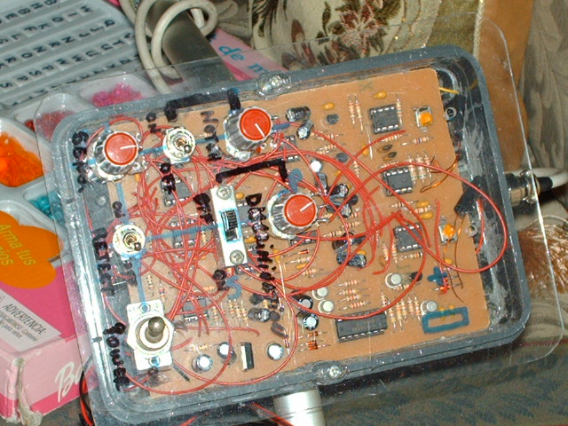

        • Here i m sending my golden sabre detector that is housing on a plactic electric box and the front panel is transparent, so you can see the circuit inside of it.
          Best regards
          Nelson

                Hi Nelson,
                nice housing ! I like it!
                "When i turn it on and disc is on too, no sound and no detection is comming."
                Strange, battery check must be performed in disc mode... you would hear the batt. checker tone for 3-4 seconds and then nothing else, no sound.
                Remember that is motion detector that way and you need to move objects in front of coil (or coil respect object) to get detection of it in motion detector.
                If you move object and get no sound maybe is due to reject control... try with diff objects at 3-5cm from coil: you must get some detection.
                About ground balance, this procedure is making only one time, or on diferents soils must be adjusted again. If so, is posible to put and external pot to do this from the front panel, every time you need to adjust GB on diferent soils?
                Yes, on original project was a trimpot that you set one time on test field or using ferrite... then leave always that way.
                My idea is that if you work on different kind of soils you'll want a panel pot instead, to make small adjustements on every field to get maximum performance and stability.
                Anyway, you could leave the PCB trimpot, as Ivconic suggested, cause GSabre is a very tollerant machine... and you wouldn't get out of tune in geb section if you go hunting in "easy" or "normal" soils... (no black sand, not too iron oxides...).
                I suggest you use first trimpot... and try on different 3 or 4 fields... just tune it on 1st field... then if you notice that somewhere else you got falsing due to geb you could change trimpot with a panel pot to make life easy.
                Best regards,
                Max

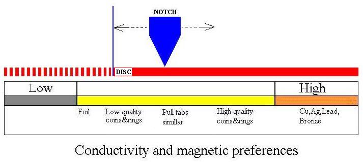

                • Notch!
                  "Notch" function is very easy to understand if we imagine this as chart, see bellow;
                  "Notch" can start from least point of Disc but not less. Also can end at end of scale.
                  On TGS you can also adjust Notch Width, as position also.
                  No wonder if you can not hear tone. Pay attention on what level you adjusted Disc, than
                  "move" Notch down to that level and try to detect material which suits expectations.
                  If detected than rise Notch a bit (in Reject mode) and than should not be any tone.
                  Same you can try in Accept mode, although this time you should hear tone.
                  Notch function helps you to distinguish much precisely type of metal detected in Disc
                  mode range. Logically you can not set Notch lower than Disc. Pay attention on that!
                  I ejected Notch part from TGS just cose it is not necessairly, also due smaller pcb,
                  less pots, wires,switches....Much easier to find housing and pack it....
                  Of course it can be very usefull finction...but i do not need it. Whenever it beeps in
                  Disc mode, i dig....

                    By now i´m concentrating on coils and TGS functions ( thanks Ivconic and Max for such good information). The circuit is workink ok and componets replacement posted here are ok too. I just replace LM308 and made some fix on 4.7 pF caps, has Ivconic do.(Thanks Ivconic).
                    I´m at my work now, so test will be performed today i hope in the evening. Coils will be fixed this weekend or before that if i can.
                    Thanks again i will keep in touch for more information about this nice detector.
                    Nelson
                    Bravo Nelson! Very nice!
                    • WELL DONE Nelson!! I'm so glad it all works for you after the amount of effort you put in.
                      It' so nice to see peoples hard work and perseverence pay off for them and boy has Nelson worked hard on this one !!

                            • Thanks Sean_Goddart.
                              Yes it`s has been hard for me to get into electronics again after 20 years of living my studies. The reazon, i decided to study another career. But anyway, electronics is still my hobby and after i discover this web site and forums, my interest on making my own metal detectors, opened for my a new world of fun and why not a way to make money while you walk with your metal detector by parks, schools, beaches, etc.
                              Now i need to get a good coil, so i ll keep trying and trying, experimenting and experimenting, this is the only way to get things to work.
