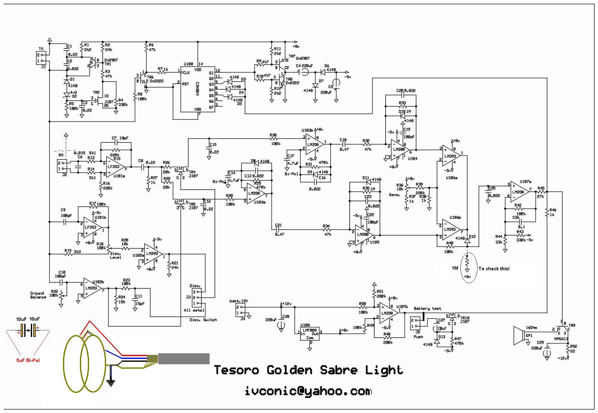

            I already made two G.Sabre's and two S.Sabre's so far.Wanted to know how those are working.
            Also made few coils for those. Already posted some of experiences with coils.
            I want to "establish" one and only good schematic and from now one to make only that.
            Much experiments so far. After dozen different projects i choose Tesoro Golden Sabre to be
            my favorite detector to build. Why? Simply, all real functions that prospector need on
            field G.Sabre already comprehend. Discrimination is so good, it can fully discriminate
            foil, iron.....what man can wish more?
            Depth is great! Maybe i had luck to calculate and make quite proper coil for it, but my
            experiences are so good...much better than some posted previously on this forum. Already
            made few identical coils, just to check if i can make those as standard....It was not lucky
            guess or coincidence, yes i got it for good!
            Also noticed that G.Sabre is for real much better than S.Sabre. Greater depth even 30%.
            Solution with 4024 turns to be more effective than 7660...? Why, i dont know. It seems that
            all stages in device are better synchronized if dependable on main oscillator frequency.
            So i rearranged schematic and cut out "notch" part, so pcb would be as smallest as possiblle.
            I also rechecked schematic and previous pcb...? Except those 2 resistors(4k7) in chopper and
            one missvalued capacitor(15pF) i dont see any other mistake. 4148 diode at LM393 output
            ("Sense" stage) is not reversed??? I think somebody claimed here that it is reversed.
            I never tried to reverse it and see....Made my detectors according to posted pcb and those are
            working good.
            So here is Golden Sabre "light" schematic. I hope it is accurate. Checked few times....

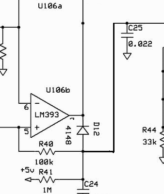

            • i dont see any other mistake. 4148 diode at LM393 output
              mine vision, what must be here.
              • ... and there must be certainly loading resistor parallely to the diod.

                    Hi Ivconic,
                    I believe there is an error in your schematic in the Ground Balance and Discriminator sections (U102a and U102b). Both R21 and R24 should be connected to the positive supply rail and not 0V. The LM393 is a comparator with an open-collector output. Note that you do have U106a and U106b connected correctly, with the outputs wire-OR'ed and tied to +5V via R41.

                              Took another look at it, and...YES! KT315 is right! I traced pcb again.
                              Yes KT315 you are right! How i missed that!!!??? I have few different
                              schematics here....I payed attention on wrong one...Shhheeeeeesh!!!
                              Bravo KT315 and thank you!
                              But about loading resistor you mentioned...? I am not sure? Yes i can agree
                              with you, there must be loading resistor...but it is not there? And device is
                              working excellent!?
                              I corrected schematic and here is now; i really hope complete and accurate!
                              Porkluvr....Yes double O coil showed best results so far...but i gave up of those!
                              Why? I am gonna explain why; not so suitable on terrains i've been visitng lately.
                              There are a lot of bush arround,tree roots all over arround, high density opsticles
                              and OO coil is not just suitable enough to approach to every spot;under some tree or
                              between some stones...when coinshooting. I do that mainly...coinshooting.
                              So i made hard compromise and switched back to DD (double D) coils, again...
                              Double D shape is much more suitable for that kind of prospecting than double O.
                              But if you prefer leveled terrains than i suggest you to make OO coil cose a bit
                              greather depth than DD coil.That was my only reason to leave OO coils for now...
                              No i didnt say "...no gnd connection on RX..." !? Yes there is gnd connection on RX!
                              Must be! But not at pcb. That's why i didnt draw gnd connection in schematic.Not to
                              confuse somebody who might decide to draw pcb according my schematic...Later should
                              scratch or cut that piece of pcb to correct mistake...
                              GND connection at RX should be made in coil.
                              Pay attention on cable lead which connect coil via R13 to pin 6 of U101a!That lead must
                              be connected to gnd in coil!
                              I am using cable with 3 separate leads and common shield. Shield and 1 lead are connected to
                              faraday cage at both coils...all togather in coil housing. The other 2 leads i am using for
                              TX and RX....Simple as that. No twisted pair effect,no hums,interferences...no false signals!
                              I experimented with any other combination and this one is best.
                              Nelson, no you can not use only 3 lead cable....Shield and 3 leads yes! It makes 4 leads at
                              the end.
                              LM308 is hard to replace...beleive me! Only replacement i would use is TL081a...
                              About Bipolars....i never used those. I connect 2 ordinary 10uF cpacitors like this;
                              + -- + and used those instead...
                              No, Nelson...if you using TLxx1 no need to reroute pcb; pin to pin compatible...
                              About NE5532...i am not sure...why dont you try NE5534? I never tried it...
                              OK. Again there is (i hope) very correct schematic...at the end. Take another look.
                              If something wrong let me know...
                              Anybody migh have good will to draw pcb for it? One-sided,small...C'mon....
