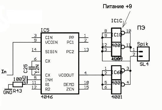

                      • VCO again...
                        Max take a look at this;
                        could this be used on TGSL? I am wandering....
                        Took it from "gradiometer".....??? Already asked KT315 to translate some Russian words about this..."pitanie"...
                            I think it's a VCO with buffers that directly drive the speaker (probably piezo like in table phones). Buffers are logic gates of 4001 (4x 2 input nor-gates).
                            Result is a like square-wave at speaker like in some distorting push-pull end-stage.
                            It's similar to what I meant for a good VCO, with common easy to find (4046) still today and cheap IC (around 60-70 eur-cents).
                            The interesting part are external components used (cap. and resistor) for selecting the hi-frequency limit.
                            Best regards,
                            Max
