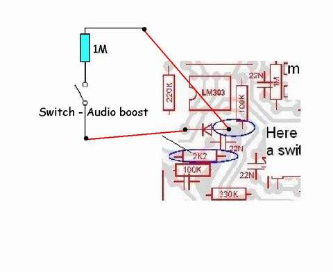

    • But...if you insist; here it is!
        If you look at the schematic posted earlier, where I asked you to disconnect pin 1 of U106A, there is no 1M resistor. BUT - if I look again at the original schematic, then there is a 1M resistor, but it is connected by a dotted line with some words that say "To check this!". Must be an old schematic.

                  • I do have idea already....
                    Glad to see that you suggested scale...only have to find good one.
                    I'll prepare schematic of "coil balancer" and post here later...
                    Actuallly i dont need to include separate oscillator!?
                    Best way is to suite exact coil to exact device and only way to do so is to use origin oscillator from device, when balancing coil...
                    So i'll consider only RX part...

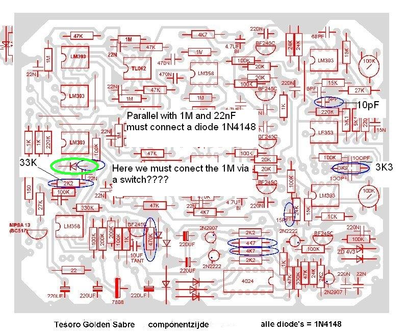

                      I attach here the pcb with errors that Max sent here. I have checkthe 10pF... the 1M and one diode that there is at the schematic but no at the pcb. Tell me if are correct.
                      I have 2 LM308 with metallic case. Where is the ledge??? Ivconic said that it is on pin1......... i looked at datasheet and shows it at pin8. Who is the right.... the shop had only 2 pieces so i dont like to burn it.
                      Hi Geo,
                      look at green oval... there is the diode (labeled as D12 in TGSL schematic by Ivconic) : you have to put the 1M resistor there in parallel to diode... but using the switch in series... to connect/disconnect it.
                      Be aware of it if you notice too erratic noise without. If there isn't too much internal noise you can use it gaining better audio for far targets and weak signals.
                      About the cap... yes... 5 or 10pF. You can use 5pF without problems; circuit works also with 10pF there... me cannot see or ear differences by that.
                      Looking at other schematics by Tesoro now actually I think it was 5pF and not 10pF. But maybe TGS is different from them... who knows.
                      Important is that works with both.

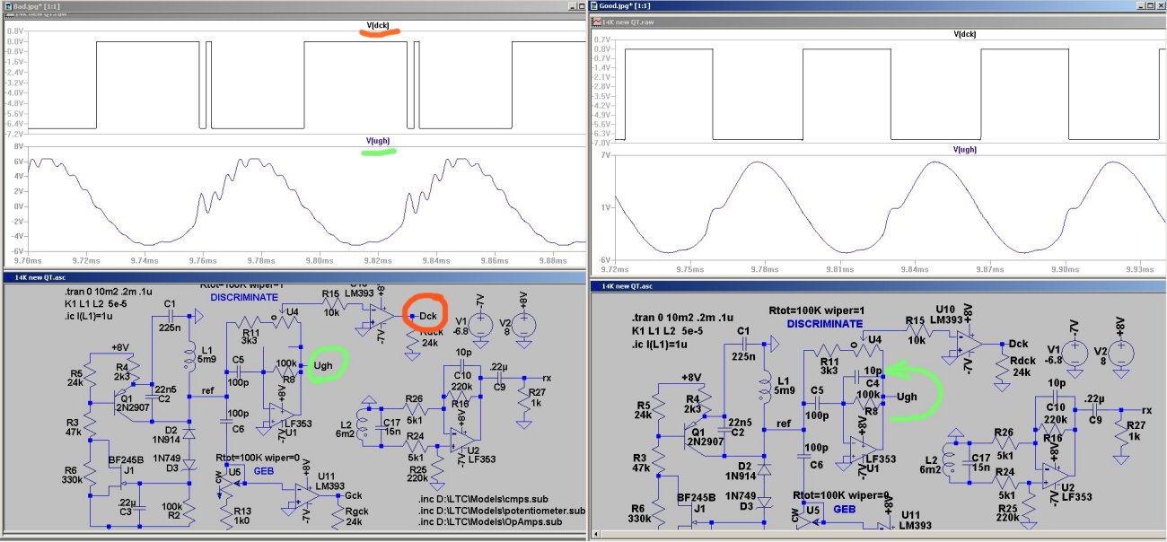

                        • too much Q?
                          Ivconic-
                          False targets could be caused by instability of the DISC opamp.
                          The high value of feedback along with input capacitance can cause ringing.
                          It will be worse if you have a Hi-Q coil.
                          I had a longer spiel typed up to explain my screen shot image,
                          but my computer crashed while editing the photo. I hadn't saved the text. Sooo, I'll just post the before and after photo and let you determine if you can use the info.
                          Adding a capacitor across the 100k resistor makes the TGS DISC control similar to the Bandito's topology.

                            • Hi Porkluvr. Can you simulate the circuit with Tx transistor the 2N2219 and Vosc=18V. I want to see how much bigger will be the Tx signal and if the signal phase is the same.
                                No Geo! Beware! I sad that made MISTAKE considering pin 1. under notch...
                                It is pin 8. under notch not pin1. !
                                Yes there are 4k7 resistors in chopper, not 47k as showed in schematic.
                                There is also 2k2 instead 33k....
                                about 470k in battery test....i put 470k,it is working...
                                1M resistor goes parallel to diode...only if you want to boost audio. For now do not put it.Leave as it is...
                                Ok Ivconic.
                                In the schematic there is a diode at one LM308 that there is not on the pcb (pcb shows only one LM308 with diode parallel to the feedback resistor). Do you connected it??
                                I finished the pcb with the components. Now i must connect the potentiometers and switches and it is OK. Maybe tomorrow .... today i am busy.
