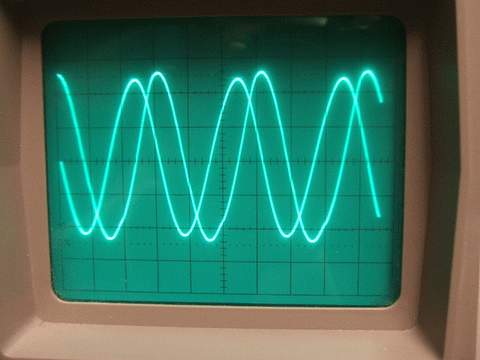

    Hi Ap,
    thanks for the good qualiry pictures. Last 4 are like what I have... but I haven't a sinus at pin1 of LF353. Are you sure you are sampling at pin1 ? I'm referring to the original schematic... as in the picture under the red circle
    Hello Max.
    The signal is from 353-1 it is however not 2 v p/p, but 2 volts per division...
    The signals are from the goldy, not from the GS with notch.
    Ap

      Hi Ap,
      thanks for the info.
      So I have a problem on disc ! Maybe is similar to Ivconic's problem ... the capacitor !
      I have just graphite pots... not wire wound so think the problem could be at capacitor.
      Thanks again,
      Max

        Max, see picture bellow; that was mother ....capacitor!!!
        Nothing much to explain; i traced signal from oscillator and noticed nice shape before capacitor and quite deformed after it... When replaced signal had much better shape. When tested on coins and other items...great work!

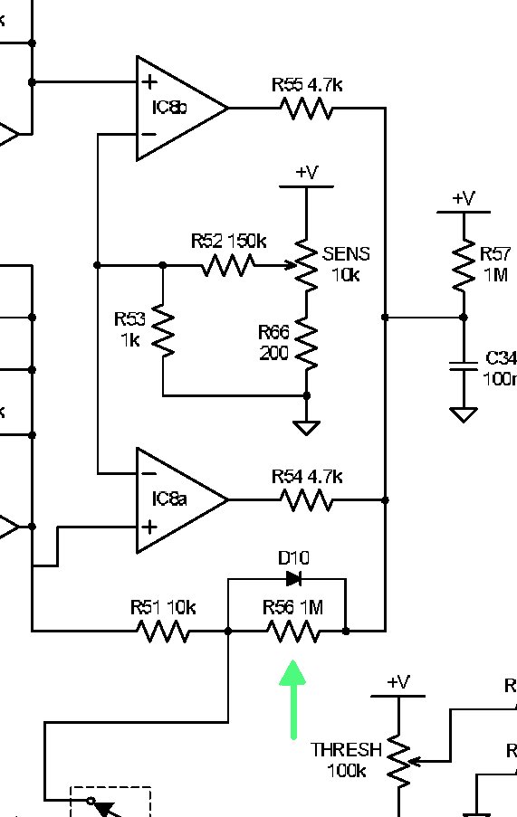

                I deserved rotten tomato in face now! Why? Because that 1M resistor KT315 suggested, now is making a lot of sense! Geo do not make any mod with 555 until you try this one! Just put 1M across diode (parallel) as i posted on previous pages. It will improve audio very much, than you decide about modding it further or not.
                Since TGSL is working in both modes very stabile i intend to retreive switch with 1M resitor...

                  • OK. Problem is solved,TGSL is working just fine. But i experimented further.Some thing can not match here?
                    I cant achieve same oscilogramm at pin 1. of LF353 as ApBerg's posted here:
                    • And here is what i gainedd with good capactior...But i had to put 330pF to streighten up signal. When 100pf is on the place oscilogramm is still "broken" ...
                      • Experimented with values from 100pF to 330 pF. More i raise capcitance - the better oscilogramm, up to 330pF..
                        Except changing oscilogramm i havent noticed any other changes in TGS behavior!??

                            the 1M resistor is also in BandidoII schematic by default... it works cool when there is few erratic noise around... otherwise better avoid it at all.
                            The signal I see is with 330pf instead of 100pf ? Seems a square wave now !
                            I've tested my cap and it's ok... I've changed also it and all is the same... if I pull-out the lf353 I can see after the 100pf cap a perfect sinus signal like the one of Ap.Berg... but then when I mount LF353 it distorce the signal and I got the parabolic one with the damped oscillations.
                            So problem is at op. amp. inputs !
                            If I put a TLC2262 there instead of LF353 I got a near-to-sinusoidal wave... but different and with much less dumped superimposed signal.
                            TL072 there works exactly the same of LF353: signal is distorted.
                            The funny thing is that disc works pretty good... and it cannot detect an hammer at 1cm in disc mode!
                            So what's the story with LF353 ?
                            My actual part is LF353N from National, original part made in the 90's.
                            Any idea ?

                              • Hi,
                                here is the bandidoII part I mean... I remember that same problem happened in bandidoII : 8ohm speaker = bad, just good an apple computer 16ohm speaker with it.
                                So, of course, KT315 is right on mod... he followed Tesoro's rules ! so if you have to launch around rotten tomatoes... you have to point Arizona first ...
                                I'm joking now. Of course it works... and at Tesoro they made great designs!
                                but that will work ONLY if there is already really rare and occasional noise... otherwise it's a real boomerang.
