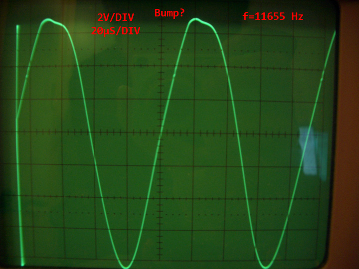

  • Do you mean this bump?
    My scope is pretty accurate, just recalibrated it with test signal. I measured the frequency with my multimeter, but now I know it shows false numbers. When I test the frequency, the wavelenght in scope gets shorter, so it measured too high frequencies all the time .
    The TV inductor has around 11,6kHz at 7mH (27nF parasitic + real capacitance), TX around 11,3kHz (34nF parasitic + real capacitance) at 5,77mH and RX around 10,4kHz at 6,22mH (38nF parasitic + real capacitance) measured with scope. I guess the usb cable added even more parasitic capacitance
    I guess I have to wind another coil <.<

      Excellent ideas "Dennis"!
      If you (akademiker) are convinced it is some defect in the TX coil, I would try unwinding it, just to see what it is!
      -SB

        That's the "bump"! Looks very normal.
        How do you measure parasitic capacitance?
        If we use 38 nF + 20 nF (C2, C1) for C and 5.77 mH for L in formula, I get 9016 kHz for oscillator freq, which is about same as I measured from your first scope photo of TX signal. Interesting. Although the photo of sync pulses seem more like 9.6 kHz.
        Exactly what glue did you use?
        Interesting about your frequency meter -- one of my meters interferes with the oscillator also, the other one doesn't. Maybe we need to add a big resistor, or a little JFet circuit or something to buffer it.
        Tell us what you find if you take apart your TX coil.
        -SB
        • Well...there can't be a short circuit inside, because inductivity and resistance are as expected, maybe the parasitic capacitance is just "eating" away the sinus? But even if the coil is at 11kHz this shouldn't drop the voltage as the coil is always in self resonance or does it?
          Lets see if I can find some copper wire inside the giant coil in my broken CRT ^^
          Tomorrow I will wind a new one and this time I will be most precise and after comparing I will solve the mystery of the broken coil ^^
          "How do you measure parasitic capacitance?"
          I calculated it, if I know f and L I know what C must be. Nono, the 38nF include C2, as C2 and Cparasitic are the cap in the oscillating circuit.
          Some cheap allround glue "Tesa", maybe i used a little too much :S

            Ok -- your scope photos looked like 9 kHz freq, consistent with 58 nF. Does your scope agree with your frequency meter?
            I once glued a coil with Elmers white glue (water-based glue), and it seemed my coil lost something. I wonder...
            I agree it doesn't seem like short circuit. Maybe some crazy physics going on. I'm curious. I wonder if water molecules in glue are causing a large damping effect (well, it is "damp" ) because they are dipoles flipping around...
            A good physics/chemistry puzzle.
            If you glue coil again, first test before gluing, then again after gluing.

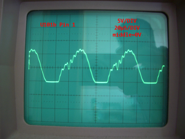

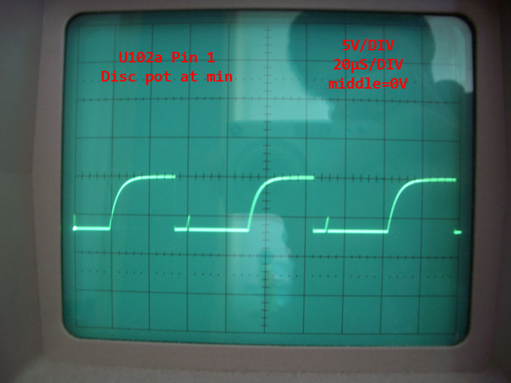

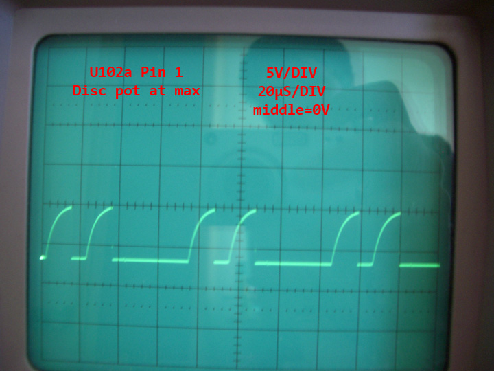

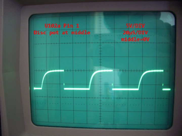

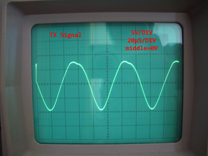

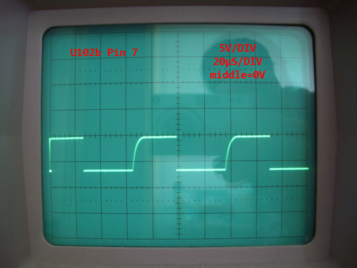

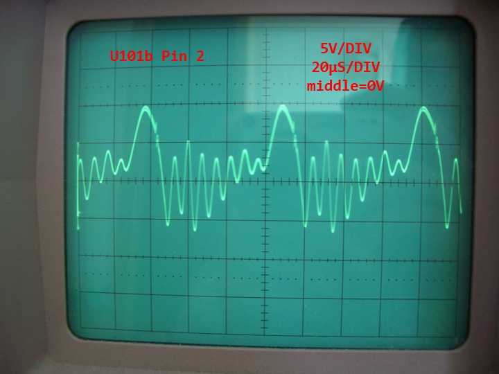

                    • ok, sensitivity has increased a little bit, but still only 20cm for a silver coin and about 12cm for 1e :/
                      TX is running at 14,49kHz, according to scope, RX is tuned to 15,5kHz
                      6,6mH for RX and TX 6,2mH (I swear they were 6,5 and 6,2 without shielding :/ )
                      I attached some scope pics, the input and output of U101b seems wrong to me.
                      Trigger reference for all pics is tx signal.
                      • If you will put a 10pf capacitor across U101b between pins 1 and 2 that should take care of the amplifier instability. It will have some effect on the DISC pot phase response but that effect should be relatively insignificant.
                        By the way, it you compare the Bandito and the TGS DISC phase shifters, you'll see they have the same topology except that Bandito uses a capacitor like I suggest.
                        You can possibly get by with a smaller value cap but 10pf should squash yer U101b oscillations dead.
                        • I had the same problem with the waveform of the U102a pin 1. In the original design of the TGS (not the light version) there's a 10k pot in parallel with the R18. I soldered a 10k resistor in parallel with the disc pot. After that, the disc pulse was neat.
                          Andy
                          • I soldered a 10k resistor in parallel to the disc pot and now the problems in Img1,3,6 are gone, but still aweful depth >
                            When I look at pin 7 of 101a I always get a squarewave from -2V to 2V, nulling just changes the phase and somehow its 12kHz, but it should be 15,5kHz according to RX and C6(just measured).
                            Edit: I switched RX End and Start and now I could null till a sinus about 0,5V. But I nulled while analyzing the Gate of TR4, so it looks like in http://www.geotech1.com/forums/showp...postcount=3896 and now i get around 23cm for an euro, but disc is not working and in all metal mode its "motorboating"
                            At the Gate of TR5 I get a full sinus wave, but it should be just a half wave, right?

                              • Finally found the bad boy! The 15nF in the RX part wasnt really 15nF, but more like 18nF <.< now I replaced him (hammertime) with with the closest to 16nF I could find (16,17nF +/- 2,5%) and now the discrimination works kinda good, rejecting ferrit rod completely while accepting silver, and can even discriminate a bottlecap (made out of thin iron here in germany) while accepting a goldring (at less than 20cm). In this option it ignores 1e completly, even in all metal mode <.<
                                TX is now 14,285kHz
                                RX is now tuned to 15,596kHz, which is 109% of TX
                                RX is shifted exatcly 4µS, which is about 20° at 14,285kHz
                                The sinus output at Pin7 of U101a has an amplitude of 1,8V and my signals at the both gates of the mosfets look kinda upside down, exactly inverted version of these: http://www.geotech1.com/forums/showp...postcount=3896
