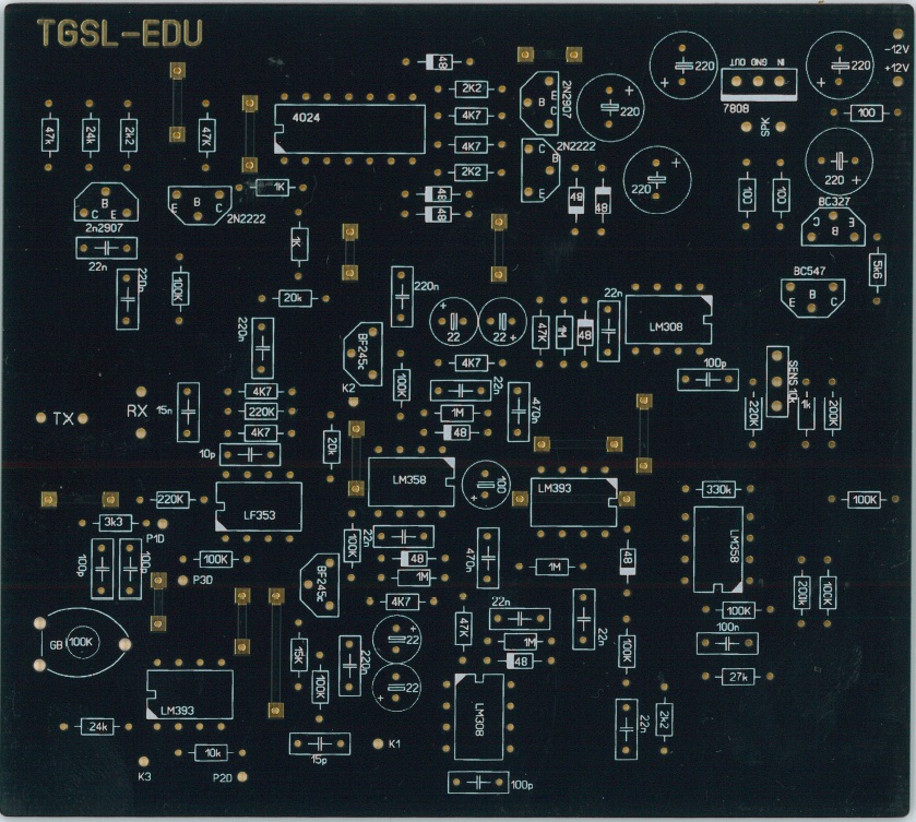

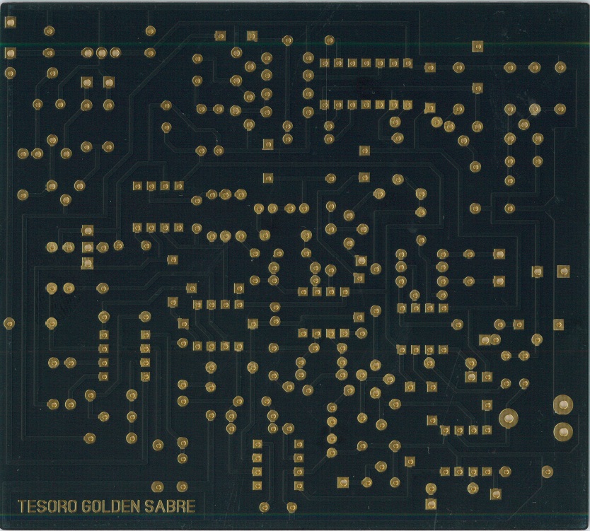

      • TGSl New Boards
        Now all the previous boards have gone, I have just taken delivery of some new ones, based on the TGSL-EDU design by Eduardo, and very sexy they are too, black with immersion gold (well it is Golden Sabre)
        Hopefully these are 100% correct.
        It would be nice to have a matching schematic and "idiots" guide, I will start a new thread TGSL-EDU, and post details of these boards, if anyone can help populate the thread with useful info , scope pics, coil help etc.. it would be a great help to members
              Silverdog

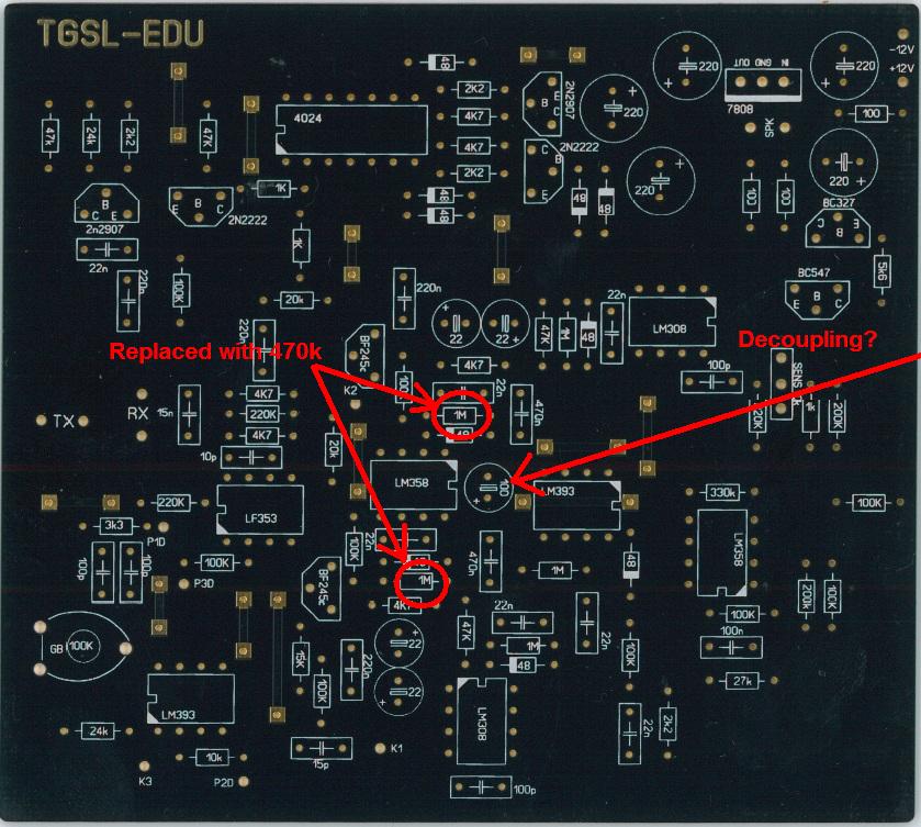

              I probably have 30+ hours of field use on Ivconic's version with fantastic results. I only have a few hours on this version and my only concern is stability. I actually replaced the 1M Ohm resistors with the original 470K Ohm resistors used on earlier versions, just because I can't keep it quiet on occasion. Doubling the gain on this stage is a two edged sword. I'm not saying that someone else may not have good results with this version and replacing the 1M Ohm resistors is easy. I think that I may have better results far away from electrical noise.
              Also, question for Eduardo: Is the 100uF cap circled below a substitute for all the 100nF decoupling caps on Ivconic's version? (Note.. Decoupling caps are not pictured on any of the schematics but are evident on Ivconic's TGSL PCB version). There is a reason for using 100nF decoupling caps, especially for the LM308s. Typically, smaller ceramics do a better job of filtering noise over the electrolytics, at least that is what I have read. I'm just looking for justification on leaving off the 100nF caps.

                  Hello. All 100nF capacitors have been replaced by one, which is to 100uF. I have tried to simplify this circuit and give more profit by replacing the 470K and 1M resistors and capacitors of 10uF,and 22uF capacitors. The good part of my project is the audio and power supply is put into the top plate and the negative speaker connects directly to the mass of the source of alimentacion.Si to someone more interested in the version of Ivconic the same can be done with it, all you have to change the values ​​of the above components. Honestly I like how my version and I've never had problems with some vital signs false. Greetings. Eduardo.
