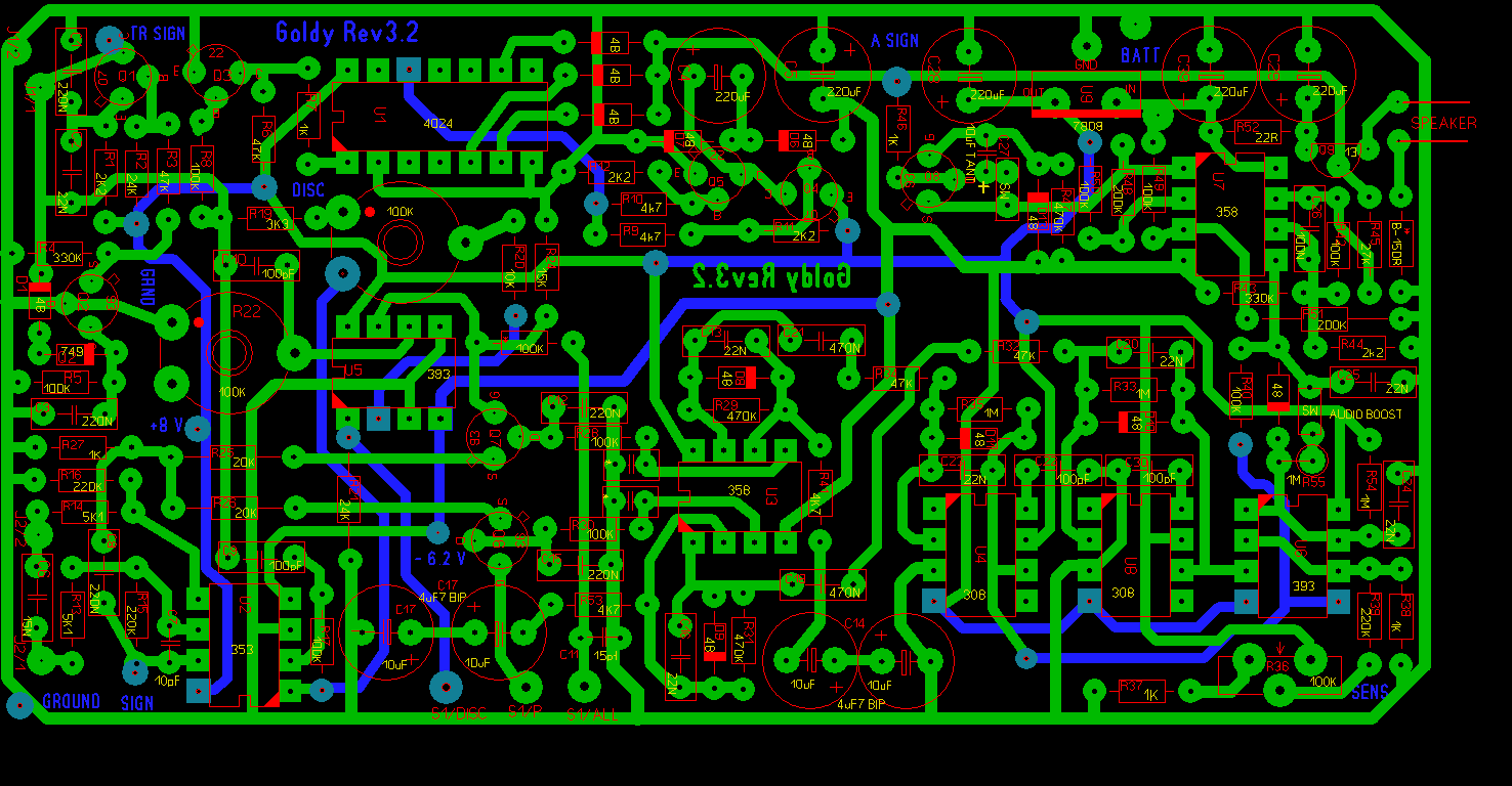

        Did anyone every make this "GOLDY" PCB from Apberg ??? I wonder if "some" Ground Plane placement parameters or component placements can be used for Tesoro Golden Sabre Light PCB . I have not compared the two yet to see similarities , if any ................Thanks..............Eugene
        Hi Eugene.,
        Is that PCB V3.2 ?
        Fred.

              Originally posted by Fred View Post
              Hi Eugene.,
              Is that PCB V3.2 ?
              Fred.
              Fred . The Goldy .Lay file should open on sprint 4.0 . If not , let me know !!
              Max , may the problem you have , get settled quickly !! I look forward to seeing you everyday working on the Relic Hawk with Fred this Winter !!!!!..............Regards.......Eugene

                  • Originally posted by Eugene52 View Post
                    Thank for answer,but look at this PCB, it“s labelled "goldy rv3.2", i don“t know which one is the most recent.
                    • TESORO GOLDEN SABRE
                      Hello Fred , I sent ApBerg an e-mail asking if rev 3.2 of "Goldy-PCB" was final version and did it work Good ??? I should get an answer soon ............Aloha from the Desert.........Eugene52/Stalni-clan / non-guru member
                        Hello Fred . Got the answers for you this morning !! O.K. , the 3.2 version was the last and it worked very well . ApBerg said they , him and Nakky worked on this Goldy together , but it is higher in frequency at 16 khz and the circuit uses regular capacitors not the 4.7 uf bipolar !!!! He will have more on this later . I told him to get back to this forum again , he was a big contributer when he was on here !!..............Regards...........Eugene
                            This looks like traces on both sides of board, correct? Is that more difficult to make?
                            -SB
                              -SB
                              Yes, because you need to etch the PCB on both sides,(i do one side at a time), and positioned carefully so holes match.But on this particular PCB there is no much traces on the upper side so you could use wires instead.
                              Fred
