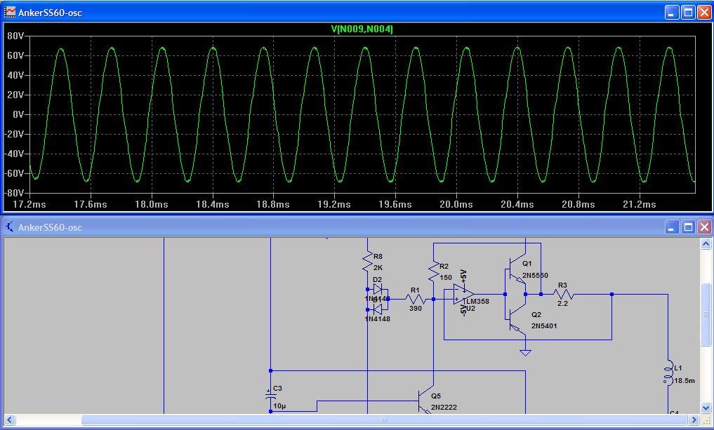

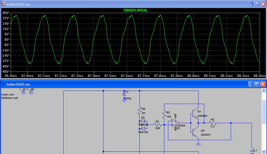

      Hi Geo,
      what's the story with Anker TX ? I mean I read an Anker's post that say
      TX - 50-60 turns wire diameter 0,3мм
      Then when I've simulated circuit I got that to have 140Vpp at out you need use at least a 18.5mH inductance coil at TX... otherwise you get less voltage cause of resonance.
      What about frequency too ? I get 140Vpp at 3KHz not 6.2KHz for TX.
      Am I wrong ?
      Look diagrams:
      first is with coil = 5mH
      second is with 18.5mH
      Best regards,
      Max

        My coil was 5mH and the frequency 6..Khz (i don't remember exactly, but not 3Khz). Voltage was 140V p-p.

            • 140Vp-p, Yes. So when you try to Null the coil if you will take 200mv on Rx coil then you are OK
