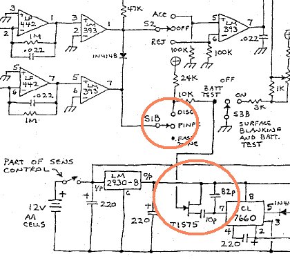

                            • about 2 tones generation in royal sabre
                              this post just to explain the trick of two tones in royal sabre...
                              How it works ?

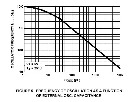

                              First of all you can notice there isn't any cd4024 in it that gives the frequencies for audio tones... the source of tones is the supply voltage converter ICL7660.
                              The ICL7660 has an input, pin 7, for the connection of an external capacitor that dictate the frequency of operation (from few KHz to 10KHz in standard 7660).
                              Now you can see in first picture the frequency obtained vs capacitance. Look at the higher freq. part you'll notice that with 100pF one get about 1KHz frequency and at about 80pF one get about something less 2KHz.
                              All it's related to the capacitance at pin 7 that could be 82pF or 92pF depending on the status of conduction of the TIS75 fet.
                              When in DISC mode , setting a value at notch pot , is possible defining a level of phase passed over or under which one or both capacitors are connected to PIN7 thus giving the two tones.
                              The frequency separation is of some hundred Hz and probably has no great influence on other parts of circuit , cause 7660 is an efficient device...and so voltage will vary a few from the low frequency to the higher and the reverse from hi to low.
                              This approach could be replicated in standard TGS using a VCO ic like the LM566 or e.g. an CD4046 internal VCO etc.
                              It is any good ? I have lot of dubts on it... my first problem with it is that the two tones separation threshold value is related to manual adjustment of the notch pot... that for me is a bad idea... the best will be adding 2more channels to get similar behaviour but with a fixed preset...
                              but then also the circuit start becoming complex.
