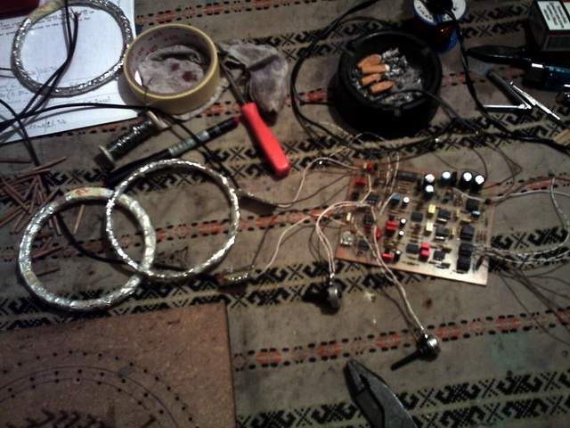

          About G.Sabre; NOT WORKING!
          Same problem as Leto's; not oscillating....I changed several coils - nothing!
          I have doubts in fet's i put, J107....I dont have originals, neither BF245c or simillar, so i put J107....Not same pin assignments as BF... maybe i made some other mistakes....who knows?
          I have +8.23V and instead minus i have +0.78V.....
          At one moment resistor 22 ohms burned (at audio output)....previously i put 8ohm speaker.....maybe because of that? So i added few ohms in series with speaker.....calm...but the rest not working!
          I put ordinary 2n2222 in plastic cases, 2N2907 also in plastic cases...is there problem?
          Instead ZD4V2 i put ZD4V7.....? I dont beleive this is problem....
          Later i replaced J107 with BF245B...but since i had only 2 of them i replaced those in oscillator and chopper for minus....Others omitted just to test these two stages and nothing! Same as with J107...?
          Coils....i checked TX with several various coils - various inductances,resistances....same - nothing!?
          I am tired.....continue tomorrow with this bull****...
          regards!

            Hi Ivconic,
            Golden Sabre will work for sure,..
            I had identical problem, circuit not oscillating -->
            had to hook on Tx coil with following params. to get it oscillating at around 5kHz: diameter/13.5cm, turns/240, wire/0.2mm.

              I found out! I took 2N2907 from scraped pcb,without checking; it turns it was burned previously!??? Since dont have another, i put BC557 just for testing.....and....it is ALIVE AND KICKING !!!! HUUURAAAAH!!!
              Resoldered J107 fets back to its places and all WORKS PERFECT!!!!
              Just like Leto explained!

                    So i made G.Sabre, it works better than expected. I turn to coils last two days. First i made Unregistered coil and.....nothing - april joke....
                    I made several c.c.coils and still nothing - average depth with instabillity....
                    At the ebd i switched to double O coil and success!!!
                    Like it was with Classic 3, same with G.Sabre, best coils ever i made were doyble O coils for both machines.
                    You may trust me or not, i cant help it, but i'll give up from any other type of coil and from now one make only OO coils....much smaller in diammeter but much,much better! Stabillity superb!

                            Few things i forgot to write here;
                            first, i used 0.3mm wire for TX - 97 turns on 22cm former than reassembled
                            and same wire used on 11cm former! Inductance is 6.7mH,
                            resistance 23.7 ohms.
                            I also used 0.4mm wire for RX.....sheeesh! I dont remember that i measured
                            inductance at all !!!??? Sheeesh!
                            So, 145 turns for RX...(finall RX coil).I also made 3 more RX coils with turns
                            from 88 to 160, and with wire from 0.3mm to 0.5mm. Than i experimented with all
                            RX coils i made....All of those 4 RX coils worked pretty good? Which leads me to
                            conclusion than G.Sabre RX input have sort of wide "band width"?! Finally i decided
                            to use 145 turns RX coil cose noticed better performances than with others...
                            I made farady cage with Al foil on both coils. I think this is crucial for
                            stabillity. Also way how to connect F.cage in overall setup.
                            I noticed quite obvious variance beetwen schematic and pcb. There is not connection
                            between RX inputs and gnd on pcb, while it is made on schematic!?
                            I wasnt sure which way is correct (although checked all Tesoro schematics and saw
                            no connection on those), so decided to try both ways and see the difference.
                            There is difference in stabillity; pretty unstabile when RX connected to gnd, despite
                            F.Cage (coupling, twisted pair or something else....), never mind.
                            But when RX not connected on gnd (respecting only pcb), coil is very stabile.
                            To check that, i "punched" cables,coil,pcb....shaked,twisted....tortured it on many
                            ways.....and it was very cool! Not even one false signal! Very,very good!
                            But! The secret is in way how to connect F.cage; i connected both AL foils very
                            shortly (as short as could be, due certain movements while adjusting coils)...
                            Than both Al foils (F.Cage) connected also shortest way to gnd side of TX.
                            Than used 1 coaxial and one "twin lead" cable and made connection with pcb.Coaxial
                            is for TX and twin lead for RX. And that is all. Perfectly stabile.
                            Oh i forgot, i used 12cm former for both coils to wind. Very small, isnt it?
                            But results were astonishing! 2cm coin detecting at 27cm distance in all metal mode and
                            22 cm in disc mode! I can only imagine results with larger diammeter coil!?
                            Cigarretes package detected over 40cm! Cola can over 50cm !
                            Discrimination is very good, much better than Classic 3...Sensitivity to small gold
                            items also very good, much,much better than Classic 3!

                            I tried to keep preferences of coil as close to original as i can. So inductances are
                            pretty close to original.....arround 6mH...some to 6.5mH....Resistances are also close....
                            22 to 23 ohms....I used wires from 0.3mm...some to 0.4mm...
                            Only one thing bugs me with this G.Sabre i made;
                            When switching ON, at first, there is constant audio tone for 3-4 seconds, than decays and
                            stops. Than it is ready and start working perfect! Is this normal!?
                            If it is not, than i suspect some capacitor maybe not good, or maybe some fet or transistor?
                            Cose i used very old J107 fets from very,very old and rusty scraped pcb...dirty and look
                            100 years old! They all looking good, but those are very old components...."exausted" much!
                            Also, i put very old (but tested and good) Bi-polars....Heh, 2 of them are 4.7uF and 2 of them
                            3.3 uF....I couldnt find 4 same....so i put 3.3 just to test device, and those stayed on it.
                            Also i put old elco's (220uF), but also previously tested with cap. meter.
                            In TX i put BC557, in audio put MPSA14....i forgot; in TX and in chopper there are 2 BF245b
                            still (not replaced with J107)....the rest of fets are J107's....
                            IC's are all originals - no replacements.
                            So, why it "singing" when switched ON for few seconds? Anybody have any idea?
                            Regards!

                              Hello Ivconic.
                              I have regestration, forgot the password.
                              Nice to see you good succes, the pcb form the golden is good, the schematics from the tesoros have some small errors, the ground for the receiver is made in the coil, this for the twisted pair effect, use 2x2 twisterd cable ( see cat 7 network cable ) Have seen Belden cable 2x2 with flex screening, never has seen it for sale, somebody nows ?
                              The startup signal is the batt. check, this is the part with the 10uf tant. cap and fet and resistor to minus.
                              For the bibolar 4.7 uf a frend used 2 smd 10uf caps connected togeter.
                              For fets I use the 2n4393.
                              Good luck !
