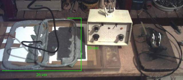

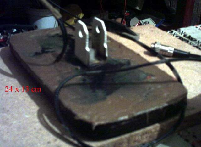

                  • #54
                    Wow !!!!
                    Extreme good results!!!
                    I finished packing it in box.Also finished smaller coil and preparing a bit larger.
                    Both tested.
                    1cm coin at 36cm with larger coil, absoulute stabile, no drifts,no hums,no false signals!!! Discrimination perfect!
                    1cm coin at 30cm with smaller coil.........rest same as with larger!
                    Smaller coil tested on ground. 29cm depth detection of 1cm coin burried in ground! Much better than Musketeer!
                    " ...if Minelab can do, why dont we?"
                    I told you...didnt i?
                    Both coils same inductances; 6.5mH for Rx and 6mH for TX.... (double D)
                    Larger 26x26cm and smaller 24x13cm (double O coil)
                    What to say?
                    I guess i was sort of blind, wasting my time with Classic so far....
                    This Golden Sabre is perfectly optimized, thats why so good results!
                    I dare to say that it is much better than Bandido too.
                    So....thats all so far!

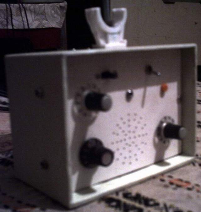

                    • #55
                      Photos...
                      Here some photos...
                      • #56
                        Unit
                        Unit...
                        • #57
                          Smaller coil...
                          Smaller coil...
