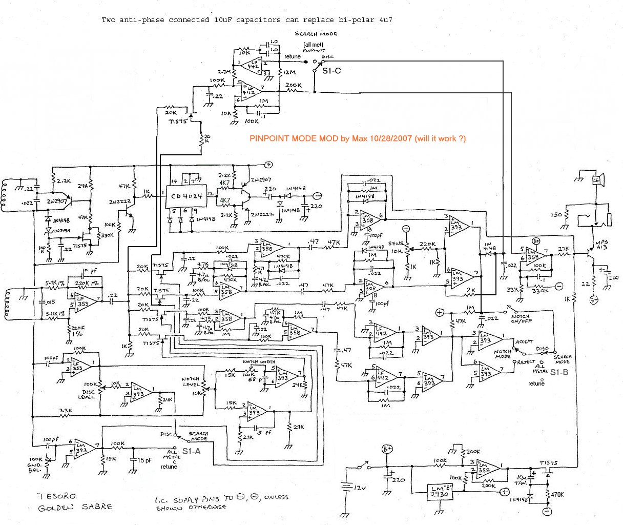

    If we add a channel for Pinpoint ?? (the upper LF442 from Royal)
    Hi Geo,
    About the mod: yes we can do very easy... just add the upper channel of royal to TGS and will have it. Another fet + the double op. amp. and some other stuff... + the 3-position switch like in bandidoII... with "retune" position I mean. That's it.
    Real question is: it's worth having it on TGS ?
    I personally don't think it's a big improvement having a pinpoint function on TGS unless you use a concentric coplanar coil... then not for me, I use a large DD coil with it... and you know that's not the same thing of having a polo or 9x8'' concentric coplanar to do the same thing.
    With round CC coils is very nice using pinpointing (like e.g. in bandidoII) to better find the spot were the target is just under... but with DD coils ...and great too it's not the same thing.
    You will find the central line were target lye but then you have X-ing it by another angle to find the spot... of course, better than having just motion detection... but I think that's about the same in practice: you have to search for target much more than with concentric.
    What do you think ?
    Best regards,
    Max

        Hi Geo,
        yes sure. I agree ...we can play with this feature too... it's also easy to apply to existent TGS design... and requires few stuff more.
        What I said is just that maybe this feature is not so essential or useful for who made already the TGS using a DD coil... but then anyone is free of doing so if think it could be a good thing for testing... or using better the detector in the hobby.
        I think is not good FOR ME... and that apply just to me cause other people could think otherwise.
        The same for "2 tones" of royal approach... I think is no good but others can built it on TGS using same circuit parts.
        They work for sure also on TGS that's pretty similar for other parts so... anyone will choose what's better for his personal needs... if adding them or not.
        Best regards,
        Max
        • Hi,
          made a bit of "patchwork" with royal and TGS... uhm
          though I'm not really interested in that... just to spend by 5cents !
          Will it work ?
          Who knows ? I've made in 5 minutes... don't take it for tested thing ... it isn't !
          Only way to know is try it... but I can't so I don't care too much
          Purpose is changing all-metal from motion to non-motion mode (for pinpointing targets) and add, of course ,the fast retune as in the royal sabre.
          Ideas ? Comments ? Dubts ?
          Kind regards,
          Max
