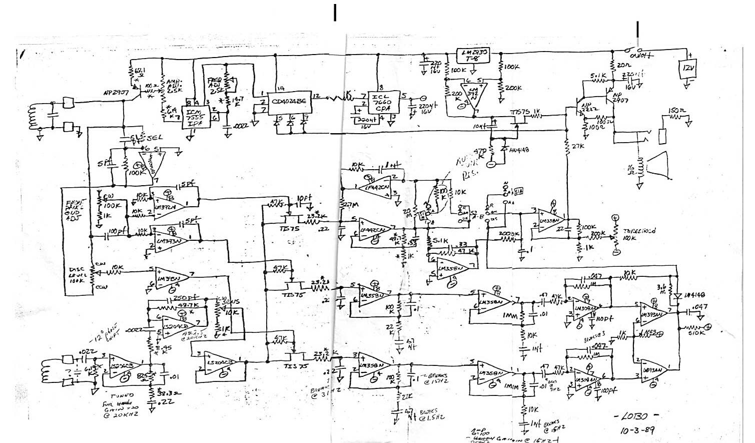

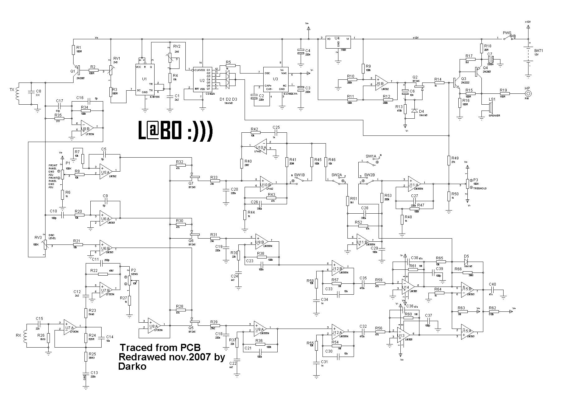

        Sorry, I don't have any photo of Lobo PCB. I had to redrawe schematic from one I found here in forum. My yahoo e-mail is: [email protected].

            If I understand you right, you ask for jpg of Lobo circuit drawing. Here it is.
