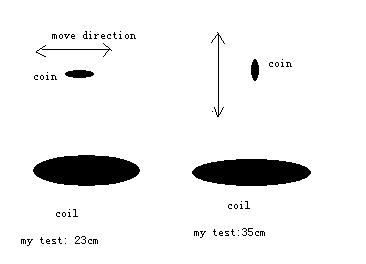

                Hi Ivconic and Max,
                How to test the TGS sense?
                I move up and down,it seems got more deeps,
                and i make the coin upright.it got more deeps too.
                this picture is my test result:
                how do you test the machine?
                Kind regards.

                  Good observations zzy. Results of measurement depends on geometry of targets position in soil and the way of coil motion too. The same in the air test. It depend on how thick lines of EM force decline to main target (e.g. coin) surface. On principle movement of test coin in air imitate coil movement against soil surface, mean that have to be parallel to coils down side surface. But fundamentally every measurement is correct by self and at the same time not correct in comparison to other measurement, when, because of different applied propagation, is not comparable. So, on measurement is very important to give participant all measurement procedure data to overcome subjectivity and to assure that results are comparable (if this is important of course - if not, measurement speaking for itself).

                      Hi zzy,
                      I test like at left side: coin flat vs coil, move left to right or right to left , so orthogonal to normal axis of coil and parallel to windings.
                      I test at each cm if sound or not... then refine to get maximum indication with resolution of 1/2 cm.
                      I use also second method (right side) moving front/back larger objects like coke cans or similar e.g. iron or copper plates.
                      The first method is much like you do when search on soil... sweeping left to right and reverse. The second method is good to understand if device as some inertia or similar... or, in other words, if it's fast or not.
                      The first method is good for small stuff , like coins... cause you can evaluate also the spatial sensitive area in front of coil... like described too in Tesoro's manuals for detectors similar... (bandidoII).
                      The second method is good to test with ferrite too... I use it much for little tests with rods to see how much detector is influenced by "height" variations in "magnetized soil" (emulated by ferrite rod effect).
                      Sure... for depth measures the first, leftmost, method is the one you have to use I think.
                      Kind regards,
                      Max

                        lines described are not like in real coils: fluxlines have maximum coupling with target when it's flat (like on the left of picture) and minimum when it's tilted 90°, so with sharp edge on normal axis.
                        The maximum the surface orthogonal to normal axis and the maximum the flux chained at reasonable distance from coil.
                        You can notice it very easy... just try sweeping a 3cm coin flat and then tilted nearing till detector beeps in both cases: when flat you'll reach maximum performance, so depth on air; when tilted like on the right you'll get minimum effect at far distance (cause flux lines intercept just minimum area on conductive target so current paths are minimum size too, and currents very low).
                        On soil... stuff is different cause also a tilted target could give good signal if e.g. developed (like iron) some "halo" (salts and compounds all around soil matrix near metal). But this happens just spot and not always.
                        Kind regards,
                        Max

                                I sweeping a 3cm coin flat and then tilted nearing till detector beeps in both cases
                                My test result is strange.
                                i use DD coil.
                                when flat, I reach 25cm,
                                when tilted, I reach 27cm,
                                my test shows that
                                so i think WM6 is right.when tilted,the machine gets more deepth.
                                fluxlines have maximum coupling with target when it's tilted 90°.
