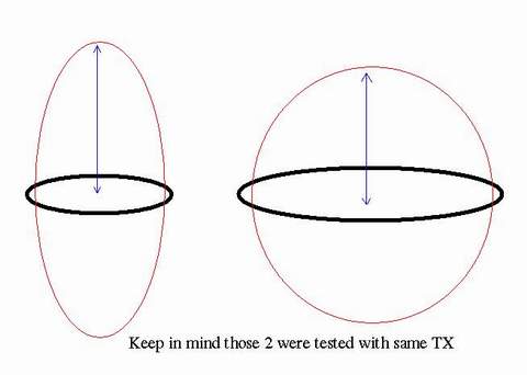

      • What i want to see from your software is; if there is differences in em field shapes at smaller and larger coils. How can i explain this!?
        I could swear smaller diamm. coils do have "sharper" and stronger elipse (like on picture) than larger diamm. coils.

          Yes of course. But it will take some days.
          The reason for good performance on small cc-coils is the following:
          a) Magnetic field strength distribution on small coils are higher compared to bigger coils. So targets induce signals proportional to the magnetic field strength.
          b) Your target is not changing. The caused inductive effects remain almost same compared to the bigger coils (in case of same magnetic field strength distribution). But on the bigger coils you will also have bigger rx-coil, the effects have to cover bigger flux area of the rx coil to be detected. The relation of the target size (thus effects) and the flux area of the rx-coil (covered sensing area) is relevant. Therefore small coils increase the signal-to-noise ratio due to the relation factor.
          c) combination of a) and b) affecting the total result.
          Aziz

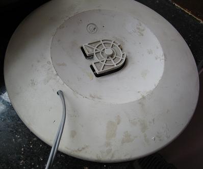

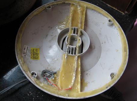

            Thanks for infos.As i said before i used my TGS with a omega coil made for the Magnum, and it worked very well.With my DD coil i could achieve more depth, but not as easy to work with.
            I think size between 22 and 25cm would be great.
            It is also easier to find forms, and CRT monitors supports are great for this purpose:very rigid,looking good , and with separations for the coils that you can fill with resin .Old monitors are easier to find by now .

                  Bingo Aziz. Fully agree: better results in deep of bigger coil are primarily on (usually) bigger RX coil part. Because of this I put on start this CC and Omega section a question about exchange TX and RX coil position, so RX coil on outer position are bigger and according this we can expect better results in deep and worse in pinpointing (challenge to constructor to combine both). DD and OO coil (Nexus chose) are good answer on this, but maybe not a single. Here a big attention have to be paid on Q of both coil too (Q as handy replacement of stronger TX oscillator).

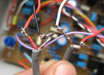

                    • Hi Ivconic,Now,I null the coil at 17mv VPP,the sense is good.
                      but I have another question,please help me.
                      Just like you had said i use two separate coaxials cable. the question is
                      if i tuch the cable,or bend the cable,the machine will beep.it make me crazy.
                          Regards and thanks for your support.
                          Here is my coil and cable.
                          Shouldn't!? Try to adjust GEB trimmer a bit. RX is connected to gnd in coil but not on pcb. Both Al foils are connected togather as well as both cable shields - in coil, but separatelly at pcb, without RX on gnd (as told before).
                          • Using CRT holder for housing - nice! Really do have look and shape!

                              Due fact i dont have another way to test this, i used small em probe to locate em field arround coil. Pretty rough method, but gives me also some "picture" about em field shape and size. And i noticed pretty sharp pike look like eliptical shape arround small 20cm coil.On other hand "soft" and more look like circle shape arround 32cm coil. And size of smaller shape was almost the same as at larger coil. Size or reach of em. Yes this is not quite accurate method, but right now i dont have better method. Zahori can be adjuste at very low sense to do this job - em field probe. Only good imagination is needed to picture em shape and nothing else...
