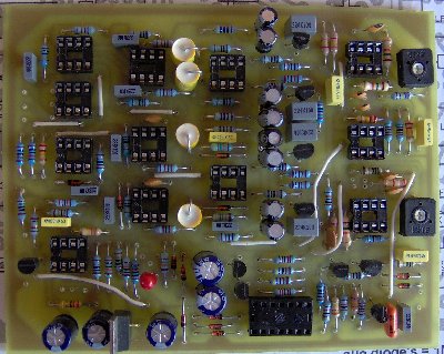

    Thanks Max.
    Yes, my connections were wrong (shame on me), and this means that my coils were tx and rx signal with the coil and of course the foil (WRONG). Now i m shure that the signal is tx and rx the rigth way, and the shield is really working has it was design (shielding).
    I don“t know if i ll have the time to work today on golden sabre, but saturday for shure i ll. Weather for this weekend looks fine, so after i get the 22 cms coil working, i will go outside to make some field test.
    ohh i forgot, when you place a coin close to one side of the coils, is it normal to detect it? i ask this because when i connected the coil the wrong way, all kinds of coins that where close to one side of the coil, were detected and this confirm my idea that the tx signal was radiated by the coil and also the shield.
    Best regards and thanks to all for helpping me to get this nice machine working.
    Nelson

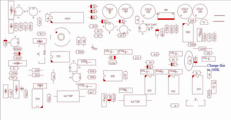

              Nakky, i was thinking on this resistor...
              Also, later add parallel 1M to diode...as KT315 described..
              Regards!

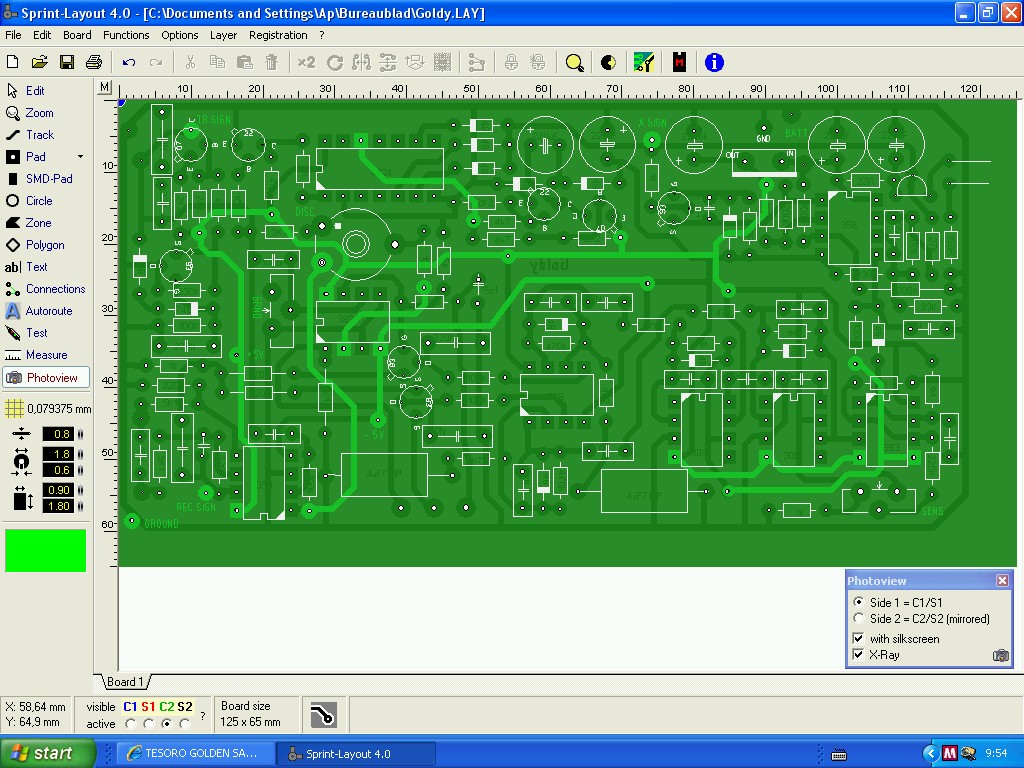

                        • Goldy
                          Hello Frends.
                          Here the sprint layout file from Goldy, if there are errors in it please adjust them and mail it back on this board.
                          Good luck.

                            • Originally posted by ApBerg View Post
                              Hello Frends.
                              Good luck.
                              Hi ApBerg,
                              many thanks, it's really good work.
                              Now I'm making full version. Then maybe I'll do Goldy!
                              Best regards,
                              Max

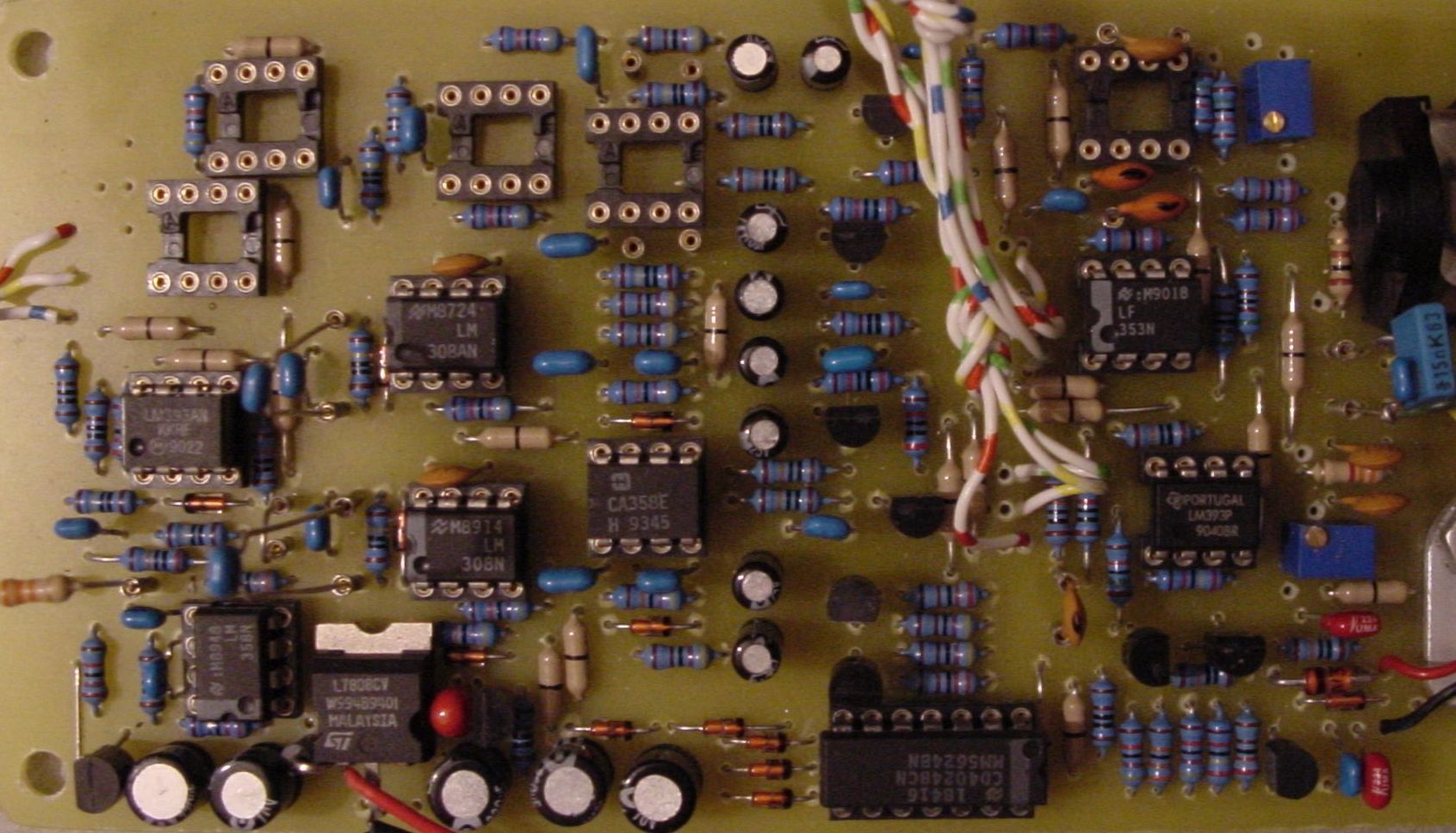

                                I see, at the end we all have success with this nice detector! Bravo!
                                I took my TGS Light outdoor yesterday, to make some serious tests...
                                Results are very good...excellent. Same 1cm nickel coin (i mentioned so
                                many times) it can detect at 27cm in the ground - burried. Very good
                                results. I am very satisfied.
                                Dont want to repeat myself oftenly, so this will be all about testing.
                                Next step:
                                Next step should be serious improvement of audio stage. I dont want to make
                                it only louder. Also dont want to add Zahori audio...
                                I was thinking to find proper way to add vco audio.
                                Have you ever tried Fisher CZ5 or CZ7?
                                Do you know how its audio working? Is it only vco or something more?
                                I have Jackdetect's schematics of CZ5...but it is hand drawing, pretty sloppy.
                                I am not sure how to use it or even can i use it with TGS?
                                Never mind CZ5 audio. I just mentioned it as example.
                                Is there any schematic of audio stage which will allow us to adjust level of
                                signal needed to "open" or "close" audio to produce sound or not?
                                For example,sort of filter or "compressor" with which we can supress or
                                "reject" weak signals with unknown origin and pass only good, known signals
                                to audio stage.
                                I have Troy Shadow X3. Most favorite thing at it (for me) is thing i noticed
                                many times:
                                Let's say it will detect coin at 25cm. Audio is very strong and clear (unlike
                                TGS with weak, mum audio). There is a sort of fast,"double" beep-beep on Troy
                                when coin moved over coil. How can i explain? My english is not so good, i have
                                problems to explain this thing.
                                TGS is working very good, it is so obvious,but main drawback is in audio;same,
                                monotonous,annoying.....I can not be sure whether small or large coin was detected?
                                While with Troy i can distinguish almost for sure about coin size or even alloy
                                according to audio! Of course this need a bit of practice, hours of working with
                                device...same was when i owned 1266. I could "see" detected item with almost 90%
                                accuracy relying on audio. There is something "rich" in that audio, which TGS
                                doesnt have...
                                Also, when earphones are used on TGS; audio is much stronger but "BLUR"...not
                                sharp as on Troy or Fisher...Why?
                                Is there any way,mod,tip,hint so we can improve this at TGS. This should be last
                                step. If we manage this somehow, TGS will turn to one of the best detectors i have
                                been seen so far!
                                I'll wait your opinions.
                                Where is KT315? He is full of suprises, always! C'mon KT315! Save the day!
                                And Sean Goddard...? C'mon Sean!
                                Let's togather make best analogue coin detector ever!
                                We should call it : "Geotech metal detector"!
                                P.S.
                                I was thinking to put 0.01-0.1 coupling capacitors at every supply pin on every ic.
