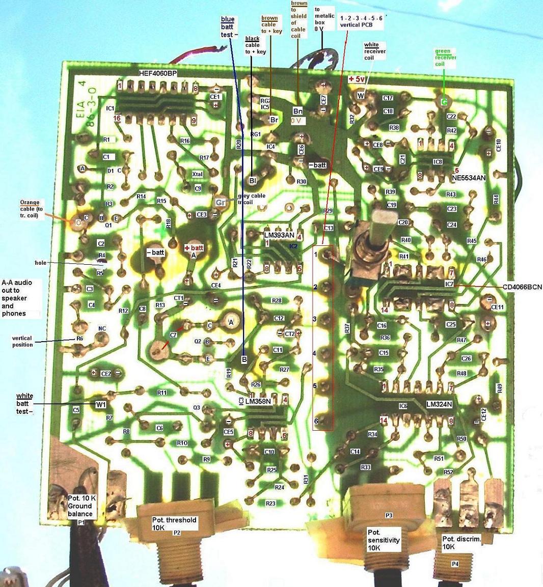

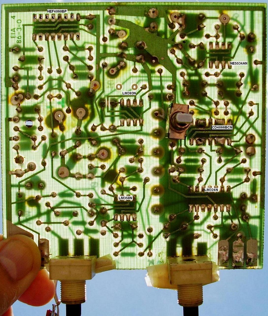

      • I use isopropilic alcohol. Look the Wilson's VLF 710 PCB after cleaning. Ready for to copy.
        Isopropilic is not corrosive as other alcohols.

          Hi what is this detector?
          If its TGS why all pots are 10k?

              • Hi what is this detector?
                Ultimate Haze, is the Wilson VLF 710 and yes, all pots. are of 10 K.

                        Put in AC voltage. You need more turns cause resistivity is lower than 0.25. Can't remember exact number now... but you can find in older posts.
                        Have few time to test at now:
                        for now
                        freq. 14.35 KHz
                        +V 8 volts (regulated by 780
                        -V -6.9 volts (just with 4024 in socket)
                        -V -6.2 volts (with all stuff)
                        Battery checker is working.
                        Found another mistake on schematic: tantalium cap reversed!

                        • Big problem is that I need lot of solvents/chemicals to remove "well" any flux.
                          How do you remove flux ?
                          Best regards,
                          Max
                          For what a lot of solvents/chemicals for a easy solution? Do you want explode when you light your Clint E. cigarr? Simple (now you know and the thanks is real): isopropilic.
                          As I see you don't know how. Maybe you use the alcohol for other purposes, but no for to clean PCBs. When you want to write here and in LRL section, please leave far the alcohol!
