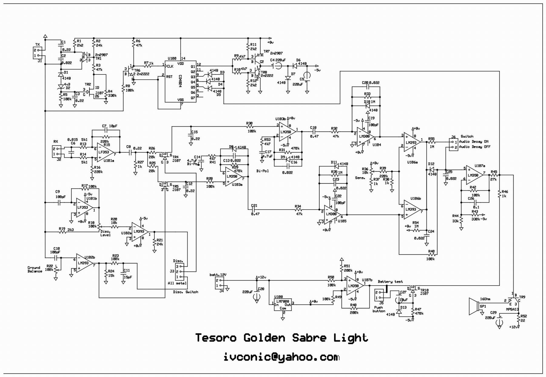

    Hello again -
    Oh hey, did you intentionally leave out the 5k1 resistors next to the bipolar caps on LM358 (-) inputs?
    Thank you for the scoop on coil construction and hook-up. I see what you mean about the OO coil being unwieldy. That would drive me nuts. Again.
    To people wondering about replacing LF353 with TL072: They are almost exactly identical and work the same.
    TL081 may work, and may be cheaper than LM308, but it consumes about 3X times more power - and it won't work any better. Pay now, or pay later.
    Ivconic, you're right about the LM308 being hard to replace. I'll venture that LM308 pioneered and still sports an -almost- unique combination of features. (PMI) Analog Devices copied it with their *obsolete* OP08. Linear Technology now makes the LT1008. Whuuut else is there?
    I have several of (dual) AD706 in SO08 package that -should- work like two LM308 with "custom compensation" built-in. I'll have to wait and see. I've never used a Golden Sabre, and so I won't know the difference anyway. It should be OK.

        • 4k7 resistors Disc and GEBl
          Whoops, I'm sorry I meant the 4k7, (not 5k1) resistors (2x) in the signal channels.
          This ommission will reduce signal gain by about one hundred (depending of frequency of interest). Those two resistors are easy to miss because the original diagram is kind of "busy".
          I forgot about the other LM358. I wouldn't bother you about battery test!

            • Finally FINAL !!!
              Hush, sorry i skipped your questions... Well, about nulling;
              Best way is to use oscilloscope while nulling coils.
              But not necessairly. As you said; good will and milivoltemer
              would do the job just fine. Connect TX coil to oscillator.
              Connect RX coil to m.v.metre...Try to achieve as less as possible
              voltage at RX coil as you can get. Do not worry if you cant achieve
              zero voltage. In most cases it will be impossible. It showed to me
              that even up to 0.1 v coil can be useable,depends of device you are
              using with it. Especially Tesoro G.Sabre is very tolerant. Very good
              soluted at geb and disc stages, lets you to compensate eventual loses
              from coil....Thats why i prefer G.Sabre, easy to make coil for it!
              But most important thing comes after...to glue or whatever, coils in
              housing, so good and stiff to eleminate any eventual movements later.
              Also should stuff housing with some lightly mass....I do not want to
              open this subject here, already all explained in Coils forums....
              Nelson, best way to check is to use IC sockets anywhere you want to
              experiment with different ic's. You are in good position to see
              "in vivo" and experience "live" any differences among ic's.
              Just pay attention on pin assignments...Yes, you may try LM1458 instead
              LF353 for example....or TL082... buyt just for comparsions...
              I am not satisfied with LM1458....but TL082 works almost good as LF353?
              Now back to schematic; Yes! Again i made mistake! I omited those 2 resistors!
              Damn! How it is possible? I guess it was in rush...not so good with software
              for schematics...Thanks Porkluvr a lot again!
              OK, now, for the last time, there is absolute correct and accurate schematic!
              Yes, KT315, you are right. Adding parallel 1M resistor improved audio.
              Now it is loud, and no decays while detected item estranged slowly from coil!
              But i got another idea! I added switch, so we can have extra mode!
              Without 1M resistor included in circuitry audio level is directly dependable
              of signal strenght! There is very noticeable decay dependable of relative
              movements of detected item. For example; as you removing slowly coin away
              from coil surface, inch by inch, audio become more weak, decays respecting
              reach/range. With 1m included, audio remains unchanged.
              This can be very usefull on coinshooting! First we detect coin in Decay OFF
              mode (loud and clear). Than switch Decay On and try to locate coin again.
              Audio level can help us to distinguish about size and depth of detected item!
              Very usefull...isnt it!
              Regards!

                Hi guys,
                unregistered and nelson...
                well I think you could use TLC2262 if you can find ! I found them very good and stable, little noise, little consumption , very good dual op amps for metal detectors. They are in bandido circuit as you can see. Use them instead of lf353. You could use also:
                ts272
                ts27m2
                ts27L2
                tlc2252
                tlv2262
                If can't find one of the above use (but take care on consumption) :
                ne5532 (good noise figure but 6ma consumption)
                lm358 (but is noisy)
                NELSON tl071 is a single op amp, you maybe mean tl072. Also tl082 could be
                used but you could have trouble with a bit of noise there.
                For LM308 I suggest (but hard to find):
                NTE398
                or easy to find the LF356/LF357 but consider that you don't need the capacitor at pin 8 anymore. You could leave them in ciurcuit cause LF356's pin 8 is not connected internally.
                Best regards,
                Max

                  Hi ivconic,
                  really nice work. I've tested mc1458 many times also on bandido I've made...with lot of troubles.
                  Now I've realized that these ICs are not so good for metal detectors like these from tesoro. I found that even lm358 is much better than 1458. I've much troubles with low voltage working of these devices: they suffer of erratic working at lower voltages.
                  Audio solution seems a really good idea! And also simple to be done.
                  I've found some good coins with bandido so far...but I'm considering building your GS mod.
                  Best regards,
                  Max
                  • TL082
                    Hi Max and Ivconic, and thanks both of you for replacement information.
                    Unfortunely can´t get that LM308 here. So i ll replace it with TL082 and see what´s going on.
                    Ivconic, th ehole pcb is build considering ICs base on it. I agree, that is a good way to test diferents alternatives on components.
                    Nelson

                    • AGGHH
                      To whom it concerns:
                      Sponsored by: The number two, (2)
                      It is not recommend that you plug a dual opamp into a single opamp socket. If you have questions about whether or not you can use a particular device as a substitute, it is incumbent upon you to check the device's function and pinout! You can learn a lot from browsing manufacturers data sheets at:

                        Hi Nelson,
                        plvr is right on single op amp...use lf356 or lf357 instead of LM308 and you would be ok. Use tl082 or others to replace lf353 that are dual.
                        Best regards,
                        Max
