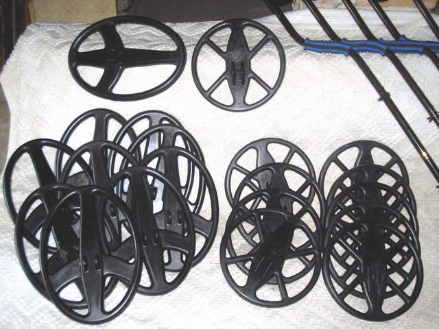

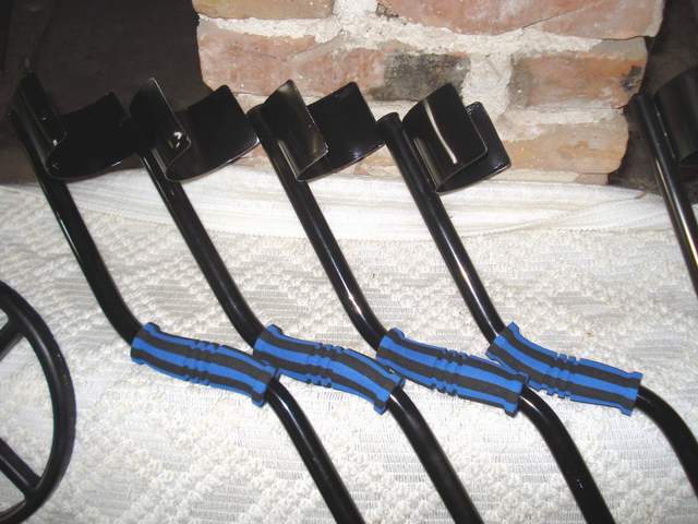

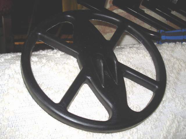

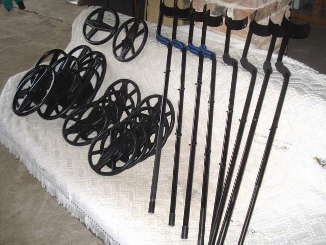

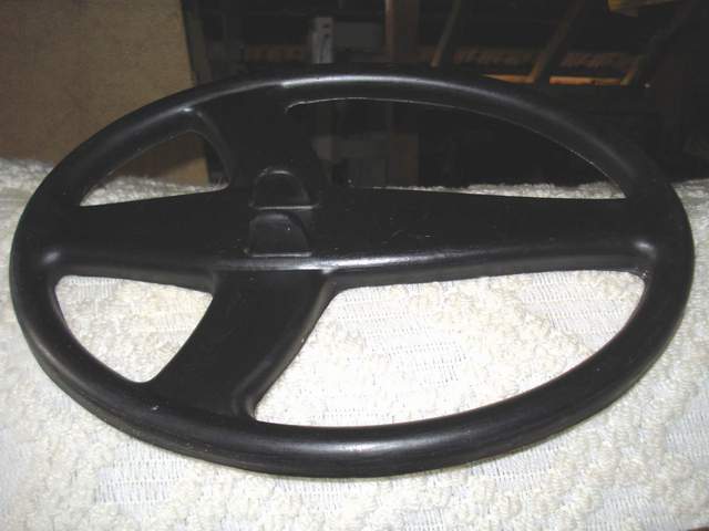

      Finally i got it! I have something to show up with!
      These are prepared for TGSL's i am finishing now.
      Notice; all of those are copies from originals.
      Shaft copied from Troy Shadow shaft but a bit changed,
      27cm coil copied from famous Bulgarian coil housing and
      Eliptical copied from Garrett GTI Eliptical coil - very nice
      housing and hopefully powerfull coil would be!?
      Nice work, isnt it?
      Only detector housings not prepared yet....Sheesh!
      • more...
        • and more...
          • and more 2
            • and no more
              • Bravo Max!
                Bravo Max! Good job!
                But i dont see Faraday cage there? What are you planing to apply?
                Al foil or something other?
                Regards!
                  Regards!
                  Hi Ivconic,
                  yes you don't see it cause there isn't at now. It's a test for new numbers turns and alignment.
                  Of course is needed for the field use. At the moment I'm playing just on test bench with these... (at least for now)... that's why also I need not to waste too much time on these.
                  Last time I've used mylar/al to shield coils and worked pretty good... last OO12 is really nice with bandidoII but noticed that not so good also with TGS, and don't know why, so I'm doing this experimentation.
                  BTW you have done very nice work with TGSL housings/pole etc, really nice.
                  Have you find the LM308 ? Nelson provided a website that sell for 0.59$ each that's interesting price for consistent number of ic.
                  Kind regards,
                  Max

                    • Hi Ivconic,
                      Where do get your detector shafts and coil housings from?
                      • From local craftsman, i had difficulties to persuade 2 of them to make me those! One is already making TV antennas, sort of small bussiness, dealing a lot with Al pipes all sizes. Other is "plastician", making things from plastic....
                        But since i had not enough money, i oredered small series (10 shafts and 20 coil housings) so they hardly accepted to work on this.
                        With a lot of effort...nervs...finally i got it!
                        Next time i will be pushed to order at least 100 pieces if want to be done!? Sort of blackmale! But thats life...
                        Regards!

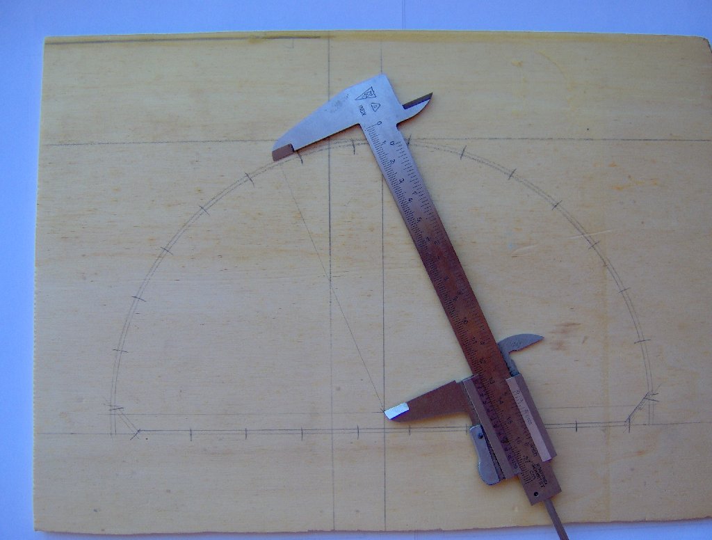

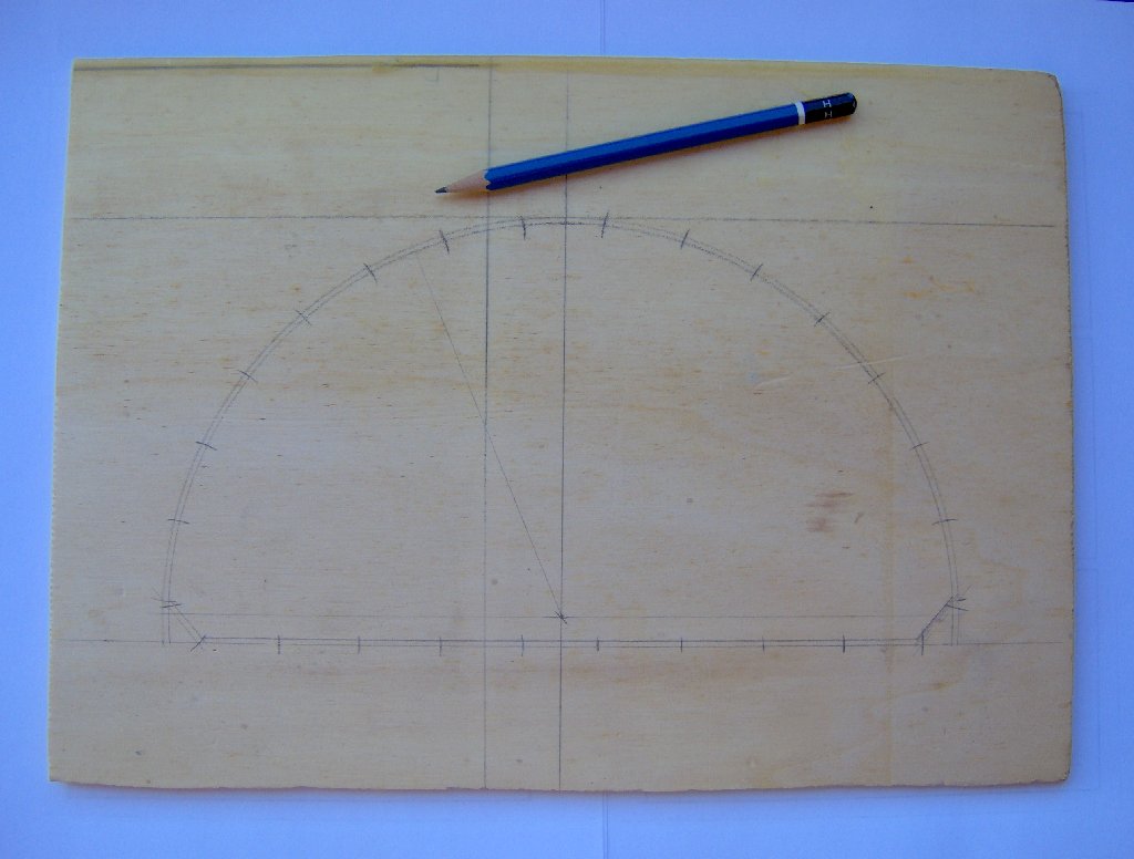

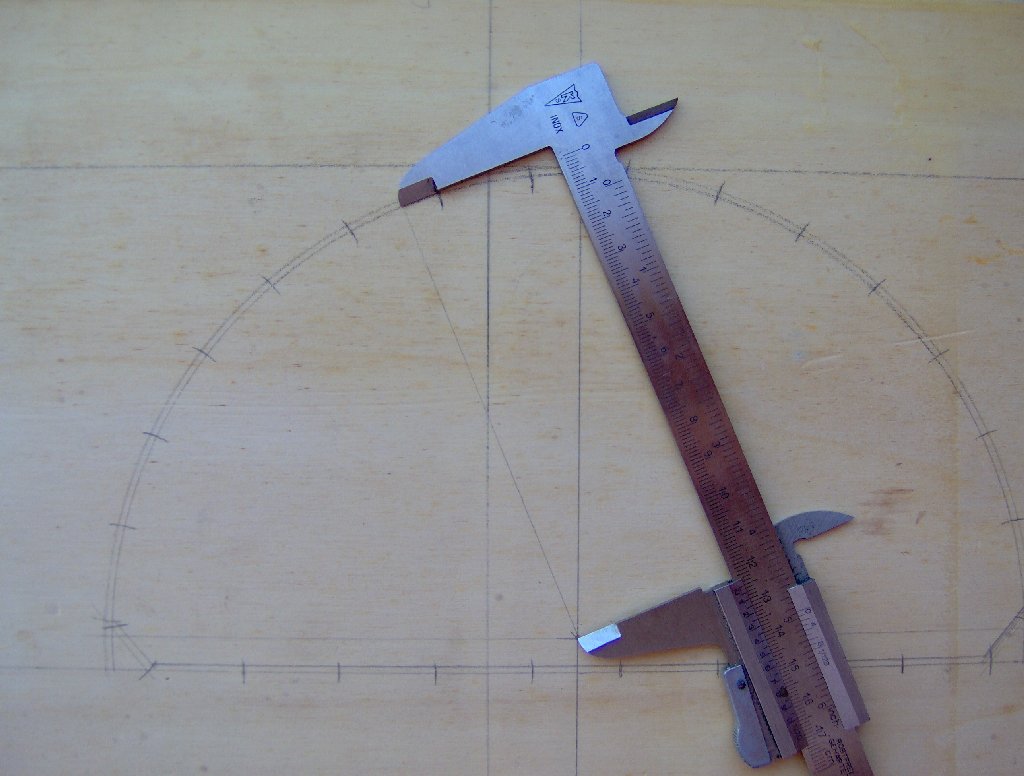

                              • Ivconic's 255x137mm DD
                                I've started building this ...at first for test inductance but then I decided made the whole tx-rx pair...even if I haven't a suitable coil housing at the moment... anyway...
                                think maybe some picture could help someone that need to match that model of DD.
                                Last 2 pictures are related to shield material: comparision between mylar-al strip and al-kitchen roll piece. Mylar-shine but is too difficault to obtain and also wound... so I haven't decided yet what to use in this coil.
                                A picture is better than 1000 words ?
                                Kind regards,
                                Max
