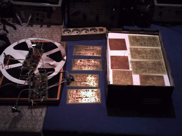

                              • More pain for me....
                                I experimented a lot last few days with TGSL...Bad news is
                                that i was wrong about replacing LM308 with TL081!
                                TL081 is working but not that good as LM308?
                                First time i tried that, was in hurry so i havent noticed
                                differences. Now, when serious tests performed i am sure
                                that LM308 is hard to replace.....or...maybe there is good
                                way to replace it but TL081 is not best choice.
                                Earlier it was piece of cake to null coill and gain very good
                                results when LM308 was on pcb and device was used to null coil.
                                Now it is almost impossible to gain good results and null coil
                                when TL081 is put on pcb instead LM308??? I gain less distances on
                                nickel coin and sound is "broken" when reach detection limit..
                                I tried to achieve good results for over the 2 hours without
                                success...!? Everything else remained same except those 2 TL081...
                                I omitted those picofarads on 8. pin of LM308, of course,TL081
                                not need those...
                                So...feel like on begining again!?
                                Havent try to change values of surrounding caps and resistors...
                                Must be other way to achieve good results without LM308?
                                With a lot of help from my friends i prepared 4 types of pcbs for
                                TGSL....even one smd!
                                Other people draw those pcb's so i am not allowed to post those.
                                If original designers want to post their draws than let them do that.
                                I am not post neither one cose simply dont have right to do that...
                                There is 12x6cm TGSL onesided from my dear Dutch friend, 6x6 from one
                                Russian brother and small smd from another good friend of mine...
                                Also very nice coil housings in prepare...Soon to come and post photos
                                here...
                                On posted photo there are wounding bodies for two coil sizes;
                                one is for DD 190mm x 107mm and other 255mmx155mm...
                                I done some experiments using 0.20mm wire (0.22mm with varnish)..
                                Body 190mmx107mm;
                                130 turns=6.4mH =22ohms
                                125 turns=6.0mH =21ohms
                                123 turns=5.8mH =20.6ohms constrained=6.21mH
                                121 turns=5.72mH =20ohms
                                120 turns=5.57mH =20.1ohms gives frequency 14.9kHz
                                117 turns=5.38mH =19.6ohms constrained=5.73mH
                                Body 255mmx155mm;
                                95 turns=5.07mH=20.1ohms gives frequency 16.18kHz
                                Wire gauge affect inductance and frequency of course, so it is
                                obvious that i should use thicker wire to gain proper number of turns,
                                inductance and needed frequency. Wire should be 0.25mm to 0.28mm...
                                Since 16.18kHz is a way to high (we need 14kHz) i should wound more
                                turns, but it would raise resistance of coil to some 28-30 ohms...
                                Not good, so if i use thicker wire, all will come on right place.
                                Resistance will stay between 19-23ohms, inductance will be closer to
                                6-6.5mH and frequency will lower a bit, just arround 14kHz....
                                Problem is i left out of wire!?
                                #$^@%^&^!!! I have to wait few days
                                to find proper one...
                                Only one problem left to be solved; LM308...It is not impossible to find it,
                                i can...But i am curious to find proper replacement...That's me!
                                Regards!
