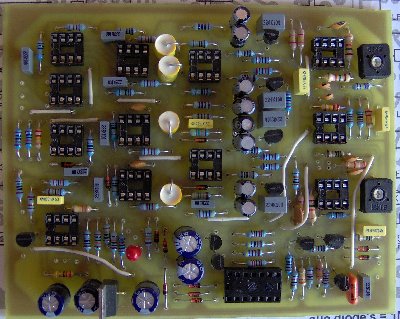

        • Hi,
          yes TGS exist... I've already posted here the PCB assembly, but I repost it again for skeptics
          About great performances they are related to BandidoII not TGS. TGS is still prototype no good case , no good tuning, lot of work to do...no real tuning on it , just few tests.
          And about 12cm OO coil it exist too... but I've no need of posting here anything of my work.
          Why if e.g. Esteban don't want to post his schematic here , I have to post here pictures of my coils ?
          To give him some funny argumentation on my coil ?
          My coils are nothing special, but they work. That's all.
          I've posted in the past cause someone asked me of posting round 8'' before sealing... if remember well I've done. Find it.
          DD22 was already sealed at that time and I haven't pictures of the inside woundings.
          BTW I have also some mods on bandidoII circuitry. Why I have to show you ?
          Now that this is your stupid game I say that:
          use your hands and build yourself both BandidoII and coil, and see with your eyes. You have all data you need here and in other threads.
          Many folks here have made what I've too, some first of me (PCB, coils) some after me. All with good results.
          These are not things from my imagination, but FACTS.
          Kind regards,
          Max
            I'm not interested in the schematics, but I was interested to actually see a photo of your TGS. Anyway, you said earlier that your friends were so impressed that they all wanted one. So it thought it must be worth a look.
            Also, how about some pics of the coils you have made, particularly the 12cm OO?
            My friends were impressed by BandidoII-clone not TGS.
            Already answered to you.

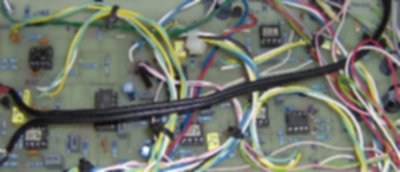

            • Hi,
              here are just 2 pictures/part of it... low res
              it's BandidoII-clone using Gary's 1st PCB design.
              Other parts or higher res or OO coil I'll never show here.
              So think what you want!
              Kind regards,
              Max

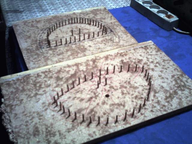

                With a lot of help from my friends i prepared 4 types of pcbs for
                TGSL....even one smd!
                Other people draw those pcb's so i am not allowed to post those.
                If original designers want to post their draws than let them do that.
                I am not post neither one cose simply dont have right to do that...
                There is 12x6cm TGSL onesided from my dear Dutch friend, 6x6 from one
                Russian brother and small smd from another good friend of mine...
                Also very nice coil housings in prepare...Soon to come and post photos
                here...
                On posted photo there are wounding bodies for two coil sizes;
                one is for DD 190mm x 107mm and other 255mmx155mm...
                I done some experiments using 0.20mm wire (0.22mm with varnish)..
                Body 190mmx107mm;
                130 turns=6.4mH =22ohms
                125 turns=6.0mH =21ohms
                123 turns=5.8mH =20.6ohms constrained=6.21mH
                121 turns=5.72mH =20ohms
                120 turns=5.57mH =20.1ohms gives frequency 14.9kHz
                117 turns=5.38mH =19.6ohms constrained=5.73mH
                Body 255mmx155mm;
                95 turns=5.07mH=20.1ohms gives frequency 16.18kHz
                Wire gauge affect inductance and frequency of course, so it is
                obvious that i should use thicker wire to gain proper number of turns,
                inductance and needed frequency. Wire should be 0.25mm to 0.28mm...
                Since 16.18kHz is a way to high (we need 14kHz) i should wound more
                turns, but it would raise resistance of coil to some 28-30 ohms...
                Not good, so if i use thicker wire, all will come on right place.
                Resistance will stay between 19-23ohms, inductance will be closer to
                6-6.5mH and frequency will lower a bit, just arround 14kHz....
                Problem is i left out of wire!? #$^@%^&^!!! I have to wait few days
                to find proper one...
                Only one problem left to be solved; LM308...It is not impossible to find it,
                i can...But i am curious to find proper replacement...That's me!
                Regards!

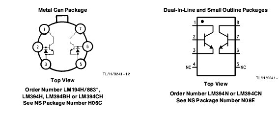

                • Originally posted by J_Player View Post
                  Hi Ivconic,
                  The TL081 is considered a general purpose op amp, while the LM324 is a high end op amp with better precision and temp compensation etc. If you find your circuit works better with the LM324, there are even better op amps you can use instead of the LM324. Try reading this: http://thunting.com/geotech/forums/s...ad.php?t=13407
                  Bese wishes,
                  J_P
                  you have lot of confusion about op. amps.
                  Let's correct:
                  LM324 is obsolete quad op. amp. ; No good there.
                  about the link you provided...
                  the LM394 are junction isolated ultra well-matched monolithic NPN transistor pairs with an order of magnitude improvement...
                  so matched pairs NPN, not an op. amp.
                  Kind regards,
                  Max
                  • Hi Max,
                    There is some confusion because I pasted the wrong LM number. Ivconic was talking about LM308, not LM324.
                    The fact is the LM308 is considered a better op amp. It's a precision op amp with specifications a factor of 10 better than FET amps over the same temperature ranges. I would not expect the general purpose TL081 to perform as well. But the real test is in the circuit.
                    My opinion is it is worthwhile to spend a little extra money for precision components when they are performing critical functions where an improved overall performance is demonstrated. I wouldn't be concerned if some people call these obsolete. They are readily available in most of the world. Of course, there is nothing wrong with continuing to use the TL081 if that is your preference.
                    Best wishes,
                    J_P

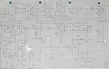

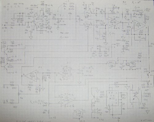

                            • Schematics for Esteban...and other "skeptics"
                              Hi all,
                              cause someone here maybe think I've never realized an original schematic by my hands...
                              I post these two of my designs about PI detectors:
                              - 1st one is a simple PI that detected in ground 1eur coin at 37cm with a 20cm diameter monocoil, it detects gold too, can use on beach
                              It's simple and remember somehow underwater detectors.
                              - 2nd one is just a sheet (of many) of a very more complex PI detector with lot of features VCO/no-VCO etc etc, also this I've made myself and works really good
                              Handdrawn.
                              Of course... low-res pictures !
                              Esteban I don't need your schematics... I made myself.
                              Difference is that my designs work !
                              Kind regards,
                              Max
