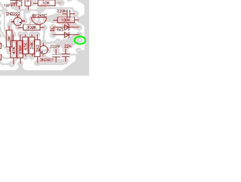

      You mean green circle!Right?
      I use only red lead of multimeter.Black is leaved a side.
      And it shows 28,.. kHz.
      Did you remember 2N2222?
      Could this be the same?
      Please check the numbers again!I see:11,4;12,5;12,75;13,35;13,7 and 1,6cm~!~~~
            tiktak,
            Red lead from multimeter is to point Max shows is correct to measure Tx Freq, but you need also to connect black lead to ground (battery negative) on TGS pcb. This is basic measurement pricipal, measurement with reference to ground.
            Molzar

              Molzar.
              So this should be.
              But I remember that I have asked someone and have remember as a basic principal that I should use only Red and just leve bleck a side.Its looked strange to me but.
              Thanks.I will rechek soon.
                Molzar.
                So this should be.
                Molzar told you... use that black wire... connect it to gnd and the red one to the collector of the PNP transistor at point #1.
                You should read the right frequency.

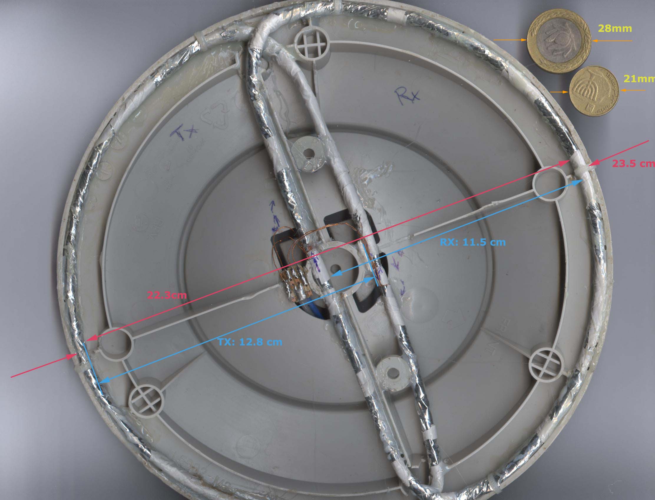

                            I'v just finished my First DD coil but i'm not sure about the it. 2cm coin could be detected at 25cm in air and 2.8cm at 30cm. What could be expected for the showing coins in the picture. Can you advise please.
                            Hardi
                            23.5 DD coil

                              Hi Max,
                              Hardi
                              23.5 DD coil
                              it's not bad result for a smaller DD coil that standard Ivconic's design. I think there's room for some improvement on circuit an eventually nulling.
                              Have you nulled at 15mVpp or less ? What about wire, is 30AWG ?
                              I think you can experiment with some nF more or less at RX coil to see if get an increase in the range (probably you'll get that way).
                              What about disc ? Does it disc out iron completely in disc mode ?
