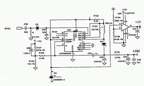

                          • ... This is from White's Spectrum ps.
                            You have here sync input.
                            Power...i am not sure, i will search for any data, but if it can supply Spectrum - it can supply any other descent "consumer" too, i guess.
                            Cheers!
                            • "...The device can drive external NPN or PNP transistors when currents in excess of 1.5A or voltages in excess of 40V are required...."
                              Yup!
                                Cheers!
                                Thanks for reference looks good. Looks like they put a sync pulse into the capacitor timing input -- hey, if it works... This chip needs external coil "buck-boost" type looks like, 300uH not to big I guess, but other 7660 just need capacitors. Usually type with coil higher efficiency though I think.
