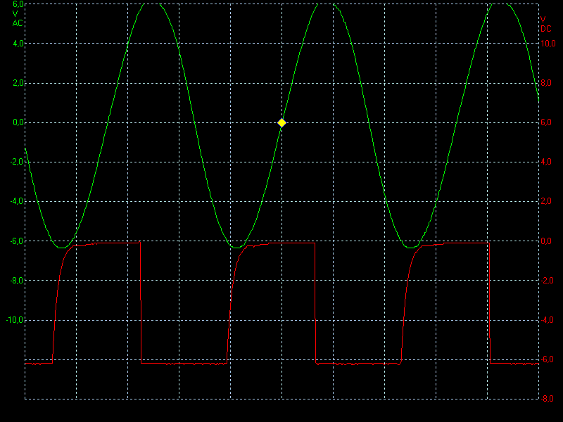

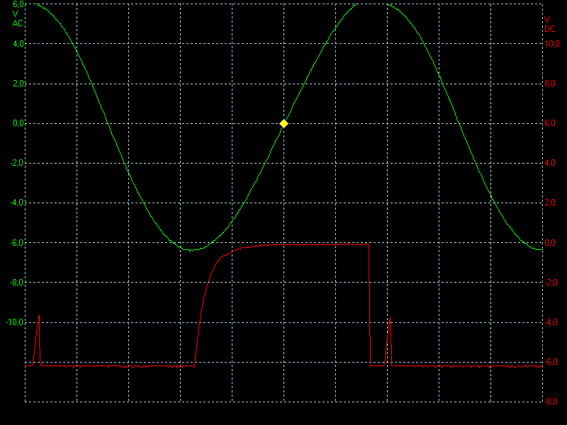

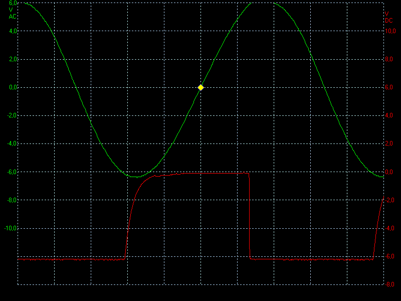

                  • Originally posted by habitbraker View Post
                    will it help if I post some pictures of mine waveforms? Working nice - 30cm with good signal
                    It would be useful to see three photos of the Tx signal (J1-1) compared to the DISC sync pulse (LM393 U102 pin 1) :
                    1. With DISC pot at minimum setting.
                    2. With DISC pot at middle setting.
                    3. With DISC pot at maximum setting.
                    Thanks if possible!
                    -SB

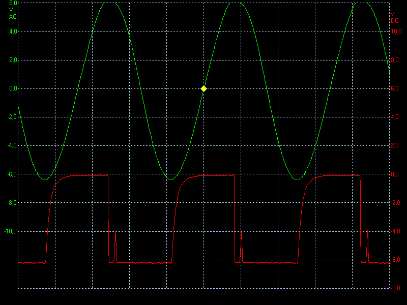

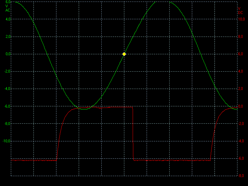

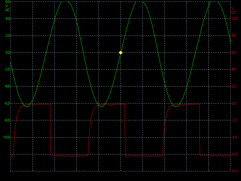

                        You got it. In your asked sequence. Both traces 5V/div
                          Thanks!
                          Your sync pulse seems to shift about 80 deg or so, which is fine. I notice that at both ends of the pot range it breaks up, which is normal for TGSL design, same as I observed with dfbowers model that he sent me (which works very well).
                          Hopefully Dennis the Mennis can post equivalent video/photos so we can compare his sync pulse to his Tx signal and confirm if his DISC circuit is similar.
                          -SB

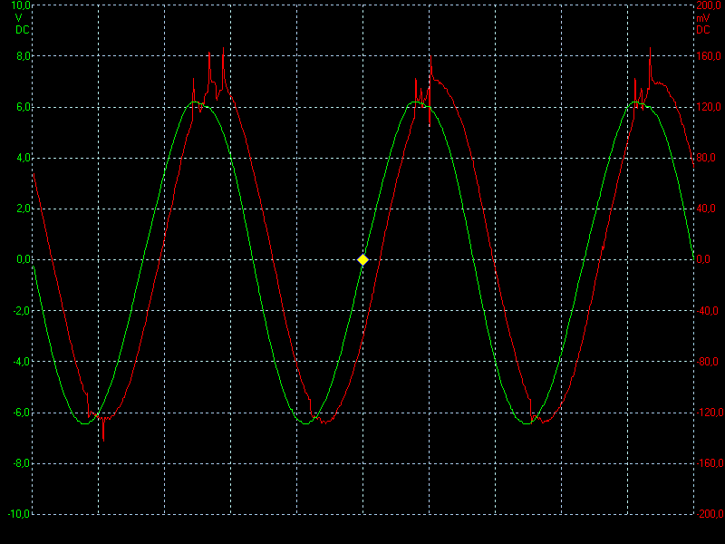

                            Hallo Danny,
                            Think you have not a good receive signal, tray to adjust it with the 'receive cap' .
                            Make a 'Receive Cap' test circuit and see how the receive signal changes...

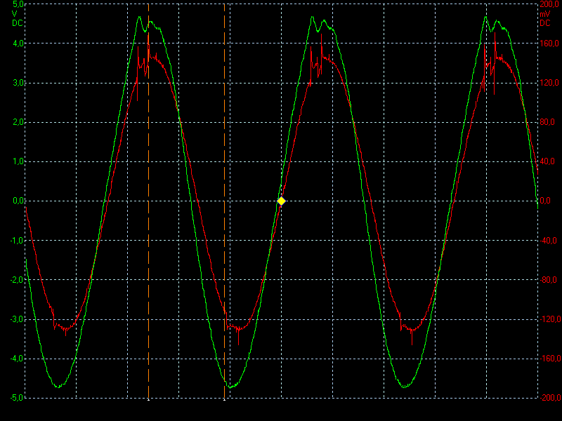

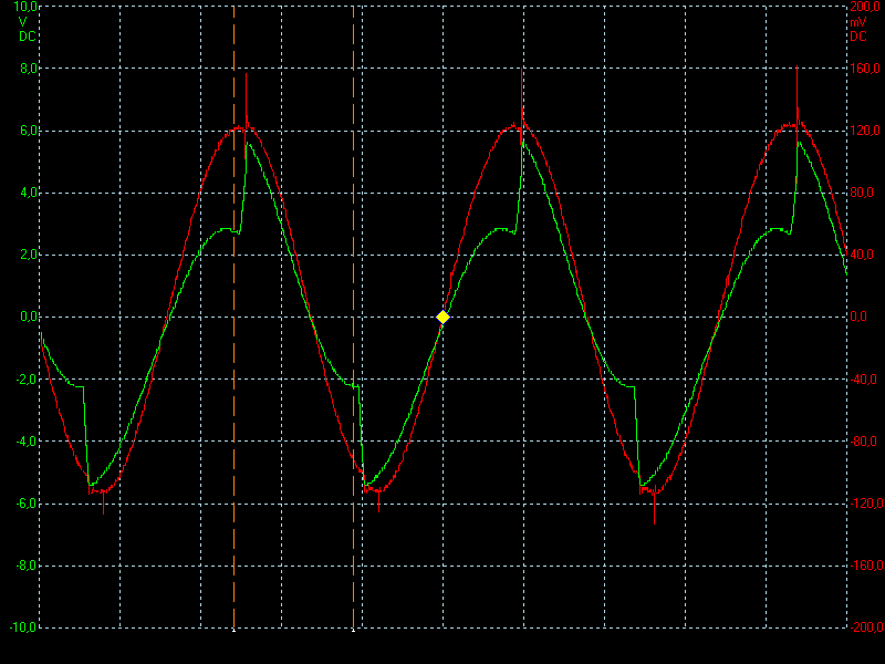

                            Hi Ap,
                            Perhaps a little late ,
                            I've tried to adjust C9 , the cap. before input LF353 U101b pin 2, to get rid of those spikes on Rx signal , see next image ( Rx output LF353 pin 7 vs Tx )
Name:	C9 spike Tx  Rx.gif
                            and there are some improvements on the output of the LF353 pin 1 :

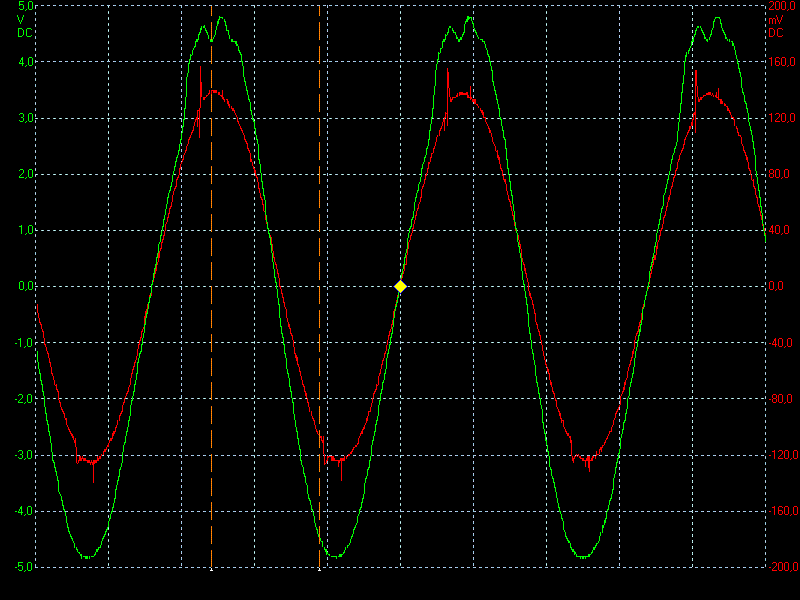

                            Next picture I've installed 180 pF for C9 : output LF353 pin7 vs output LF353 pin1
                            It seems that I accidentally posted an animated GIF , looks good , I'll keep it in mind ...
Name:	C9 180 pF LF353 pin1 + 7.gif
                            100 pF for C9 : output LF353 pin7 vs output LF353 pin1
Name:	C9 100 pF LF353 pin1 + 7.gif
                            and 68 pF for C9 : output LF353 pin7 vs output LF353 pin1
Name:	C9 68pF LF353 pin1 + 7.gif
                            Allthough there could be an improvement in signal ( the spikes become smaller and / or shifts a little ) for my pcb , I can't get a better or worse detection.
                            The DISC sync pulse stays the same no matter the value of the cap ,BUT only at the beginning and/ or the end of the DISC shift there could be a spike that is influenced by these caps !
                            The spikes like Habitbraker posted in his last post :
                            http://www.geotech1.com/forums/showp...postcount=4575
                            It seems that this part of the circuit is pretty forgiving ...
                            Originally Posted by simonbaker
                            Quite excellent DtM! Nice way to show your new scope.
                            I'm interested also in the LF353 output that drives the sync pulse, what does it look like?
                            I get those little spikes on the RX signal also. I suspect it is caused by the negative power rail circuitry, but not sure
                            It looks like that the spikes on the Rx signal , only visible with very low residual voltage, are 'generated' internally in the LF 353 , at least they influence each other pretty good .
                            In the posted images I've set the rulers on the spikes : the spikes appear on the exact same places .
                            Also when nulling the coils , both spikes stay on the same place despite the shift.
                            This was just a small observation , perhaps it was told a dozen times in these threads.
                            kind regards ,
                            Dennis the Mennis
                              Thanks!
                              -SB
                              Hi Simon ,
                              These are my settings for the DISC sync pulse vs Tx :
                              Yes , I was confused while posting the DISC vs Rx , I've had in mind that the Rx was sampled , but as I understand that is not for sure (?) .
                              DISC potmeter 0% :
                              and
Name:	DISC 0% b.gif
                              DISC potmeter at 50% :
                              and
Name:	DISC 50% b.gif
                              DISC potmeter at 100% :
                              and
Name:	DISC 100% b.gif
                              Also here a little spike as described in previous post : most likely cause C9 ( in my case anyway) .
                              It seems that the shift of Habitbrakers pcb is a little more shifted to the right and if it works for him I'll have to 'tune' my Rx a little so I can get some discrimination .
                              It would be helpful to do the same video of the DISC sync pulse compared to the Tx signal (because we all have different Rx null signals, so difficult to compare).
                              Cheers,
                              -SB
