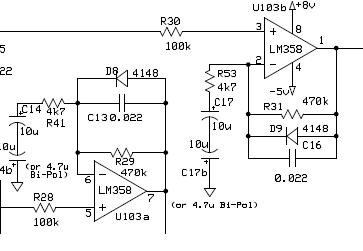

      Just to sort out the difference, I replaced R29, R31, C14 and C17 on Eduaros's version with values equivalant to the what is shown below without changing any other settings.
      Sure enough, that was it.
      Now, I was wondering, with all the discussion that we have had on the forum about the bandpass stage around U103 if someone could do a spice simulation (if you still have one setup and handy) of the overall frequency response of the TGSL if R29 and R31 were changed to 1M and C14 and C17 were changed to a total value of 11uF.
      I don't want to be too hasty to draw conclusions. but a simulation might help to validate my observations.

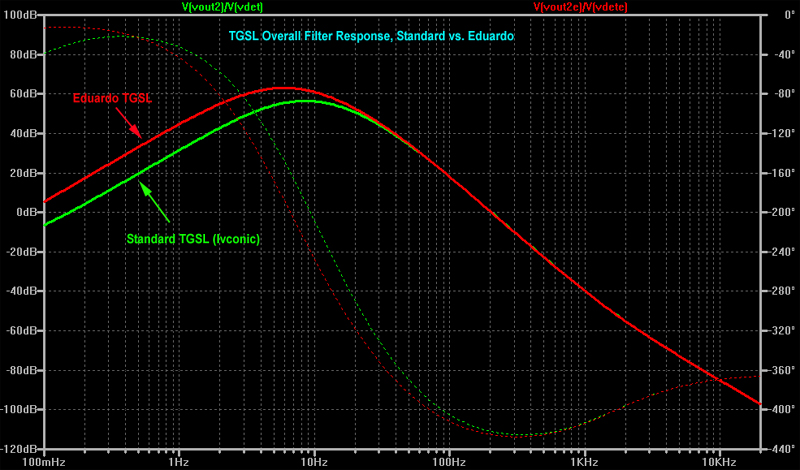

        • TGSL Overall Response, Standard Vs. Eduardo
          I have noticed a few characteristics that set Eduardo's version of the TGSL apart from Ivconic's:
          1. Improved audio with external speaker
          2. Slight improvement in sensitivity.
          3. Change in sweep speed required for optimum searching.
          The first two were already mentioned in previous post, but #3 above is another observation that I have made over the last few days of experimenting. I'm basing statements on 2 builds of Ivconic's version and 2 builds of Eduardo's version.
          On the bench, I have noticed that Eduardo's version can respond to very slow motion of targets over the coil - significantly slower than what is required for Ivconic's version.
          On the other hand, I have noticed that I can loose targets in my test garden if the coil is swept too fast. This is not quite as evident with Ivconic's version. In order to locate some buried targets, I had to carefully limit my sweep speed with Eduardo's version.
          I don't consider Eduardo's version to have any problems but understanding the differences enhance getting the most from both.
          Don
          Just happen to have a sim here in my hip pocket...
          You observations are in line with what I would expect -- slower filter section (lower center frequency) should do all those things. Eduardo's mods make a filter centered at about 6 Hz while standard TGS filter centers at about 9 Hz (if my sim is accurate). Eduardo's overall gain is also about 7 dB higher also, which may or may not be desirable.
          For laughs I once built a TGSL centered at about 1 Hz I recall -- out-of-control! But had greater depth, at penalty of much slower sweep speed and crazy lag to the beep after passing target.
          Response is an interesting variable to play with -- one of my goals is to build a TGSL with user-selectable response (slow, medium, fast, etc). Digital processing is probably the most sane way to develop it.
          I have long felt that the original TGS was designed for smaller coils and faster response (to help pinpointing and easier feel), depth not so important. Since most people here seem to favor depth, larger coil and slower response seems a natural choice.
          I'm interested in more of your field experience on how useful a slower response really is, and what you think the sweet spot response should be.
          -SB
          Last edited by simonbaker; 06-30-2011, 03:49 PM. Reason: Mistake in LTSPice resistor value, redid simulation
          • Thanks Simon.. I always knew that you had deep pockets!
            Your graph didn't look like much at first glance but then I realized that it's a log scale.
            By your sim, that should show the need to slow down sweep speed to about 3/4 of what is normally needed. It might even be a bit slower that that in actual use but I guess it depends upon your searching habits. Again, I think that this circuit is very useful but there is a need to know where the optimium sweep speed is to take advantage of the extra gain.
            On a side note, one other undesireable thing that I came across is that in the A.M. mode, this versions seems to be a little unstable, even at reduced sensitivity settings. Getting away from noise sources helps a lot though.
            Don

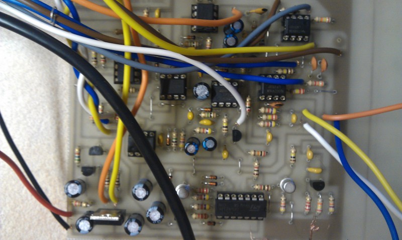

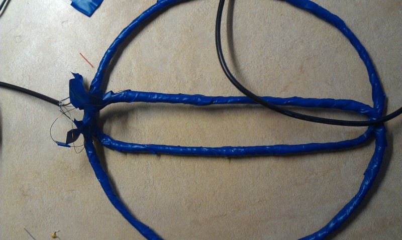

                          • Hello there again i am novice in electronics and i don't know why i started with project like that so there is no surprise that my detector is still not working
                            i made coils from 0,3mm cu and inductance for RX is 6,45 and 5,9 for TX using usb2 cable to connect coils with circuit there is gap about 10mm in both coils. When i turn my tgsl on it make no sound at all only little noise on power up.
                            When i tried to change RX connection on circuit i made some noise and burned out resistor 22 Ohm's near power supply i changed it and same situation again. I am testing circuit without changes where changed resistor from 22 to 100
                            Now i am wondering where is my problem any thought to share with me to get my project done?
                            i still waiting for oscilloscope to arrive for balancing/nulling but i guess it still should work without balancing but with ugly performance?

                              Manure spreading guy, go back and flip the board over, get a good magnifier, and look for solder bridges etc. Then check orientation of transistors and ics. Make sure you have a good power supply and getting good regulation. This is a process of elimination. It would help to have a freq. counter to see if transmitter is working.
                              • Originally posted by Wiltran View Post
                                Check to see if you have -5v (could be as high as -6.2) . That will tell you whether or not your oscillator is working.
