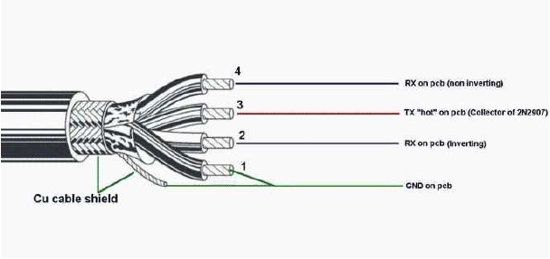

          • Can someone explain this to me?
            I do not understand!
            What does this mean?
            rx on pcb inverting and (non inverting)
            how do I get contacts?
            • I tried several times last night to load both your image of the cable end and the TGSL schematic into GIMP and draw in the connections you asked about. However my skills in that department are lacking so I gave it up.
              Here are the connections you were asking about:
              The numbers referenced numbers on your picture correspond to the pin numbers of the coil connector that mounts on the detector. They are arbitrary and apply to only one type of connector, however the written information to the right of the numbers is not and does tell you were to make the connections.
              Pin 1: Gets routed through the connector to the PCB ground.
              Pin 2: Gets routed to J2 pin 2 of the RX connector on the schematic, which connects to the R13 side of C6. R13 connects to the - (inverted) input.
              Pin 3: Gets routed to J1-1 of the Tx connector on the schematic.
              Pin 4: Gets routed to the other connector of J2 on the schematic. This is connected to the R14 side of C6 which also connects to the + (Non-inverting) input.
              So to sum up all the pin numbers, it would look like this:
              Cable Pin No. Schematic pin no.
              1 PCB ground
              2 J2 pin 2
              3 J1 pin 1
              4 J2 pin 1
              A simple picture would have made this a lot more plain but I hope this helps answer you question.
              Jerry
              BTW: I made the assumption that you are talking about the TGSL. The above pertains to that.
              • ok !
                thanks a lot
                I was confused
                once again thanks
