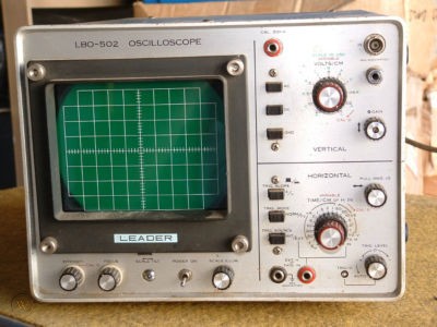

                            • Does this scope help me????
                              • It is better than No scope.
                                A dual channel scope is greatly desired so that you can compare two signals.
                                This is what is needed to adjust coil null and phase. One trace shows the TX waveform and the second the RX waveform. Then you can see the amplitude and phase relationship between the two signals.
