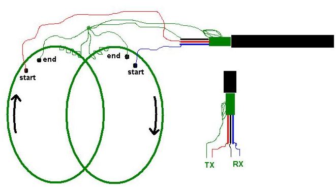

    • Thanks,guys
      is it possible?
      the coil should be two identical circles,not two D
      like the picture I put

          • Originally posted by mostafalesnar91 View Post
            Thanks,guys
            is it possible?
            You can have 2 D's or 2 circles or even 2 squares if you wish. The principle is the same. Balancing is achieved by overlap method.
            In the concentric coplanar type coil, balancing is achieved by means of a feedback coil commonly referred to as a buck coil
            So there are essentially two kinds of coils based on how the nulling of the RX coil with respect to the TX coil is achieved. Namely 1 overlap method, and 2 feedback method.
            There is also a coil known as an Omega coil. But it is still a coil using overlap method for nulling.
            Just because you can make any shape doesn't mean that you should. The optimum or best shape for overlap method of coil is the soft 2D shape. I recommend you make this coil for tgsl.
            • You can have 2 D's or 2 circles or even 2 squares if you wish.
              sorry Delta Banner i must reminder that Tesoro design coils were NEVER '2 D's or 2 circles or even 2 squares'.
              they were always classic planar. Tesoro was always kinda conservative. NO DATA on 2D coils, NOT EXISTING, people has to calculate THEMSELVES those data
              and check themselves.
                            The parameters of the tesoro coils are well known.
                            Here's a tesoro stock widescan coil (2D) on the end of a tesoro royal sabre. Same filtering as the golden sabre. These coils came in two sizes, 8 inch and 11 inch.
                            https://www.google.com/search?q=teso...PH4U34Txo,st:0
                            tesoro зробив 2D котушки
