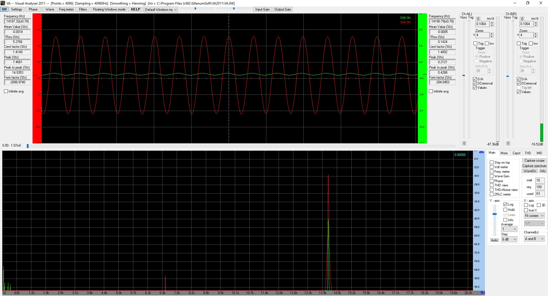

                      • Welcome back,
                        I did this: I desoldered C6 (it was 15nF) and put 2 capacitors 10nF + 4.7nF = 14.7nF in parallel there. I connected the TX and RX coils to dedicated ports. I connected the mV AC multimeter to ground and the IC101 / 7 pin. I turned on the power. I moved the coils to get the minimum value on the multimeter. Unfortunately, the lowest value that can be obtained is about 0.5V AC, which is still 100 times too much. I connected the osciloscope electrodes to Visual Analyzer, and to the TX and RX ports. I recorded the waveforms from both coils (attachment file). Unable to get flat RX wave. Do you have any idea what I could do now?
                        Greetings.

                        • Measure the RX residual voltage across the RX coil, before the preamp. This is true residual value of voltage.
                          It is not possible, I don't think, to get absolutely zero volts. There is always some small voltage even at deepest null.
                          But for tgsl, you are aiming for slightly offset from deepest null.
                          You want approximately 20 degrees phase difference between the tx waveform and RX waveform as your balance point. This is the point at which everything works correct in the circuit for ground balance trimmer and discrimination.
                          At 20 degrees you will have slight voltage on Rx coil greater than deepest null.
                          • Welcome back,
                            I did as you advised: I turned on the power, set the coils so that the voltage value between ground and IC101 / 7 was minimal. I was able to get 0.48V AC. I turned it off and on again. Without moving the coils, I re-measured the voltage between ground and IC101 / 7, I got a repeatable result, i.e. 0.48V AC. So the position of the coils is rather stable. Then I turned off, unhooked the multimeter electrodes and turned it on again. Then I measured the AC on the TX connector and got 6.16V AC, I measured the AC on the RX connector and got 5-11mV AC, not very stable but not higher than 11mV. My multimeter is APPA 305, so it shows frequency during these measurements. It is 14.14kHz on the TX connector and 0 on the RX connector. I assume that the voltage on RX is too small for the meter to pick up the frequency correctly, besides, I saw an oscillogram showing two sinus after subtracting the dc, so that doesn't bother me.
                            Are the AC voltage values ​​that I have read promising? What should I do now?
                            When you write about angles, I don't really understand what's going on, but I know it has to do with the TX and RX sinus waveforms. When they are not completely in phase, it means that they are moving away from each other by some angle (ahead or lagging behind) and that it depends on the independent frequencies TX and RX which differ by 1.6kHz. But I do not know exactly where or how to measure this angle, or how to regulate it. I think, that only by changing the frequency of the coils, which in turn is regulated roughly with capacitors, and more precisely with the final positioning and bending of the coils. Do I think right?
                            BDW I have already started the second TGSL PCB. I assumed that if I did something wrong on the first PCB, the second PCB would be comparative. I have already soldered the IC sockets and bridges. I read in the documentation that a few elements can be replaced, for example LM308 to TL071, and pnp transistors 2N2907 to BC557, npn 2N2222 to BC547. Are any other substitutions possible?
                            Greetings.
                            • The Phase is the time difference of when the peak (or Zero crossing) is of the RX relative to the TX wave forms.
                              14.5kHz has a period of 68.9micro-seconds.
                              20 degrees divided by 360 degrees = 0.055 of a rotation. Multiply by period equals 3.8 microsecond time difference between TX and RX.
                              Look at the TGSL 101.pdf again, Scope picture #4 on page 6. Top trace is TX, bottom trace is RX. Note that the RX peaks are slightly (20degree) after the TX peaks. Also note the scope vertical scale and then read the peak-peak voltage in the picture.
                              • Welcome back,
                                Thanks for the clarification, you're really good at this, really. I'm just learning and I can't judge my oscillogram like that, but I guess it's not bad. Besides, it is not a real oscilloscope, but a computer adapter. I can't expect her to work better.
                                But let me tell you something: with my PCB, I visited a friend who has an old Russian oscilloscope, still analog (I can't find what model it was on the network) and not fully functional (no electrodes and problems with switches). And when I connected the PCB to it, for the TX waveform it showed exactly the same sine wave distortion as in the Don Bowers documentation.
                                What do you think - can I already think about GB and discrimination at this stage?
