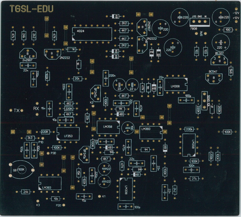

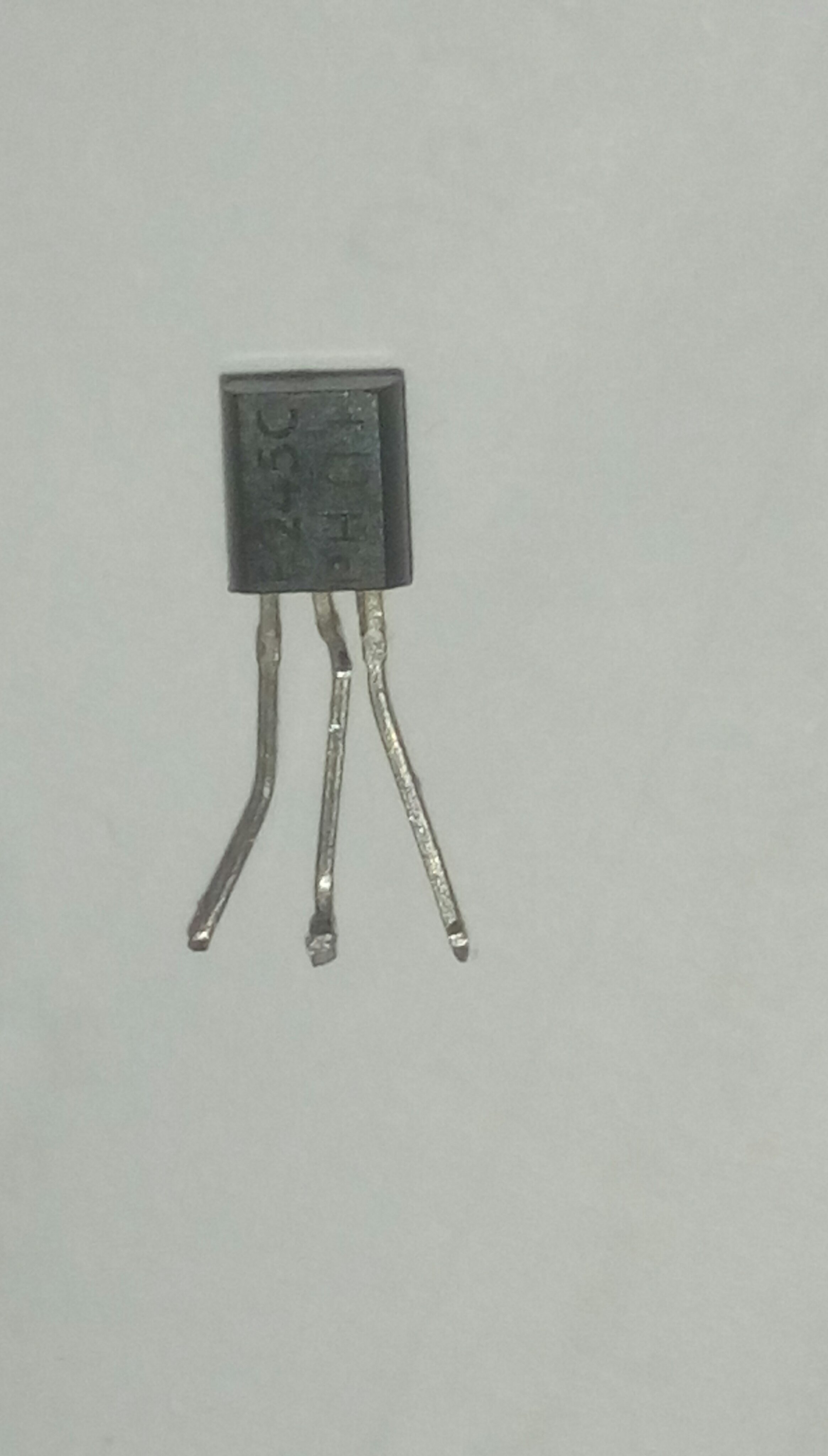

        How do I install this bf245c on this circuit? I do not trust the datasheet and it is very difficult to detect the gate, source and drain with a multimeter

          • SGD or GSD ?????????

              I would trust the data sheet and give it a try.
              DS shows pin order as GSD in the orientation of the JFET in your picture.
              Other way is to actively test. Look up "Testing N-ch JFET" on the web for how to do this.
                Okay! It is really difficult for an electronic engineer to have trouble recognizing MOSFET bases, I am a self-taught person !!
                But I already installed one of these bf245c in the original TGSL, so GSD is right !!
                Now I installed it in TGSL Edu like this, I think that's right !!
                Do you confirm this ???

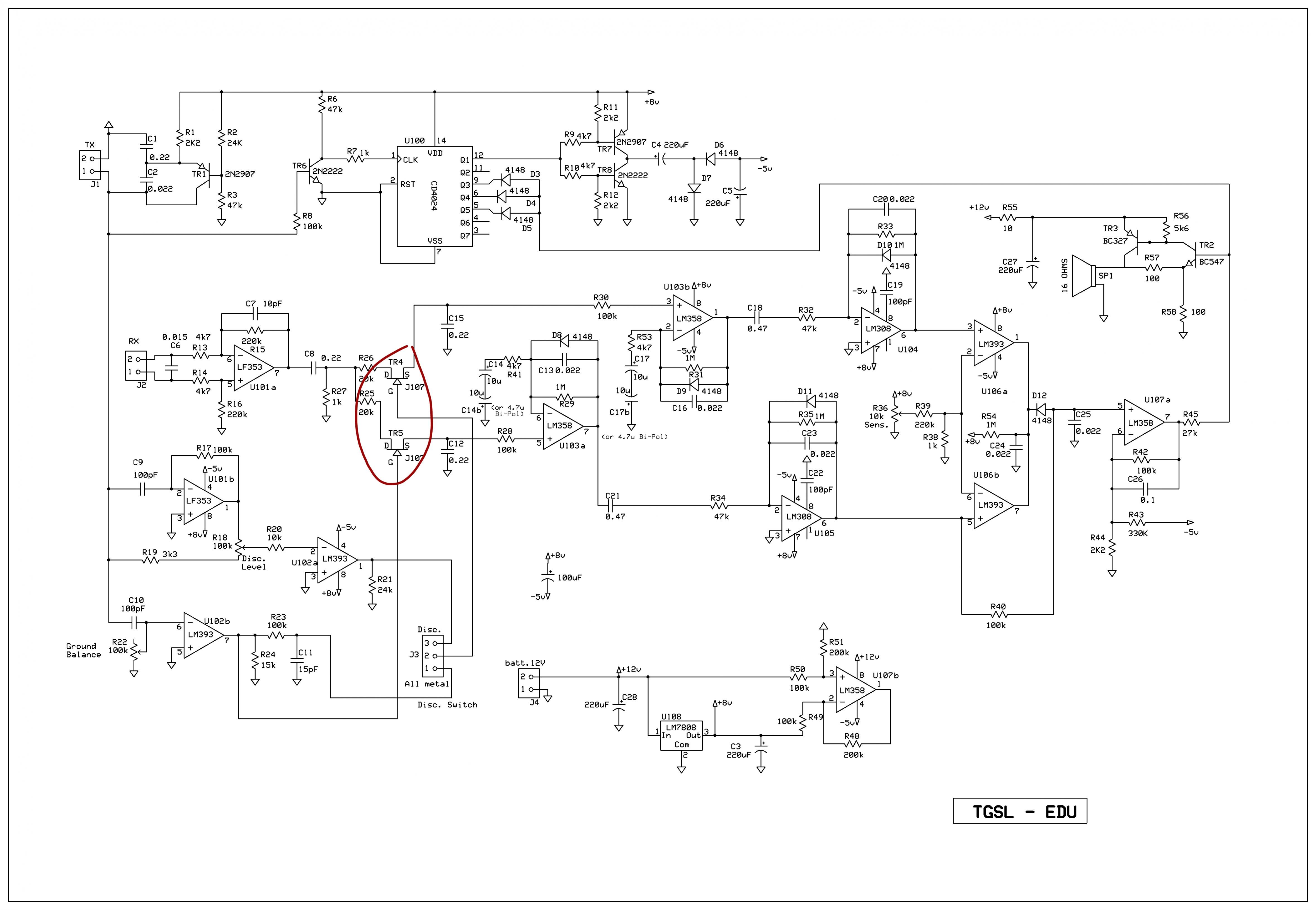

                    • If you now know that the pin order is GSD then the schematic of the TGSL will tell you how to install it.
                      • You should install BF245A or BF245B.
                        I install 2N4393.
