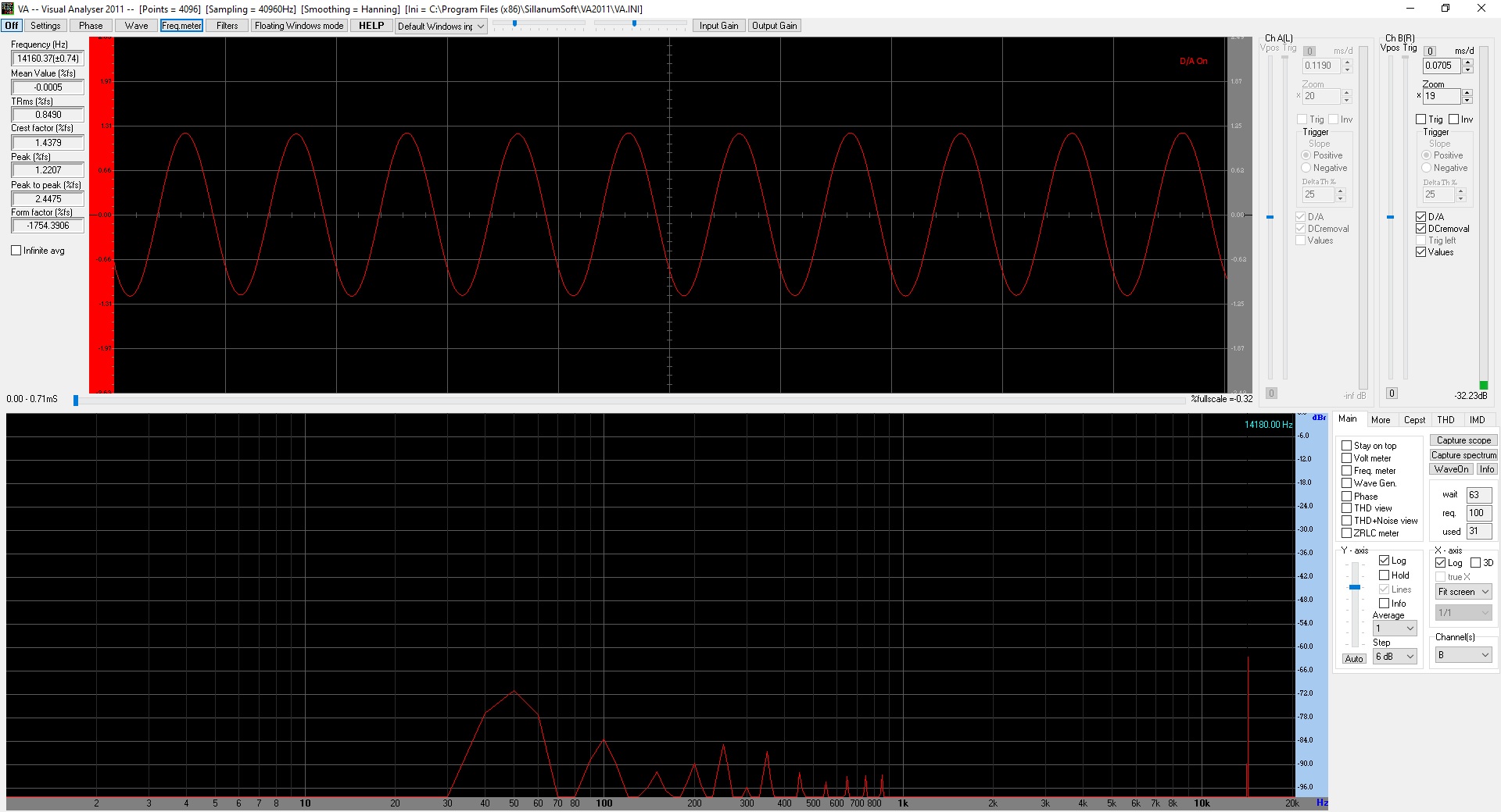

      The sound is present from the beginning of the construction. Reacts to any metal in All mode. I tried to test the discrimination when the coils were not yet well corrected with capacitors. It worked so that it was rejecting ferrite by then, and sometimes I thought it was rejecting other metals as well, or all of them. You know how it is: when you are not sure about the reaction, you imagine it, and the more you want to see it, the more you imagine it. But in such cases, I prefer to remain skeptical and not rely on my imagination.
      Looking at my waveform, the RX seems to be ahead of the TX, but I don't know if it's good or bad. Should it be ahead or delay? How is this done? How to cary about it?
      I plan to attempt GB tuning and discrimination this afternoon. I just preferred to make sure it made sense beforehand, because my previous attempts did not satisfy me.

        I have just tried to check how GB and discrimination work. And unfortunately there are problems again. At the beginning I switched to All mode. I set all the potentiometers to the middle of the scale. I found a position for the coils that gives the minimum AC voltage between ground and IC101 / 7. Today I was able to get 0.4V AC. Then I started turning the GB potentiometer until it rejects ferrite. The documentation says so. The position of the potentiometer at which the ferrite is rejected is basically at the beginning of the scale (left). When I turn the knob clockwise, the ferrite is still visible. Other metals too (copper, aluminum, steel) are visible. So I left the GB potentiometer at the beginning of the scale on the left. Detection may not be the best (15-20cm), but acceptable at this stage of construction. I switched to Diss mode. Detection has ended. Regardless of the position of the Diss and GB potentiometer and the sensitivity on the PCB, there is no detection. Everything is rejected, every metal. When I go back to All mode, every metal gives a signal again. When I go back to Diss mode, all metal disappears. There is no combination of potentiometers where some metal gives a signal. I'm worried. What could have happened? What should I check now?

            I checked all metal/discrimination switch: they are wired correctly.
            I did this: I finished the second PCB (PCB2). I applied changes to it:
            both 2N2907 → BC557
            both 2N2222 → BC547
            both LM308 → TL071
            I chose all capacitors and resistors so that they were as close to the measurement value as possible to the declared value. So that they should be equal to the description in the diagram, not just close. The differences from the declared one do not exceed 1%.
            I got the values ​​of the supply voltages + 8.0V and -5.5V. On PCB1 it was +8.0 and -7.0V.
            I tuned both coils to this board according to your directions, which is exactly as before, but I left 14.2kHz on TX (i.e. C1 = 220nF, C2 = 22nF, no correction capacitance) and I adjusted RX to 15.8kHz for a shift of 1.6 kHz (it required 220pF soldering parallel to C6, so now C6 '= 15nF + 0.22nF = 15.22nF).
            I connected both coils and tried to get the minimum AC voltage between IC101 / 7 and ground. About 0.38V AC was obtained. It is not possible to receive 5mV AC. I assume that with this minimum value, the voltage at the RX connectors is also minimal, I did not check it. I checked how detection works in the All mode. It works, maybe not great, rather weak, but it works.
            I switched to discrimination mode. PCB2 behaves almost exactly like PCB1. There is no possibility of obtaining discrimination.
            I went back to PCB1.
            I tried to set the required AC values ​​(as described above). With the minimum AC voltage value between IC101 / 7 and ground (about 0.45V AC) I recorded the waveform / oscillogram on the TR4 gate. File in attachment.

            • Check the legs of jfets for correct pinout.
              Which jfets are you using for tr4 and tr5?
              Oscillogram for gate of tr4 does not look right.
              You could remove centre wire from switch and take oscillogram of output of pin 1 of comparator 102a.
              Check your comparator circuits.
              You must have proper switching waveforms for the jfets.

                    • Yes, tr4 scope picture is not right. This is why it does not discriminate.
                      Refer to the TGSL 101.pdf for what the Gate of TR4 should look like.
