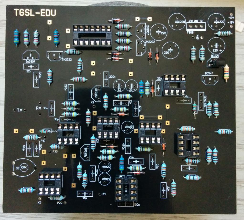

  • If you cannot find anything wrong with your PCB layout and components are good, then you must check for correct waveform on gate of tr4.
    Remove tr4 and tr5 from PCB. Or just desolder gate legs and lift them out of PCB.
    Put probe and see what waveforms are present on output legs of LM393.
    • You MUST see rectangular waveforms. There is no escape from this.
      Even opamp like a TL072 in this position should give rectangular waveforms. You can try. They have same pinout. So you can just stick one in.
        I think your problem is very simple. There is some error in the circuit of the lm393.
        I suggest re-evaluating the PCB layout and components around this area. Check every component.
        LM 393 getting hot is very bad sign. Now you describe continuous beep and overheating.

            I did this: I inserted the previously used LM393 into the IC102 socket. It turned out that the work of the plate returned to normal. Unfortunately, its "normal" is to work in All mode, and not in Diss mode. So it works like it did a few days ago, before I didn't put different LM393s from different manufacturers into the PCB. I don't think anything else has burned. As far as I know, the FETs (BF245c) are quite resistant to being burned by the gate, because the FET junction is mainly controlled by voltage, not current (similar to MOSFET). On the other hand, before the IC102, there is probably nothing that could burn, except the LF353. But if the All mode works then the LF353 doesn't seem to burn out. Do I deduce well? I hope so.
            Additionally, I just understood something else:
            1. My waveforms are incorrect. I use a computer adapter (simple resistance bridges diode protection through the sound card, and Visual Analyser software), so the maximum sampling will be as described in the specification of this external sound card. Most often it is 48kHz or less. And it does not depend on the program, but on the hardware capabilities of the sound card. This means that describing the full period of the frequency wave around 14.5kHz takes only 3 points. This is definitely not enough in my opinion. The program that supports the input of the sound card (VA, or other) creates then not a real waveform, but a joyful, wonderful interpolation of what it sees on these three points, which is usually a sine, because that is the easiest way to interpolate. Even if there is a rectangle at the entrance. Such adapter is suitable for impulse detectors, because they work below 1kHz (but carefully anyway, because impulse detectors generate a sharp signal of several dozen volts or even more). Then I have to buy a real oscilloscope. These are rather expensive devices. I do not want to buy a used one, because there can be problems with that, and I know too little about the subject for me to recognize failures of the used apparatus. Hantek 6022B will hold my pocket. What do you think about such an oscilloscope? If I don't burn it (unfortunately, with my talents, it's possible) then it should be good, right? It is dual-channel up to 20MHz, which means that the entire period of the ~ 14.5kHz waveform will be very densely sampled.
            2. I read in the Hantek 6022B specification that it supports a 0-5V measurement range. If so, can I use it to test the TGSL PCB? Will I have to do any additional protection for the oscilloscope input? Resistance bridges?
            3. I don't need to desolder T4, because in my PCB its gate goes through a three-position switch (Left, 0, Right). Just set it to 0 and connect the oscilloscope electrodes to L or R, then I will see the T4 input waveform in Diss or All mode when T4 is off. But it only makes sense when I buy this real oscilloscope.
            4. The waveform on the T5 gate should be very similar to the waveform of the output from IC102b (7), a bit higher of course, but consistent in phase and amplitude, do I think right? But that also has to wait for the real oscilloscope.
            5. I have a TL072 at home, and even a TL082 here, but I don't think I should have connected them without an oscilloscope. I suspect so, am I right?
            6. All my LM393 are tested and rejected, but maybe I could find the LM386 here, would that also be suitable?
            7. Do you know any safe way to record waveforms on IC pins without removing them from the socket? Any needles? Any sharp nails?
            Thank you very much for your help and commitment. Without your help, I would have stood still.

            • All that is left is U101b. You are right about VA, it is limited. But if you deselect D/A you might be able to discern some kind of waveform at the output of comparator. All you really want to know is that it is spitting out something.
              Do you have suspicion on 353 chip?(101b)?

                • Little can go wrong with the circuit from tx to gates of switchers.
                  How about dropping the frequency to around 5khz. At this lower frequency, VA will work fine. You will be able to render the waveforms at the switches gates through the soundcard?
                  If a 100n cap is put across the tx coil.
                  All you want is to confirm that the phase shifters are working.

                    I look at the diagram and see that you are right. All mode signal bypasses U101b, only goes through U102b. Diss mode signal goes through U101b and U102a, could that be the cause of my trouble? I think so. These are obvious things to you, but I don't know how to read diagrams yet. Thank you for your attention, it prompted me to re-examine the pattern.
                    I think I will have to buy some better IC somewhere (LM393 and LF353).
                    I am not going to lower the frequency for now, but I understand what this could do and how 100n could do that. I could probably replace the C1 and C2 pair with a larger capacity and that would lower the TX frequency. That would not do the trick, as I would probably have to lower the RX frequency similarly to read it reasonably. And I know this would only be done temporarily, just for checking U101 and U102. But for now I'll hold on to it, we'll see what happens when this Hantek arrives.
                    I understand your initiative and I am grateful for it, because it helps me, but I am not able to do everything without thinking, I have to be patient, this is what the lesson requires. I am not as fast or as proficient in electronics as the specialists here. I'm just learning. I've already learned a lot from you guys.
                    Do you have any way to get these safe IC measurements in the socket? Or maybe you know some tricks in choosing real / genuine ICs? 'Cause I'm not good at it.

                    • I don't quite understand what you ask about taking measurements in the socket.
                      Oscilloscope probes have clip on extension which are designed to make love to the legs of components.
                      These are probably going to be provided as part of your Hantek.
                      • If I wish to probe pin 7 on chip, than I can clip scope probe to leg of resistor connected to pin 7 for example.
                        At least for short distance from the IC is going to be ok.
                        There are specific probes which I know can stand upright like crab claws and stay in position. Those are quite nice. I believe they are called " goose neck" probes. Mainly good for SMD boards where there is few places to clip. Especially probing flatpack pins.
                        Most times there is bound to be a place where the probe can be clipped on a through hole PCB without problem.
                        • hi friend,
                          show me how disc/allmetal part connected in this picture???Click image for larger version

                            My point was that all of my ICs are set in the sockets, and these sockets restrict access to the legs of the IC. I will have to try as you tell me - look for the elements to which they lead and try to connect with the probe there. My Hantek will come with these connections / hooks, but even with them it might not be easy. Fortunately, I scaled the entire board before etching the PCB, so I now have a bit more space between the components.
                            Today I additionally ordered BF245c, LM393 and LF353 from another source / seller. Maybe now I will find the original ones. Unfortunately, we have serious problems with original parts, many sellers are scammers. I think that on Monday or Tuesday I will be able to start another measurements, maybe I can finish the project. I would love to.

                            • Originally posted by mostafalesnar91 View Post
                              hi friend,
                              show me how disc/allmetal part connected in this picture???[ATTACH]56787[/ATTACH]
                              I think these are the items labeled K1 (All), K2 (0, JFET gate) and K3 (Diss).
                              • Originally posted by Majster View Post
                                thanks my friend!
