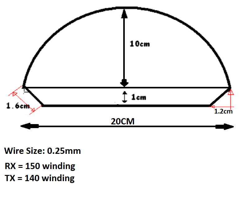

                  • I need help anyone Can Make Coil Count
                    I Have Make this Coil And Being
                    Nice Detection Coil
                    But I Do not Know About This Coil Count
                    coil inductance?
                    how many kHz?
                    If There Are More Recommendations
                    From All Off GeoTech Members Can Share Here!
                    This Coil Made From SOme One On This Forum

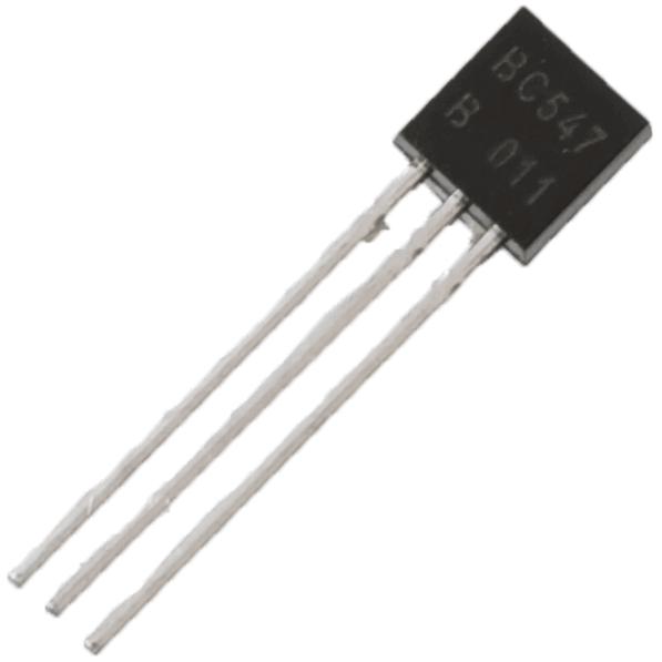

                    • Now What Is This Problem Any One Can Help Me!
                      • The most common fault for the symptoms your getting is the pinout connections on the fets, different manufactures = different pin out connections, most of us have been there many moons ago.
                        Nice job, very similar to my first build.
                        • This Is A Video Before Damage Happens
                          now i get error that's only just long beep
                          what is the pin out i need to change
                          MY TGSl tone is not working just silent no sound
                          so i have try change coil but still same just long beep and silent
                          then i pull out the battery then put it back why, i get sound same long beep again
                          what is the problem bro
                          Before That Error I Have Change BC547 cause the original BC547 From silverdog kit is broken
                          so i change Same BC547
                            From Silverdog Transistor BC547 b011 Like on this picture
                            But From My Country BC547 b113 is that different
