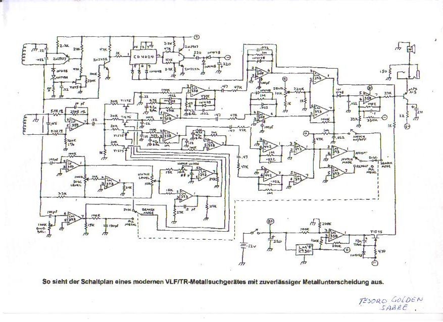

                          • The schematic in the PDF TGSL_101 _PART1.pdf seems not quite correct, the output of U107b goes nowhere so it serves no purpose. Just curious. Compare it to the schematic in this post concerning the area mentioned. While it would add more wires to the cable between the search head and the control box I can see the improvement putting blocks 1,4 and 9 in the search head (coil assembly). Obviously block 9 because it is part of a dual IC in block 4. Block numbers being named in the PDF mentioned.
                            Also in answer to a question here the capacitors C1,2 and 6 should be at the coils in the search head for maximum TX and RX signal. This would aid operation in more than one way. Increasing the Q of the LC (+R) in both not only narrows the BW of the signal it also increases the resonant rise in the RX signal improving sensitivity and depth, as well as increasing the strength of the TX signal. As an added bonus the S/N ratio will improve for the processing circuitry, giving greater noise immunity overall. I have read much talk on shielding but no consideration to eddy currents set up which would reduce depth by interfering with the field of the TX coil. It appears most shield the entire coil assembly yet the TX coil is not the one needing it. By not shielding the TX coil an increase in radiated field would be seen increasing detection depth since eddy currents in the shield will not be interfering with the TX field strength.
                            To me shielding only the RX coil while considering the type of metal used as well as it's thickness is a good place for improvement. So is picking a metal very slightly diamagnetic such as silver foil for the RX coil shield. However expense likely rules this out. Pb is toxic, Be both toxic and too hard, Bi and Cu are too diamagnetic, Ag too expensive, so I would have to say Zn foil is just right. Cheap and not too diamagnetic, given a thin foil which is just enough to shield noise but not interfere with alternating magnetic fields at 15 KHZ. Has anyone tried these ideas?
                            • Hi
                              I been mounting the TX/RX caps in the head end for the quite sometime, the reason been so its possible to make multiple coils to fit the TGSL.
                              Far as performance in real terms ie ground tests not noticed any difference.
                              I tryed just screening RX in the early days of this project with various metals like mylar,kitchen foil even lead and copper, not sucessful in the UK as screening both RX/TX coils.
                              Theres a interreaction between both TX/RX which seems to pick the crap up from the TX coil but to date cant answer the reason why and im not sure anyone else can, but it is there and its a pain the *** because im sure depth is lost due to the TX screening.
                              The TGSL 101 posted does work ok built from the earlier postings together with various mods to improve performance.
