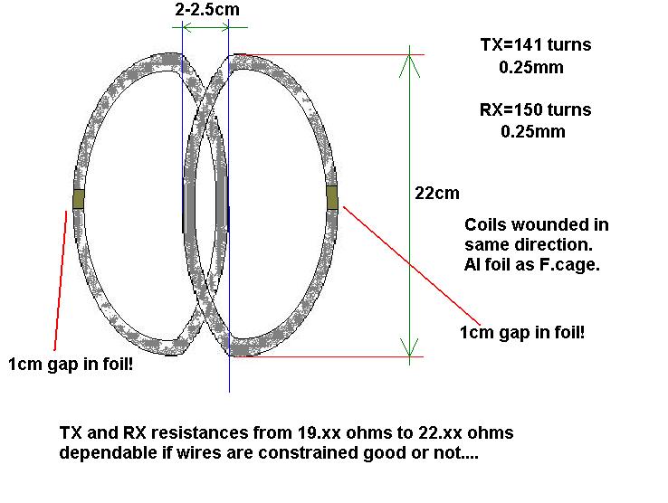

    Not as solution, as diagnostic. I want to know how high the movement signal is. So turn sensitivity to make less sensitive, does movement signal stop at some point, where?
    From his other posts it seems he/she has a super-sensitive detector, 40 cm???
    I agree sounds like mechanical. I would like to see photos - is his cable free to swing? Any suspicious construction? Too late I'm sure to see coil, but what kind of shielding? Is shielding loose? Is coil housing flexible?
    What happens if put detector on table (no movement), and wave hands near coil? Wave hands near control box?
    What kind of motion makes signal? Side-to-side? Up and down? Slow, fast?
    Where is he/she testing? Outside? Inside? Near power cords?
    -SB

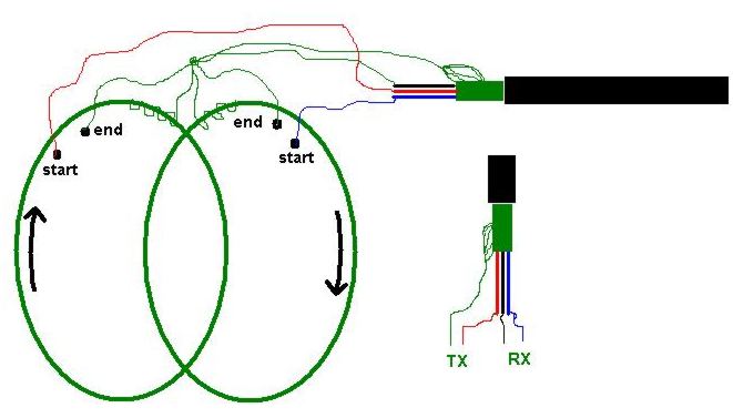

      Max by the way when i read your responce to Simon about his drwing
      10minutes laughing
      thanks all
      OK - from your description it is probably one of two things:
      1. As Ivconic says, make sure you're using the right type of screened cable to connect the coil to the control box. Certain types can become microphonic, and produce noise when moved.
      2. It sounds from your description of nulling the coil, that you have not understood the importance of getting the correct initial phase-shift between TX and RX. My suspicion is that this is most likely the problem. If you set up the coil correctly, and the noise is still there, then try the other suggestions that have already been provided.
      • Yes; presuming coil was balanced properly, than only cable left to be suspected. If coil was balanced well and cable is the right one....than only wirements left.
        Wirements at TGS is a bit tricky. You can wire it up on few different ways, but only one guarantee good stabillity and no falses.
        In search head both cages and both coils ends are wired togather and further connected to cable shield, but also another isolated wire is wired to cable shield in coil. "Hot" ends of both coils are wired separatelly.So... you will have 3 separatelly isolated wires and cable shield arround them. That is situation in search head. On other end - pcb (through connectors) you will connect cable shield to pcb gnd and TX "hot" wire to TX output. Also RX "hot" wire and that separated wire (connected to shield in search head but separated in cable) to RX inputs. Do not make any connection between RX inputs and gnd on pcb! So...RX "gnd" is connected ONLY in search head to common search head gnd (both AL cages and both ends on cable shield + one separated cable wire)....
        Sheeeshh...to much confusing here!!!
        That's why is better to search back pages for sketch i posted. One picture can replace 1000 words!
        In the past, during all those experiments with coil and cable wirements i tested almost all possiblle combinations and few different types of cable.
        Some of those do work, but only this method i just explained, provide excellent stabillity and absolute immunity.
        Undesrtand...?

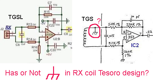

        • Are these pictures you mean Ivconic?
          (Grounding of RX lead through coil shields is curious.)
          Can you confirm which of the RX inputs is the "grounded" wire? The one to the op amp inverting (-) or non-inverting (+) input?
          -SB
            -SB
            Hi Simon,
            It's the inverting input of the preamp opamp that is connected to the screen. Some back-engineered Tesoro schematics show a ground connection in the receive circuit (as in your post) but this is incorrect. The connection to ground (0V, screen) is actually made in the search head.
            Ivconic's diagram shows the correct wiring for the coil.
              Hi Simon,
              yes, clear, that's my experience too: the gnd is due to coil internal connection not as reported at schematic level in wrong diagrams.
              Ivconic's one is right; if someone use e.g. double gnd connection (at pcb level and at coil too) it will generate a gnd loop... with increase of noise impact due to the current that will flow in that closed loop in the cable.
              That will strongly affect circuit performances cause of noise signal flowing there and thus propagation of it to other parts of circuit, cause of the very high amplification factors in the chain.
              Then , also, the cable will show more sensitive to microphonic also, like you described, so will expose user to false signals at every, even small, vibration.
              Kind regards,
              Max
                Kind regards,
                Max
                Thanks all for clarifying.
                That ground in coil head is hard to understand theoretically, but if it works, it works. You would think at first it would ruin the "differential" effect of the RX leads and create more differential noise. Also, you would think it would create a large ground loop if you follow ground from oscillator to RX input. But if it works....
                -SB
